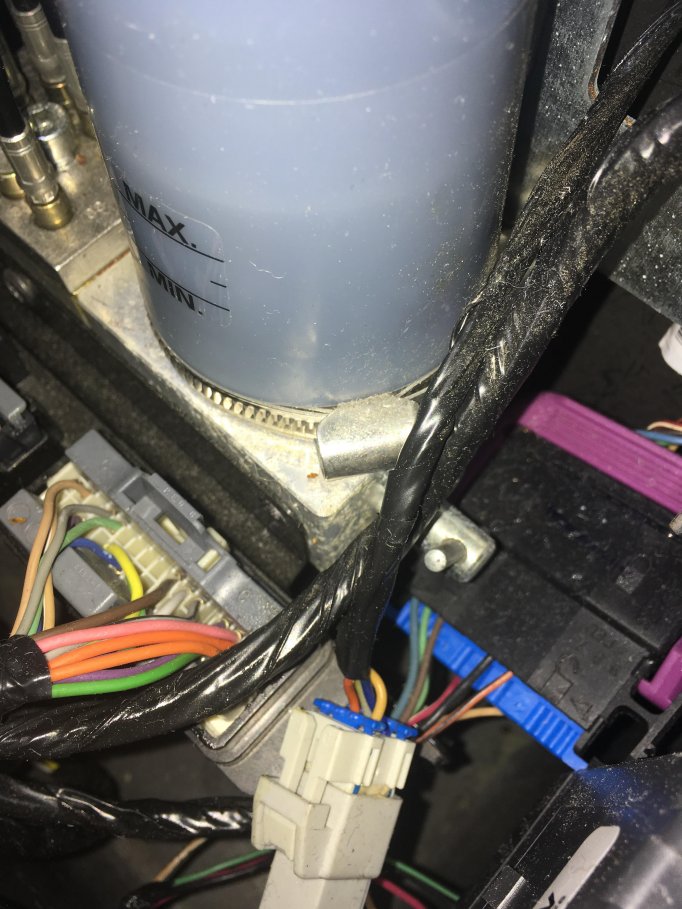

I have had my XLR-V for 2 months now. The Convertible top worked perfectly well until a few days ago. I noticed the trunk would open a lot slower than usual, as well as everything related to retracting the hardtop. After this happened 2 times, the top simply struggled to open, as well as the trunk. On the third time, there simply wasn't enough "energy" left for the top to go up. I was able to close it the next day by using my foot to hold the convertible top button, while simultaneously assisting the trunk and top each step of the way. From what I could gather from this forum, there could potentially be a leak in my hydraulic system. When I checked the fluid level in the trunk, it was actually overfilled a little bit. Is a little over filled an issue? Is it causing my issue? What can potentially happen when this type of fluid is overfilled? More importantly, what do I do next? Help! Thanks people.

There are two, smaller pneumatic "assist" cylinders forward of the two hydraulic lift cylinders on the sides, covered for the most part by the rat fur trunk liner. When either one (or both) of these fail, the hydraulic system struggles to lift the rear deck lid. You can replace these yourself if you aren't all thumbs.
If you have to assist the trunk lid to open, this is a good starting point. If the other components of the top are operating, the pump is probably fine; if they aren't, (suspected low hydraulic pressure) there's either a leak, (doubtful --since your hydraulic fluid level is isn't low) or a failing pump.
There's a "max" fluid level for a reason, but if it's been working thus far without a problem, I don't think it's a big seal. If the fluid level suddenly goes low, that's a problem. Being a closed system, the hydraulic oil has to go someplace, and it's never good.
