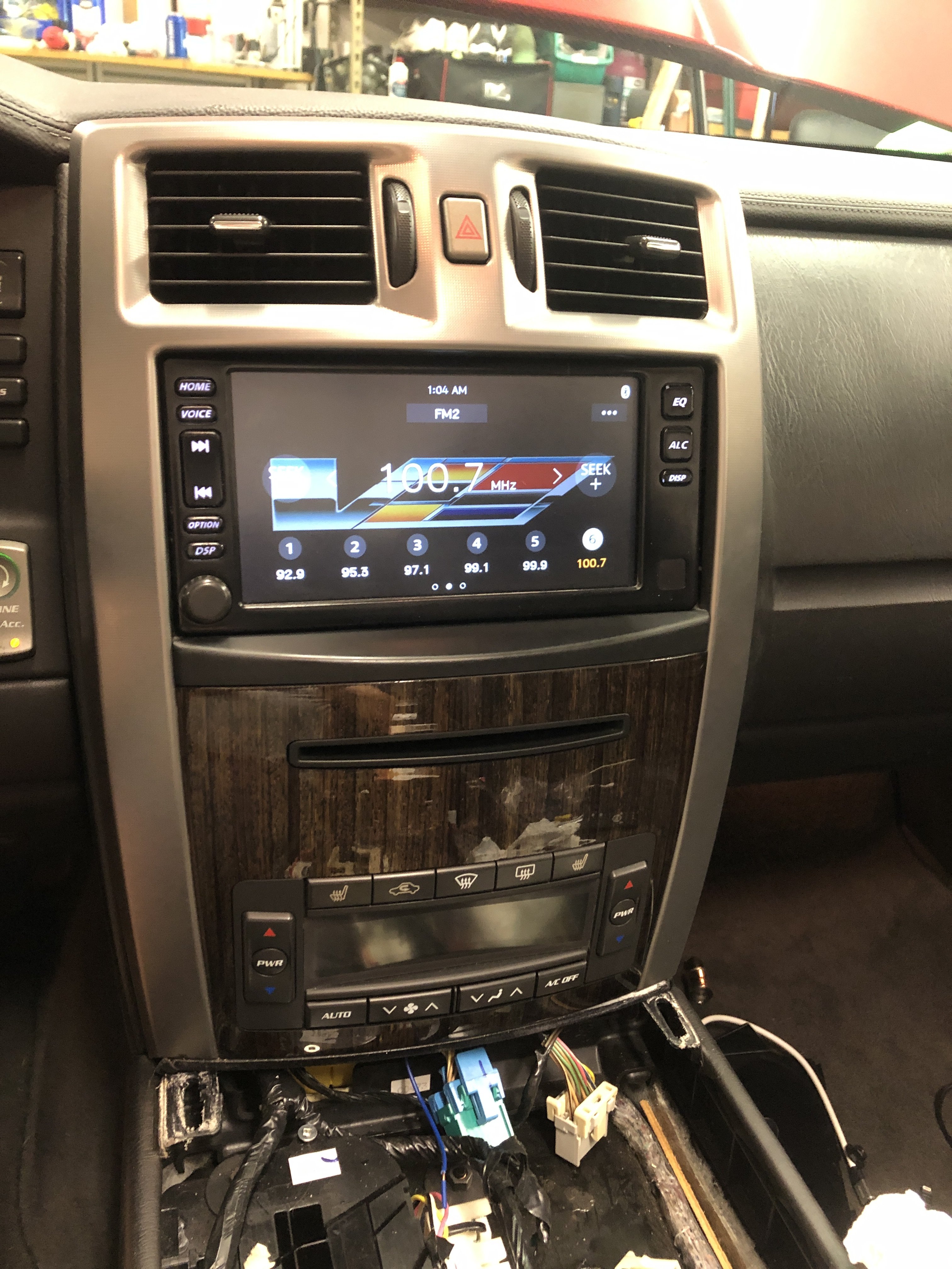

So, progress. I’ve designed a custom bezel and some circuits to adapt a new Sony head unit to the space while retaining the factory amp, eqs,disc changer and factory microphone. This is as far as I can go because the Sony model isn’t shipping yet so some dimensions are based on old versions. Here’s a rendering of the actual 3D part I’ll print, photoshops into my car.
comments welcomed, haters need not reply.

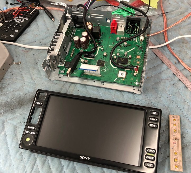

I finally got the radio (Sony AXV-AX7000) and chopped it apart. I made a faceplate and most of the buttons, but there will be at least one more set because there are various issues with these. The software is probably 75% done as is the electronic hardware design and prototype.
Here's a teaser.

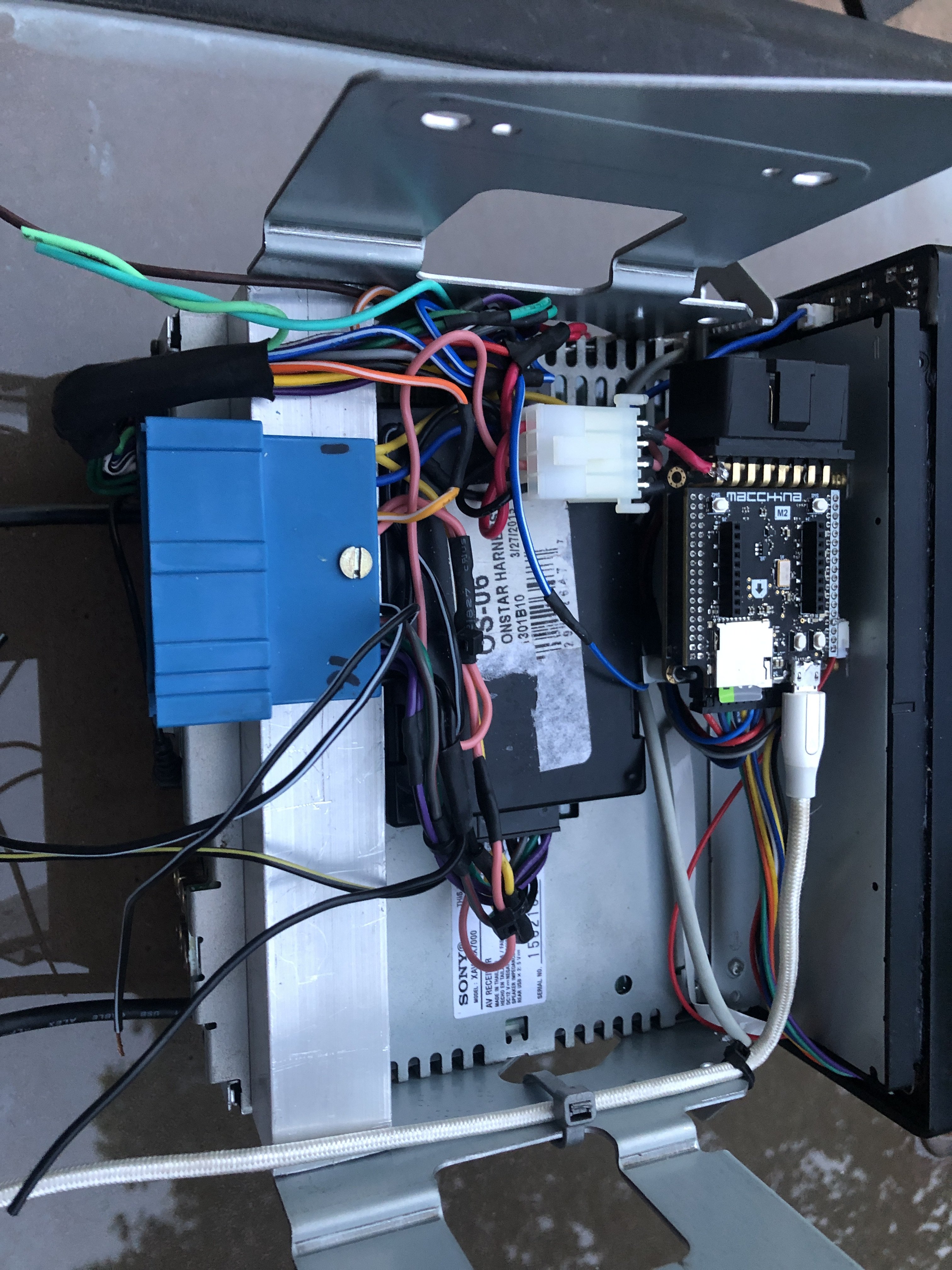

Two and a half years later and I’m finally finishing up. Here’s the latest teaser of the first fitting and getting all the custom circuits mounted. Hopefully, it will be done by Thursday for the Allanté XLR Invitational Owners Meet. The software, however, will never be fully “done.”
