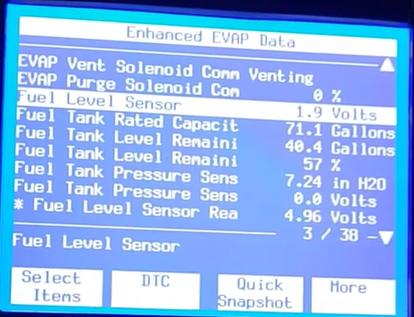

Does this look like the screen (taken from a youtube video for another vehicle) I should navigate to once my Tech 2 arrives in order to get an idea of what's going on with the fuel system? Or is there other diagnostic info I should navigate to?
That looks right but there are many screens with some of the same information, on our cars there will be two level sensors, left and right. On my 07 XLR V when a tank is full it will read about .72 volts and the volts will go up as the tank gets lower, empty is about 2.45 volts. The brain on board will take both readings and calculate the fuel level you see on the dash.

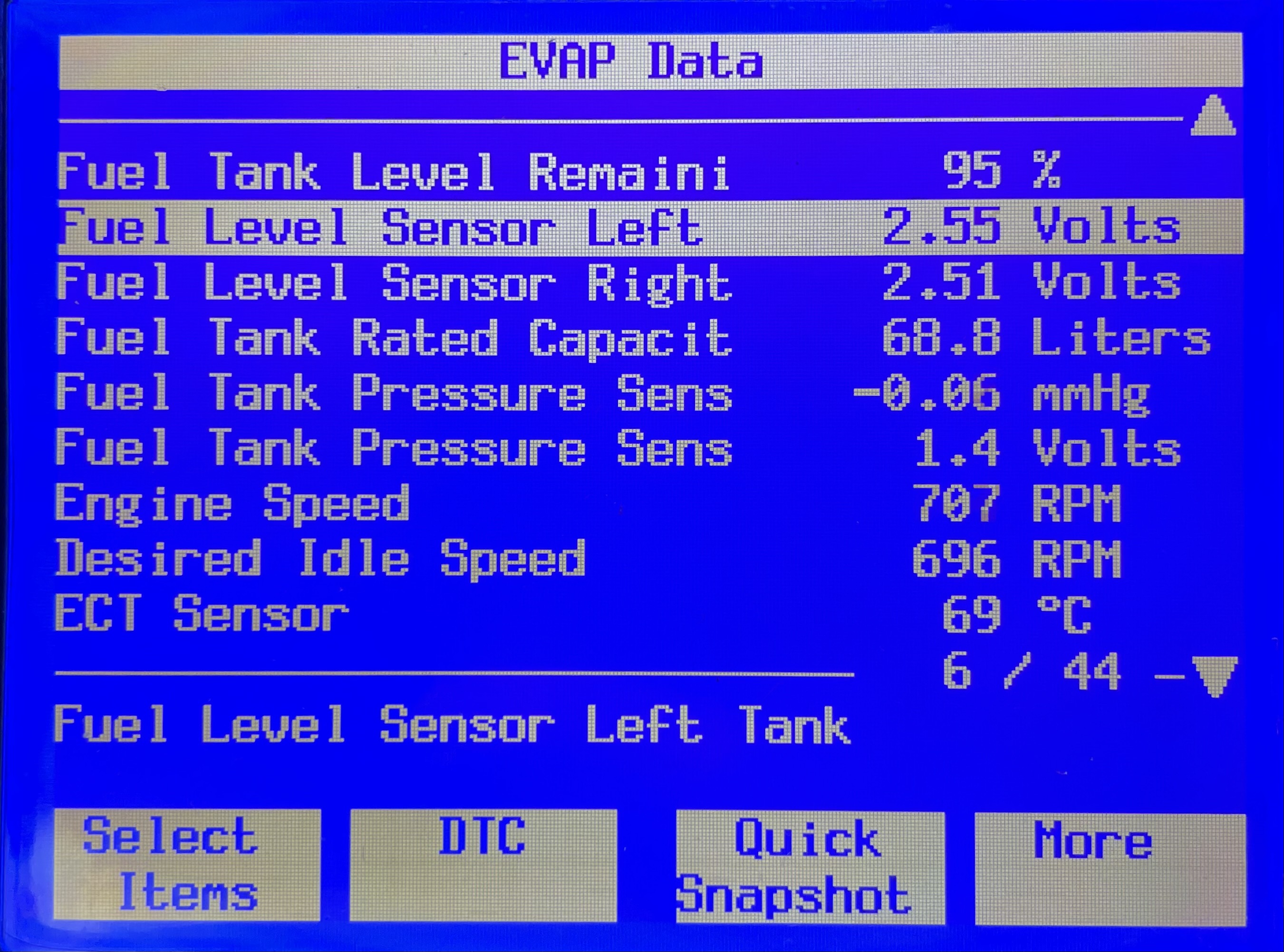

My clone Tech 2 arrived over the weekend and so far it seems to be functioning well. I found it pretty funny just how large this 25 year-old technology is... anyways, below is the reading I have on the fuel sending units. As you can see both seem to be reading correctly at nearly full fuel levels. I'll continue to to monitor my readings... maybe I was just hallucinating this issue... or maybe its intermittent... time will tell.
For some reason my tank level voltages are just the opposite, full is the lower number. Everything I have read says it should be as yours are but it's working so "if it ain't broke don't fix it".
I think you will like the Tech2, there is a lot to learn and so much information but for a car guy it's big fun.
Maybe the wires are reversed on your sending units?
