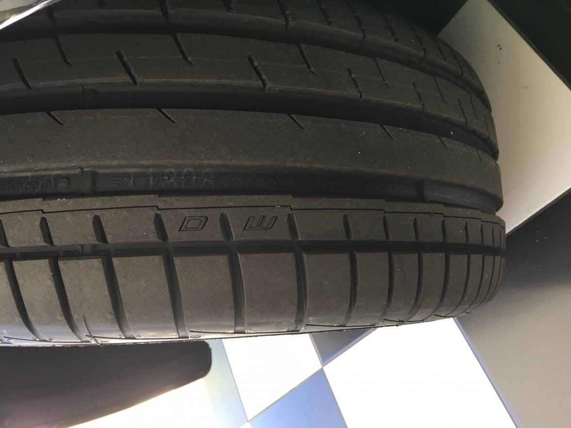

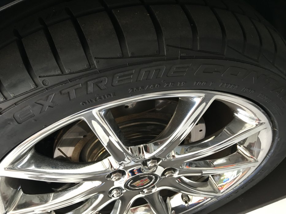

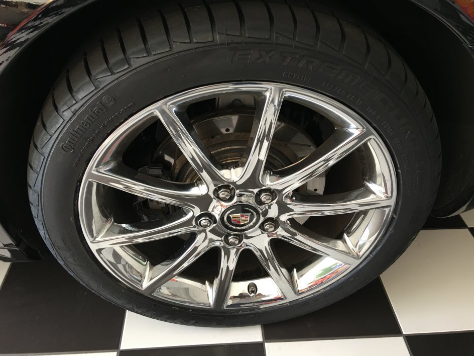

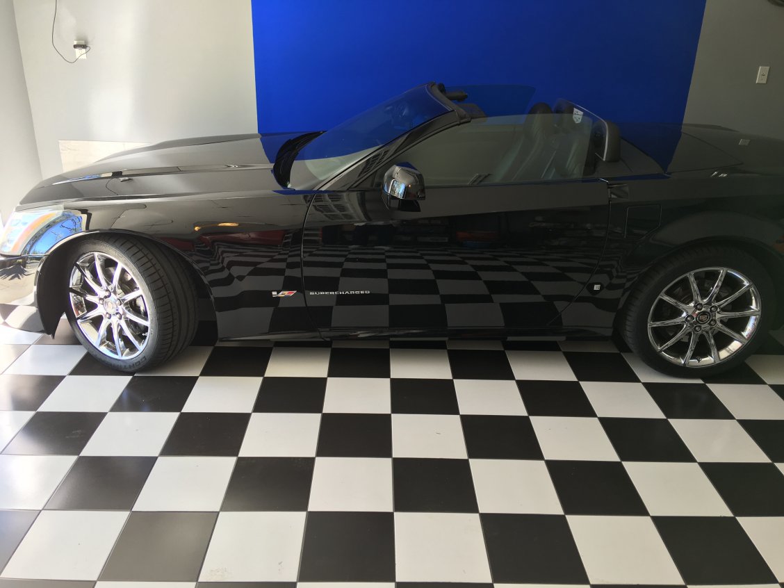

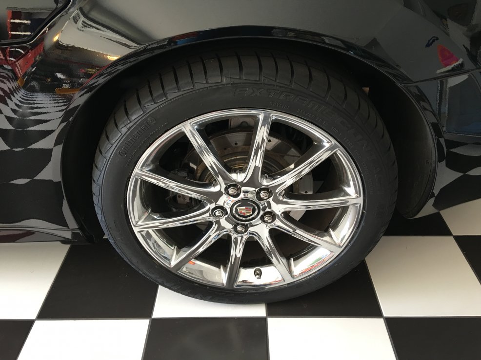

So finally, after much back and forth nail biting and teeth gnashing, I pulled the trigger over at Tire Rack and purchased 4 Continental Extreme Contact DW's and had my guys over at Firestone Auto Center mount them. Oh my goodness what a world of difference over the Pirelli Eufori's that were on the car when I got it. I did follow the guidance of others in this forum who went with the 255/40R19 all the way around. All I can say is WOW. The ride is amazing. It's like a different car altogether. I wish I had done it a year ago. :D
I appreciate your input & update. The more I hear about the profound improvement on the ride the non run-flats provide, the more I weaken on maintaining my set of Pirelli Eufori's. But, I have $1200 invested in them, so it's a tough decision. BTW, what are you using in lieu of a spare or do-nut in case of a flat?
Cadzilla,
P.S. I enjoyed the pics of your gorgeous black raven 'V'. My previous XLR (base) was black. Mighty fine.
