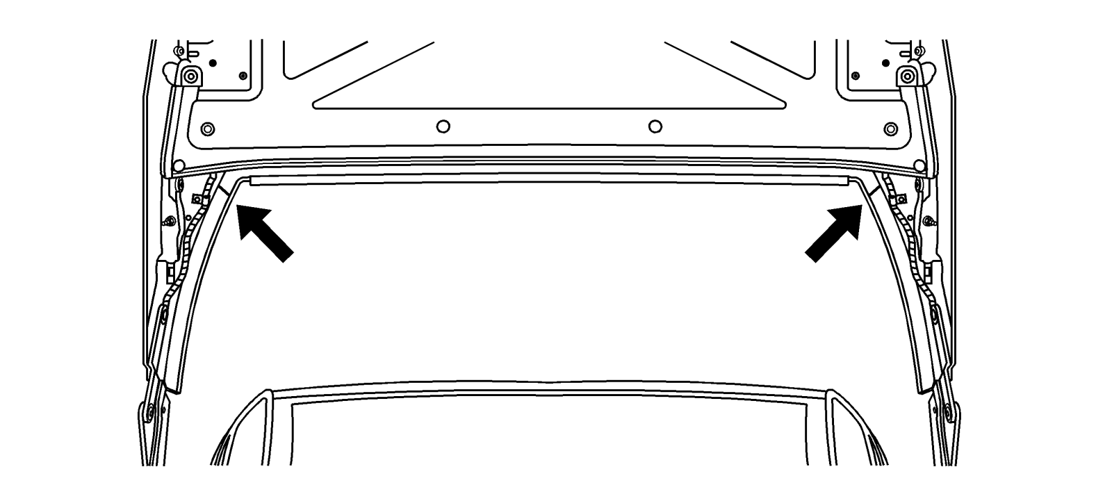

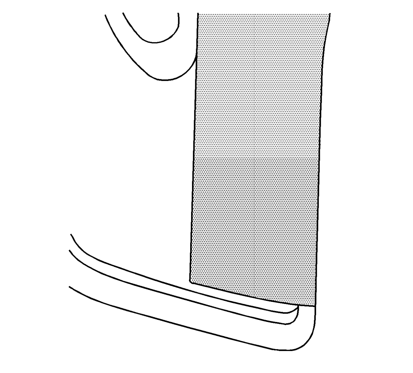

1. Clean the shaded area shown in the first illustration above. Apply a small amount of weatherstrip adhesive to the center of the two bond joints. Refer to the second illustration above.

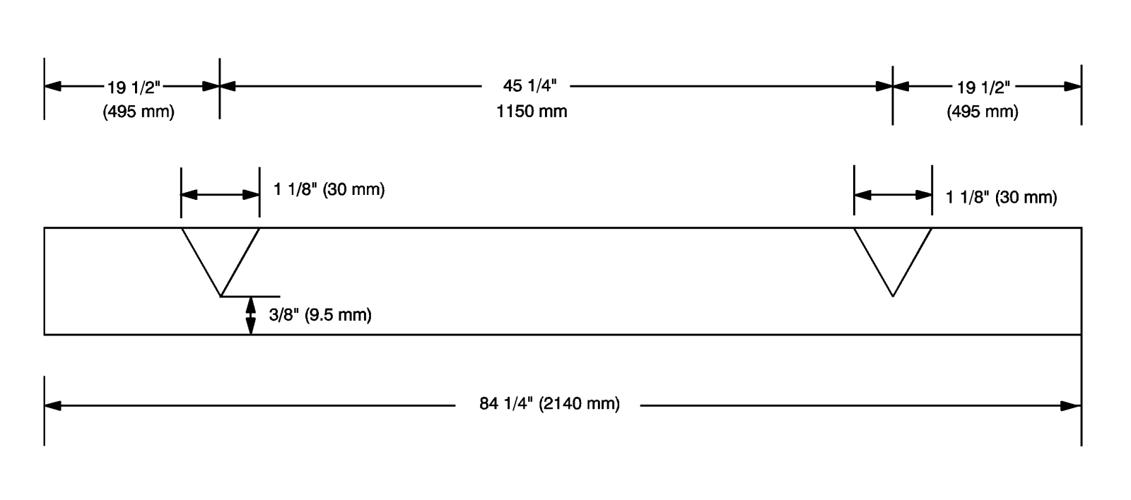

2. Cut the Kent Automotive Adhesive Shim Stock, P/N 46475, to the dimensions shown in the illustration.

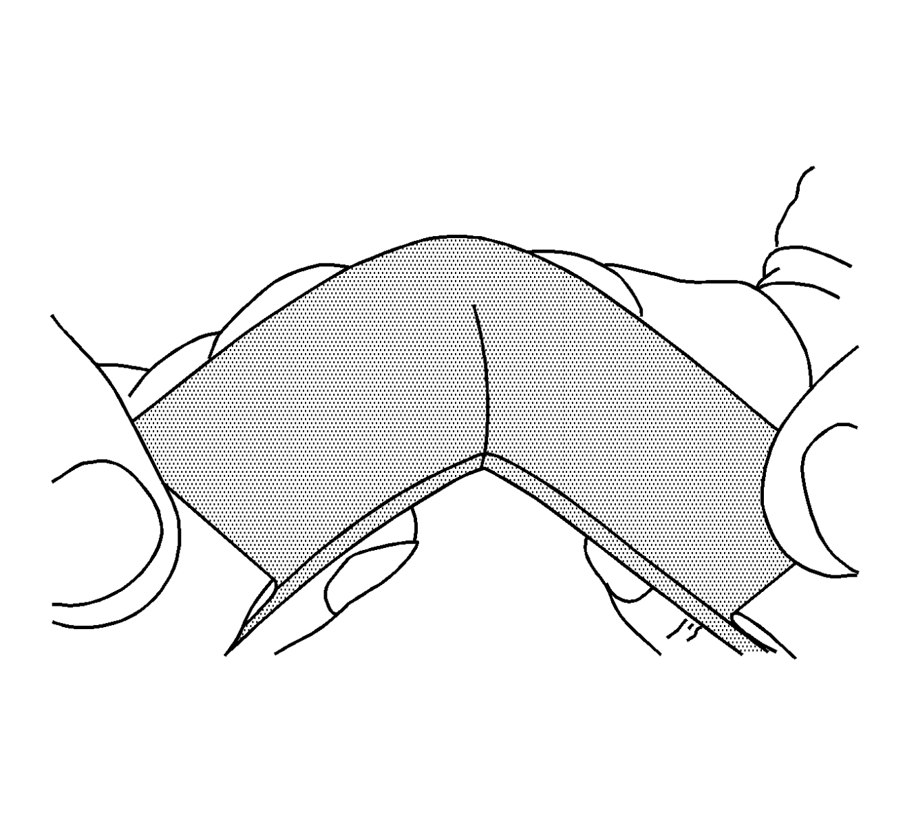

3. Pull back the adhesive paper protector near the notches and bond the notch together with weatherstrip adhesive

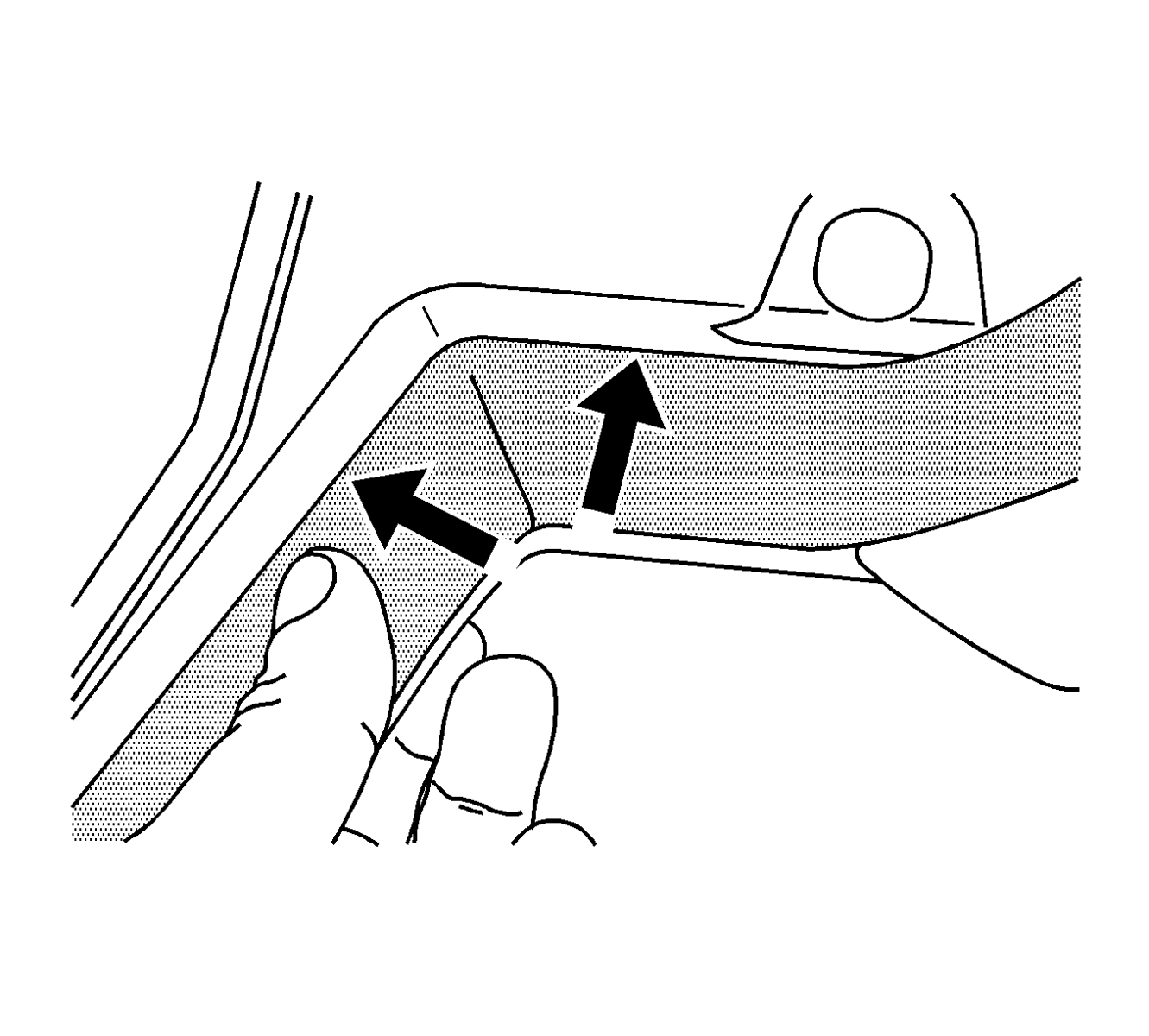

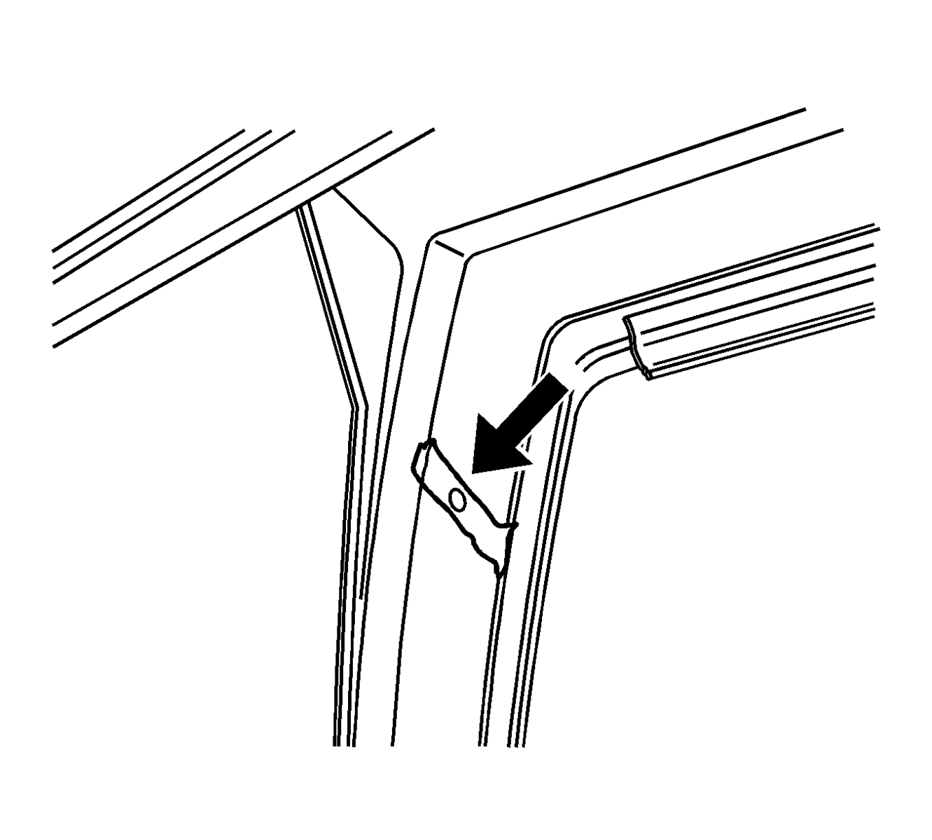

4. Insert the foam at each corner. Be sure to place it against the deck lid inner, following the ridge.
- 5. Use a pair of scissors to trim off excess foam to the edge of the deck lid inner.
