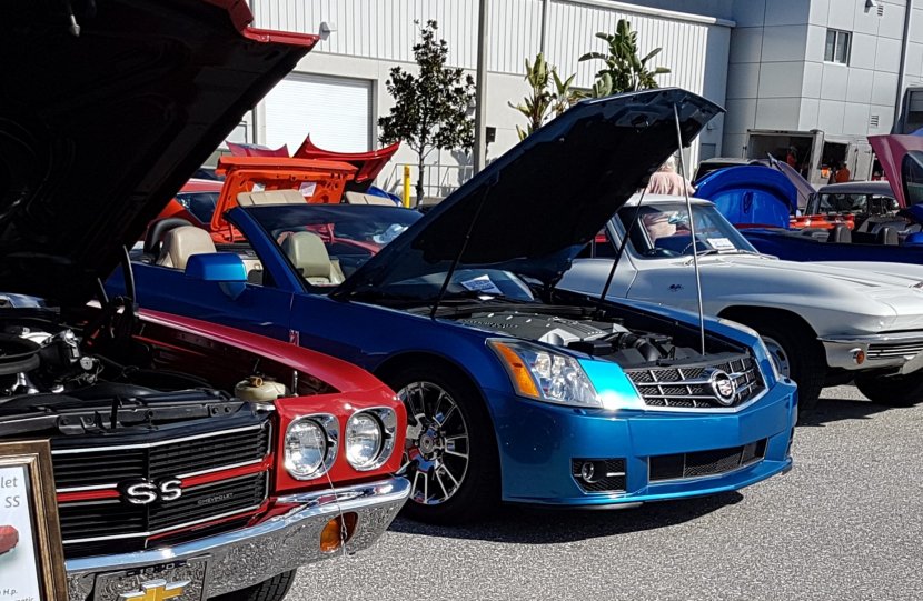

Anyways, 'soundhd', good luck with your search and heed our 'tire' advice. BTW: What are you looking for? There was a beautiful 09 here at a car show in Punta Gorda two weeks ago for sale. I did not pay enough attention to it as the owners were not at the car at the time and I never ventured back to chat with them. I believe they were asking 40 grand which is a fair price for an 09 but don't remember the miles but I also dont remember it being a crazy high miler, it is a real nice car.. The 09's are the only ones that had visible changes to the exterior that you can tell an 09 from all the other years: all 09's (reg and V modlsl) also have the V style hood as well as the other styling cues I am talking about. If you are unaware of the differences let me know and I will post some comparison photo things I made up years back!
Here is the only photo I took of the Blue 09 I am speaking of. I could do some asking around if this car would be of interest to you: likely the caddy dealer would know the owner.
