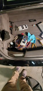

That's OK Dennis....I just figured it out. I had a burnt suspension control module, it got wet and had blown a hole in the corner of the circuit board. This is on my 2004, and I refuse to be taken advantage of with a $2000 USED module of same year for the XLR. I finally figured out that the 2004 XLR is EXACTLY the same as the 2006 Corvette suspension module (right down to the wire colors).

Everything works again and it was only $200 for the module and teh wiring.
