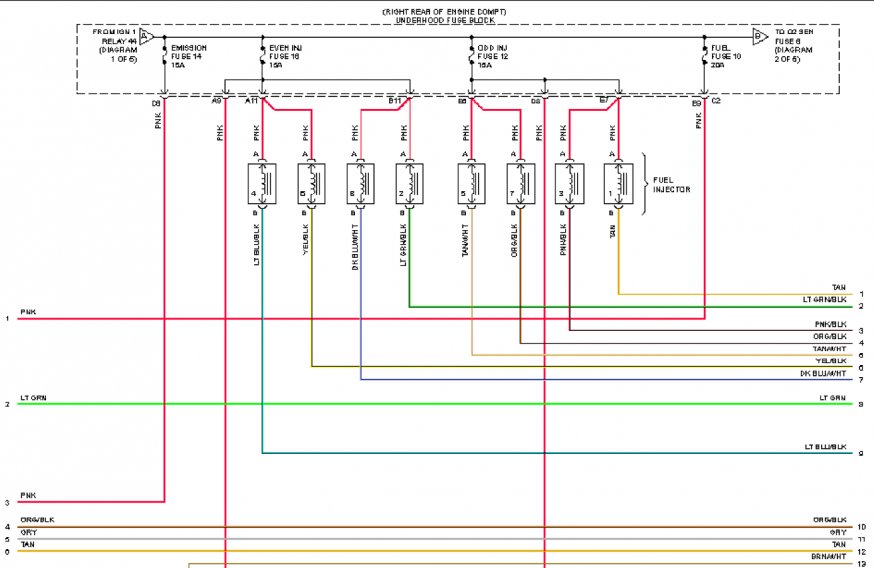

Hi I'm Brigitte and have a 2006 XLR. Any suggestions appreciated. Low voltage on even side injectors only. New pcm and injectors check out good. Also an injector wiring diagram may help too. Thanks!

However, attached is a find of the injectors wiring, at least this will give you an idea of wiring circuits.

Thank you for this information. Unfortunately it was the Cadillac dealer closest to me that did this to begin with and now they are stating that they had nothing to do with it. Anyways we will most likely bring it to Cadillac repair shop that is also close by. I appreciate all the information. Be safe and stay healthy.
