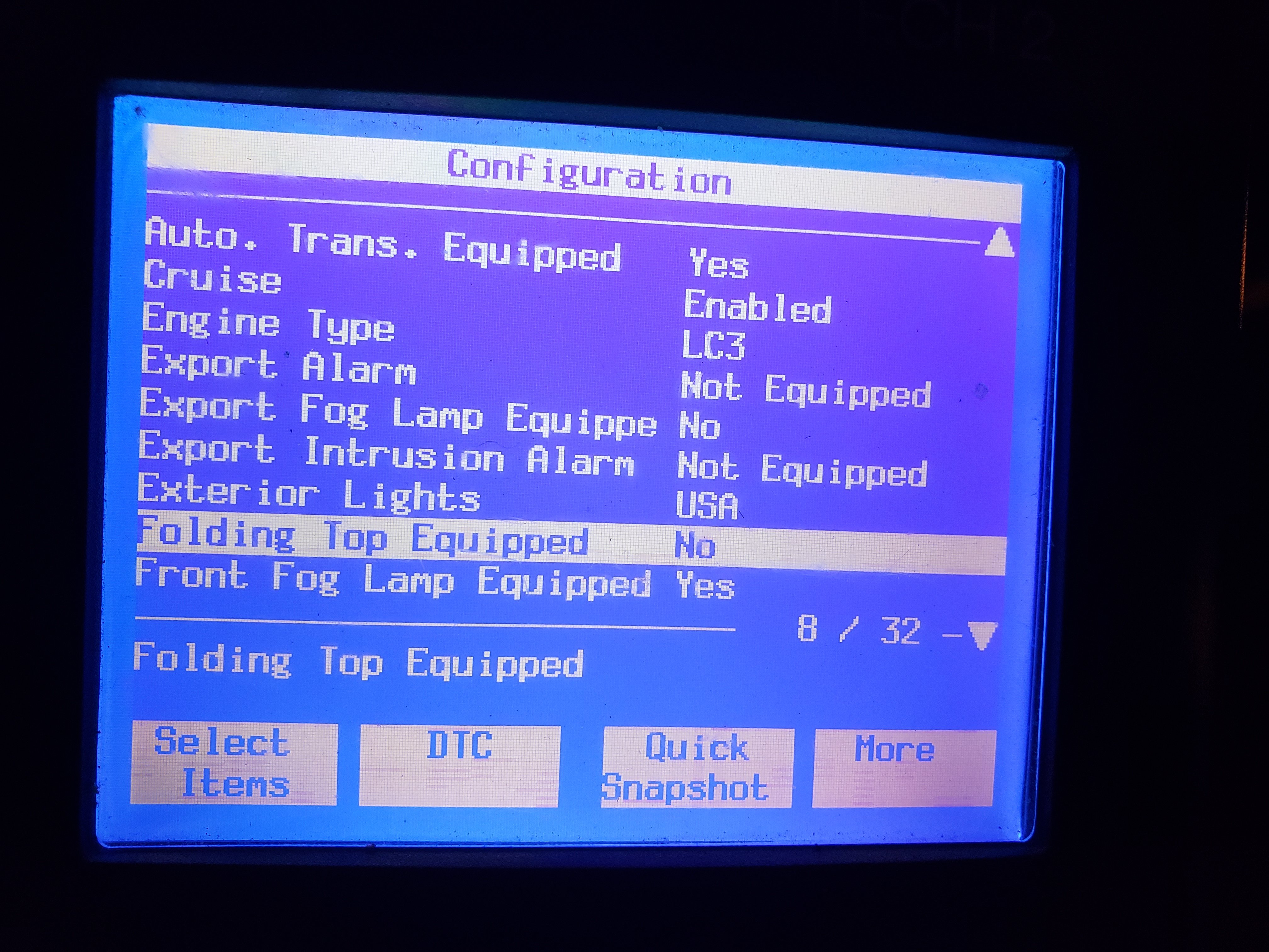

If I take my Tech II and I command the Trunk Latch to unlock, I hear a VERY audible unlatching sound from trunk area. The lid does not go up; however, I'm not horribly surprised since I'm dealing with a FTC issue.
I'm wondering if there is something w/ my BCM as it seems that wiring must be OK since I can command the switch w/ Tech II. I also noticed while looking at the BCM configuration that it ws configued with 'Folding Top' to ** NO **.... 🤷

Most of the time if the trunk opens the control top module is working, you will need to look at the live data on the module for signs of life and readings.
The famous car wizard had a similar problem with his XLR. The top would not perform a relearn. The problem was the Tech2's vmi was too old and didn't have the updated version. He switched to a newer VCI and was able to do the relearn. The VCI is the box that slides out of the TECH2. As far as the BCM having the folding top equipped check NO. That should fix itself when the top performs the LEARN. I use a XTOOLS D7 and it works fine for the LEARN process and it works on all makes. Mine is a 2005.
