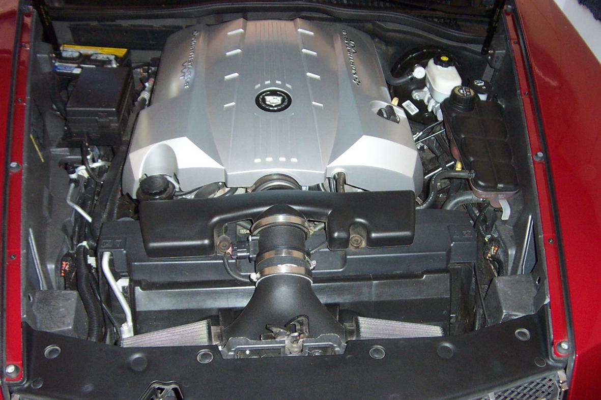

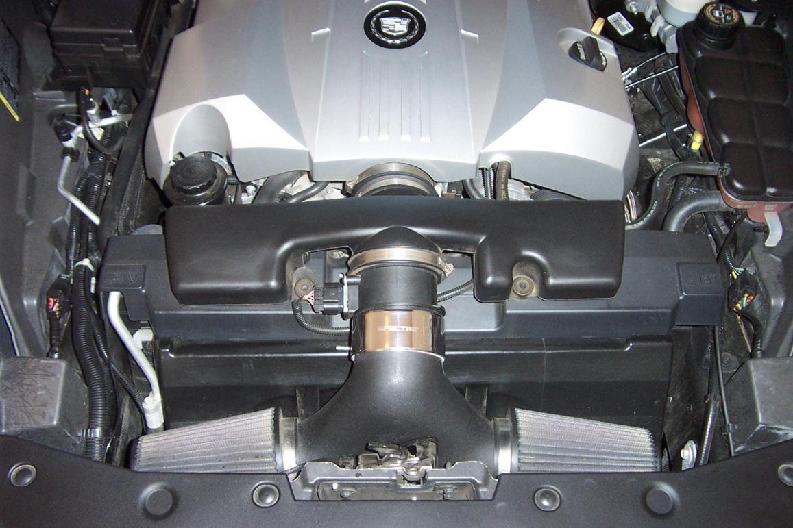

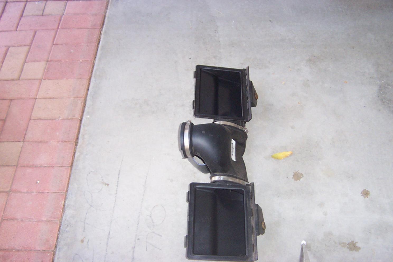

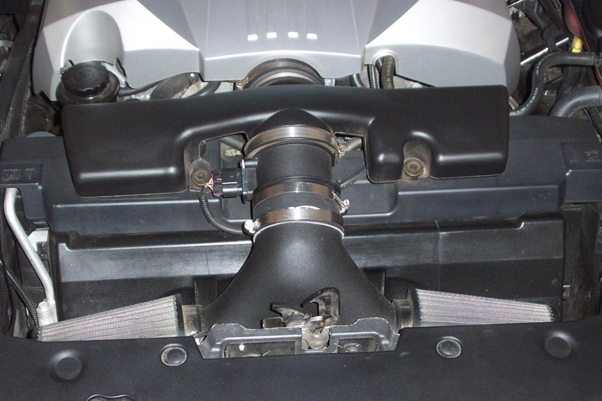

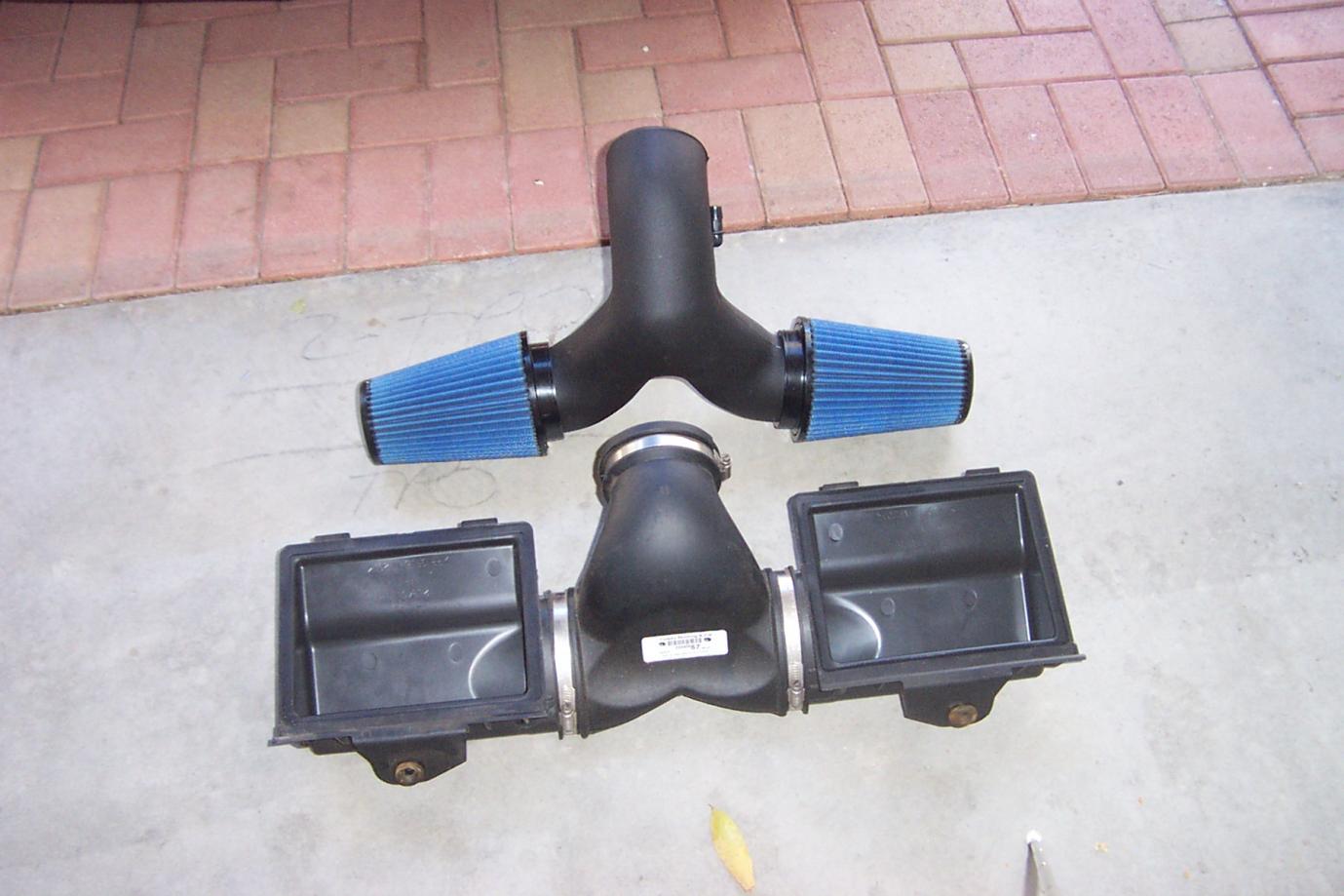

Hola,
I have a 2009 Platinum XLR, I installed the Volant COI also installed the Corsa exhaust. not knowing a lot about the XLR I just plunged into the installation, as we used to say BTFPTM. (beat to fit, paint to match).:) With a little creative use of a saw blade I adapted the ducting to fit. I purchased the COI kit for the 05-07 XLR. After I made the installation I dressed it up a bit by replacing the two band clamps with a chrome single band clamp from Spectre.:blinzel:
Volant DCP_0283.jpg[CVolant DCP_0285.jpgODVolant DCP_0349.jpgE][/Volant DCP_0348.jpgCODE]Volant SS Clamp.jpg

No, Sandy I have never had any error codes on the DIC. I believe this is because I did not change how/where the "Air Sensor" is mounted. It is in the original location. Maybe because of my lack of knowledge about the air flow, lead me to be overly cautious.
I seem to remember posts on this forum from members who had engine error codes caused by problems with the air sensor ( dirt, oil on the sensor). I think because I did not do anything with it I have had no error code issues.

Hola,
View attachment 3878[CView attachment 3882ODView attachment 3880E][/View attachment 3879CODE]View attachment 3881
Pat what did you have to cut or how much? Did you notice any difference when driving the car after the install?
I like the looks of your setup. Not sure if it's just the pictures but the filters not not appear to be red or pink. Time to clean and reoil?? :dunno:
.............. Did you notice any difference when driving the car after the install?.......................
I would like to know the answer to the above question myself. I am thinking about the Volant COI myself but would like to know if it is money well spent. $300+ is a lot of money if there is no notable difference in performance. :(
