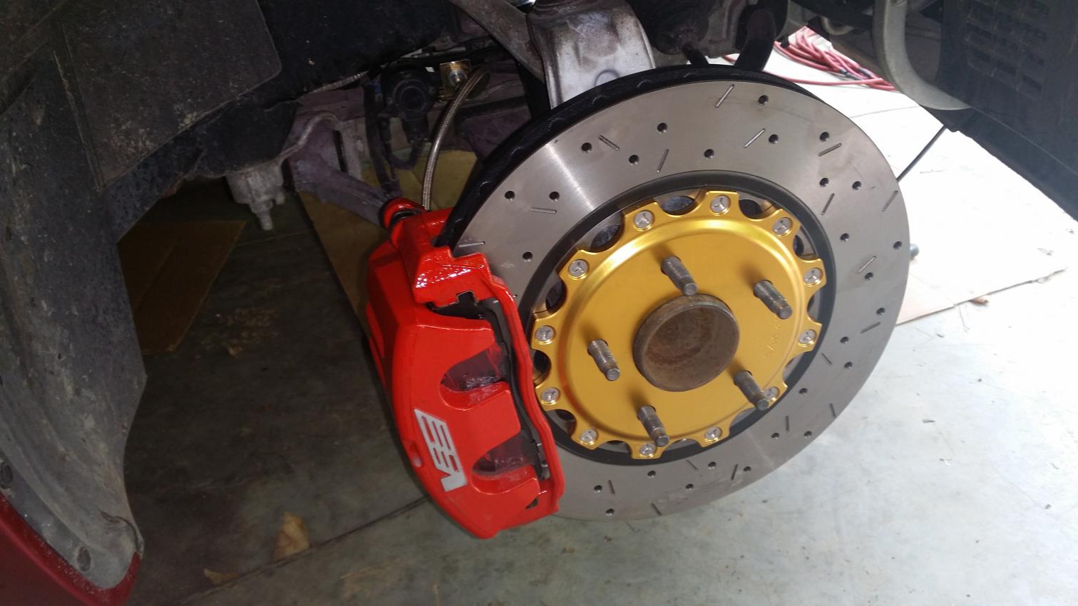

I like the red caliper But all in all I defiantly like the whole set up
Got mine on today. No piics with the wheels on yet. View attachment 4117
I like the plate over lug stud it covers that rusty looking area which you can see somewhat with wheel on!

What is normally seen is the rusty rotor. This doesn't cover that but replaces it. The hat is anodized aluminum that will not rust :)
