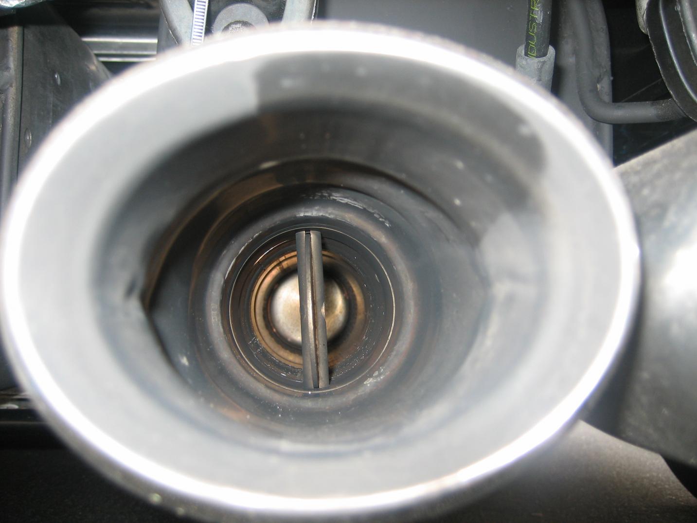

I was thinking to put a switch to keep the butterfly valve open all the time to have the nice sound all the time and to keep the engine more relax, so will have better performance. Is that information true??
If so, then why it's equipped with this valve and what is the benefit of it?
If you know this valve is blocking the two exhausts in the meddle, and when the rpm reaches 3 or 4 then it opens to release more emissions and have this sound.

The reason it is there is for quieter operation when performance is not needed. I do not think it will make any difference on anything other than sound.

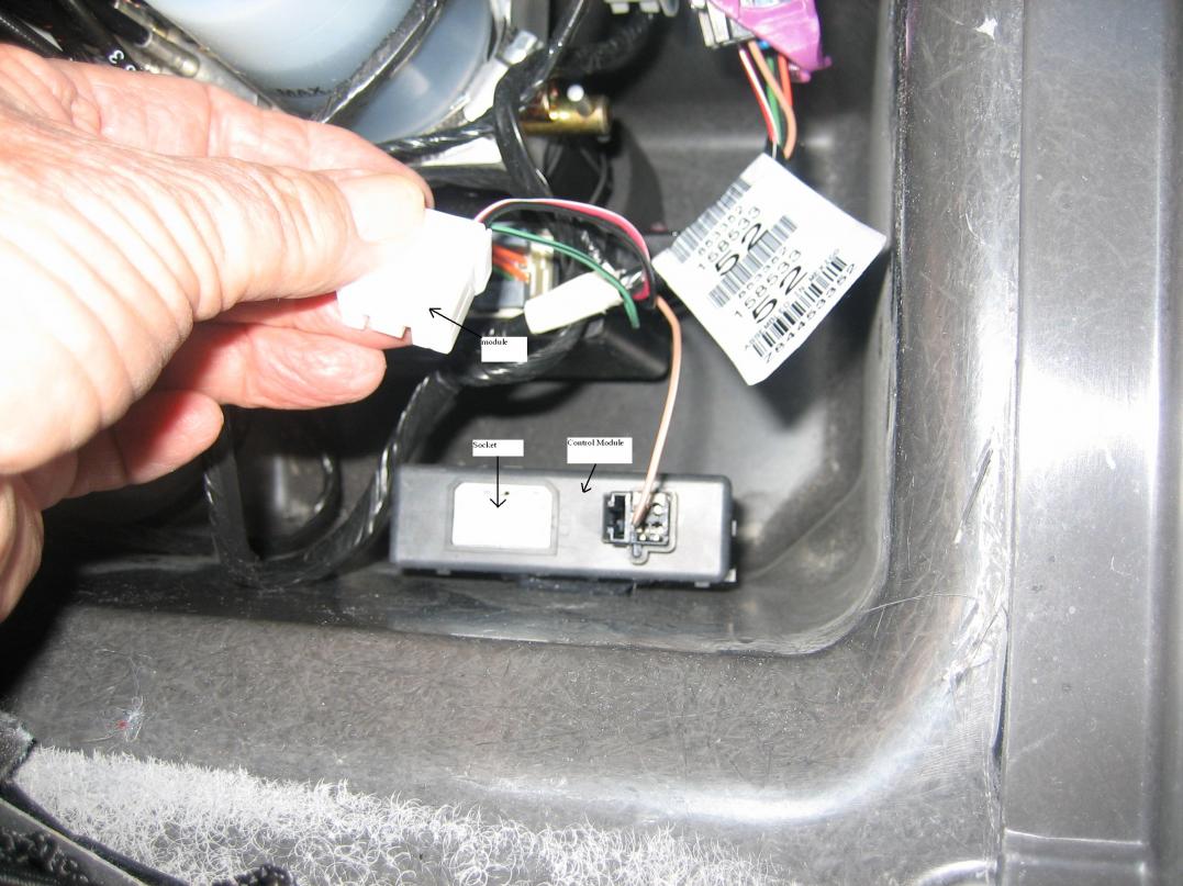

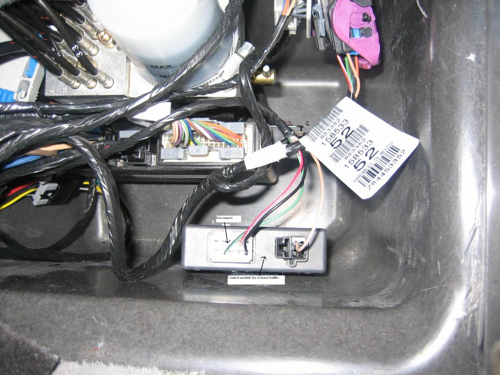

Yes, I think you can. The exhaust control module is located in the same well in the trunk as the hydraulic pump and control board for the top. I believe you can just unplug the connector from it and the exhaust valves will remain open. On my V the module was stuck to the side of the well in the trunk with some kind of sticky tar like substance. I'll have to look at my manual to see which connector to unplug. There are several modules in there and you want to get the right one and the right plug, but as I remember there was only one or maybe two wires coming out of the plug that needs to be disconnected.
you mean by just unpluging the right one, will have the valve open all the time without installing the switch??
If you look at the mild2wild instructions, it shows the white plug to disconnect. Unplug it and see if it stays open. The only down side is.......DRONE on the highway. The best way to solve that problem is with Corsa exhaust which has ZERO drone. I put the mild2wild switch on my V because I would kill myself if I had to listen to the drone on a long ride. Mild2wild is $64 and the Corsa is around $2 grand installed. I will eventually put Corsa on my V but I'm using the $$$$ towards other goodies right now.
Good Luck. :wave:
Unplugging the connector from the module will cause the exhaust to be "open" 100% of the time.
The only time I have a problem with droning is at 60-80 MPH on the highway with the roof up. I very rarely run with the roof up or at those speeds for long. When that does happen I simply switch to quiet mode. I also switch to quiet mode when at a drive through or when being "stealthy" like in subdivisions at 2AM.
The Mild-2-Wild is nice because it is wireless to the cabin. If you wanted you could install an simple switch that would open the connection when a louder exhaust was desired.
Actually you can unplug either plug on that module to open the exhaust up. I just cut the brown wire (the only one going to the black plug) and put a switch in series with it and mounted the switch in the console so I can turn it off or on when I want, but if you don't mind the noise you can just unplug it and your ready to go.

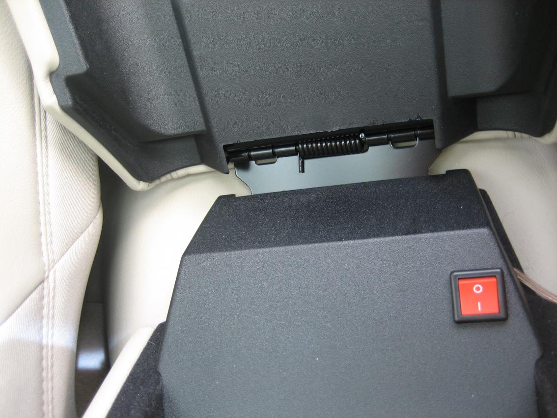

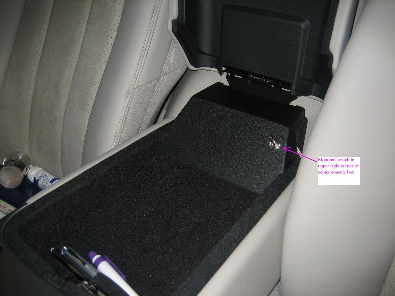

Fahad, I probably was the first one in 06 to find the exhaust control unit in the trunk and I cut the red wire, added wire to both ends and tunneled them into the center console with a rocker switch, (be careful where you mount it or the lid won't close.) Then came "mild to wild" and wished I had waited. Choice is yours. Leaving the exhaust wide open while idling can throw your traction control light on, if this happens switch it to mild. Bobo

Mild to Wild, or a switch is used to remove control of the exhaust from the car (above 3000 RPM and lots of throttle) and gives you control of when it is open. There is a vacuum operated valve the controls the exhaust routing.
