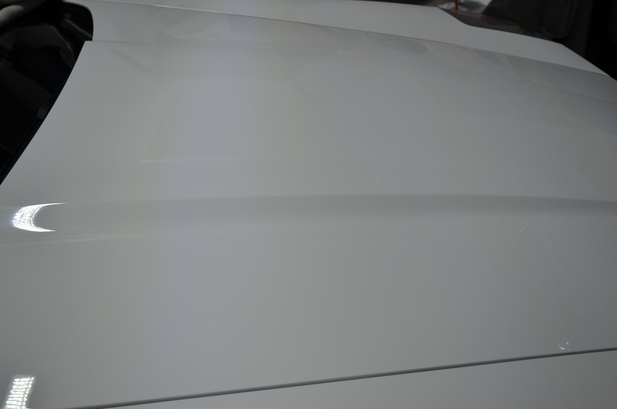

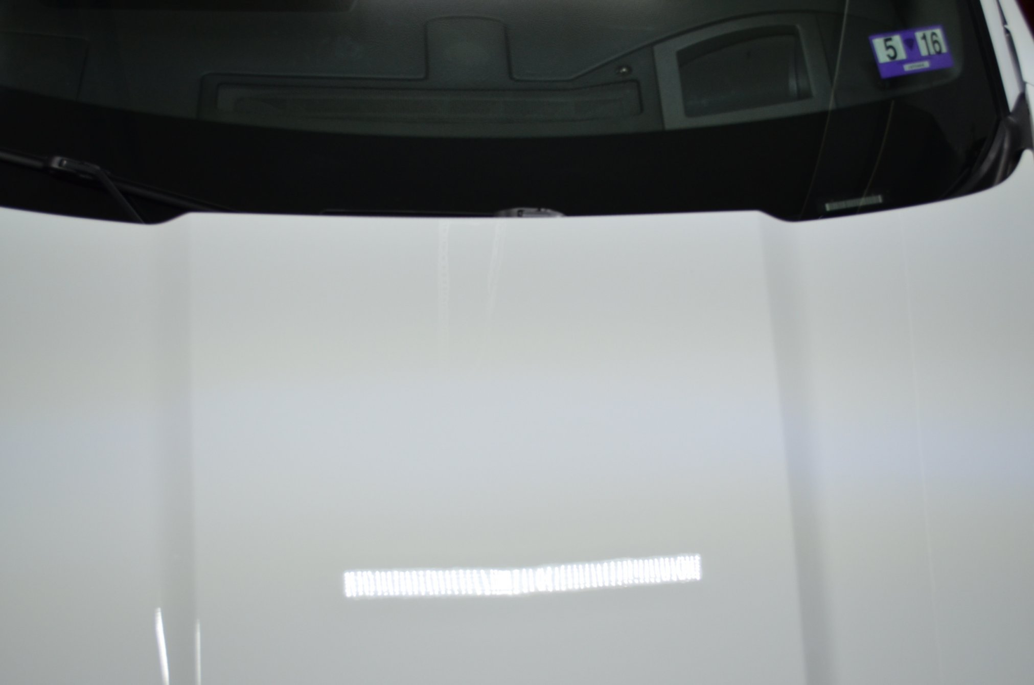

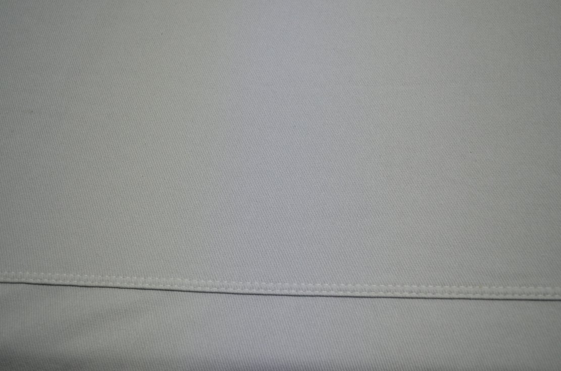

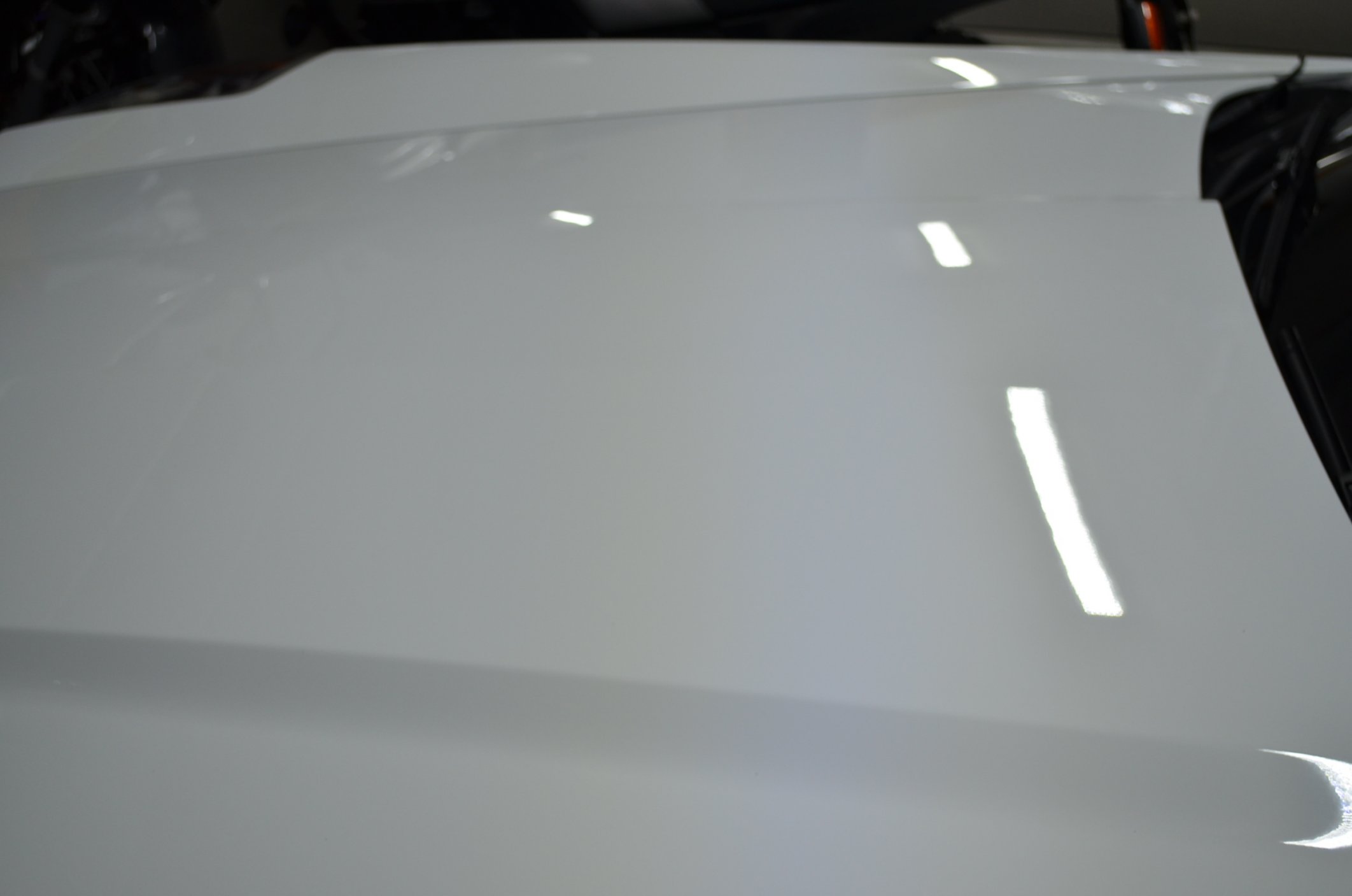

I purchased a California Car Cover. Their good thick custom cover. I installed high intensity fluorescent lighting in my garage. Over the course of one winter and intermittent lighting a dye in the cover has transferred to my V's white paint. There are perfect brown strips on the cover that perfectly match the light brown strips in the paint. You cannot see them in the sun (thank GOD) but under any other light they can be seen. I contacted California Car Cover, sent pictures, offered to send the cover, but they stopped communicating with me.
I am now getting ready to pay a detailer to try to buff the "stains" out. DO NOT PURCHASE COVERS FROM CALIFORNIA CAR COVER IF YOU HAVE HIGH INTENSITY LIGHTING IN THE CARS STORAGE AREA !!!!! DSC_0038.jpgDSC_0031.jpgDSC_0039.jpg

I personally would think it is more like a chemical reaction to maybe a sealer you have on the car or some type of wax. We have 50 cars under High intensity garage lighting In the museum here and they have every sort of cover I have ever seen as we rotate the cars from owners who store and or display them. I have never seen any damage from a car cover except when put on a wet car then it drys. In that case sometimes it raises the paint a bit but all it takes is leaving it outside for a few cycles of temp and it will level itself off. The only one I say damaged totally was block sanded and buffed with the paint raised and of course when it settled it shrank and now has divots in it. If its a dye bleed from the car cover than a simple demand letter with proff from you or your insurance company will get results. Have your detailer document what he does an if it works or not.
why not park it out in direct sunlight for a few days to see if it disappears on its own.
also a good cleaner wax rather than mechanical polish may remove whatever stain penetrated.
before a detailer buffs off a layer of paint, see if it can be removed more gently.
might even disappear from the sun baking the paint clean again...

Hi thanks for the thoughts - i have tried just about every gentle thing I can think of - tried over 5 different cleaners and waxes. I really think either this is a dye transfer issue or a kind of oxidation issue.
Please keep any thought you may have coming. I really don't want to go to this extreme but not sure if anything else will work.
