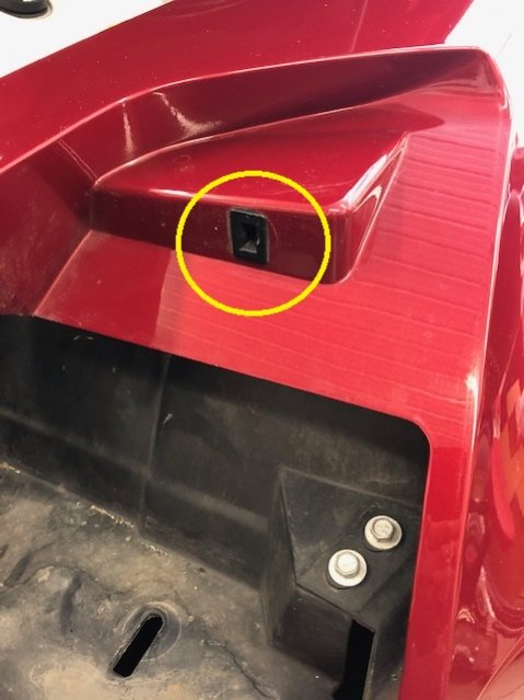

Can anyone help me with a part number on this plastic piece? It is a guide for the headlight assembly and the passenger side one is broken.

Checking in the GM parts books, the illustrations shows no part numbers in the Headlights or in their fender section.
Your chance will be to a salvage yards, however be careful they are strong money makers, as we all know that they dont give away the XLR salvage headlights.
That parts could be made with not too much efforts, with hi blue dens sterofoam wall insulator, it is soft and strong and easy to work with.
The XLR headlight guide pin is very similar with its rear tail lamps ones, however the lamp retainer is round instead of been square as per your photo, the part number is 11519749 .
