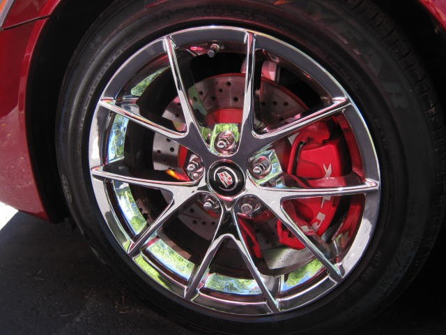

I will not likely be able to get the photo posted here, but check my Avatar pic. They are Z-06 wheels or copies I am told. Mine are 18" and 19" are also available. I highly recommend Chrome over polished Aluminium with Clear Coat. If you google XLR, there is an endless amount of wheel choices.
Gord.

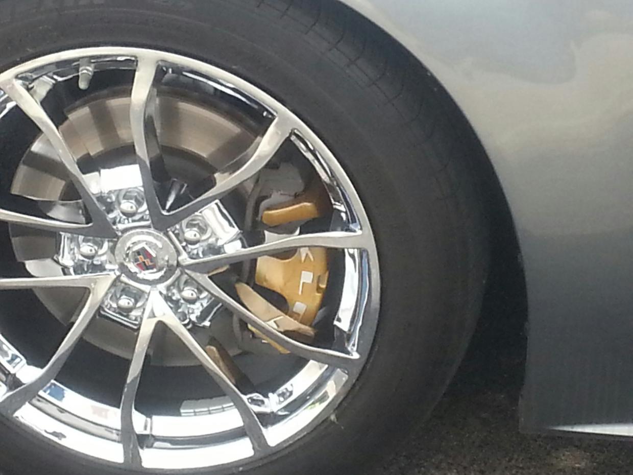

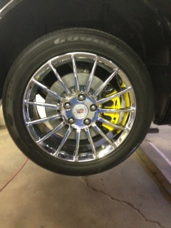

2008 XLR 18" wheel
I have these on my 09
Gord.
If you go with the V wheels you need to buy new tires too. I have the same wheels as boilermaker, great looking wheel, exact stock size.
