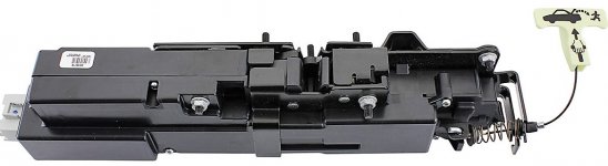

Yes....the first item that start the operations ot the retractable top, is the latch, if all the electrical are in good order.
When you get the old one remove, it could be interestingly if the latch could be taken apart, as the photo attached shows it could be open and may be repaired, that would be an excellent find and a lot more economical for all of the members.
Thanks
