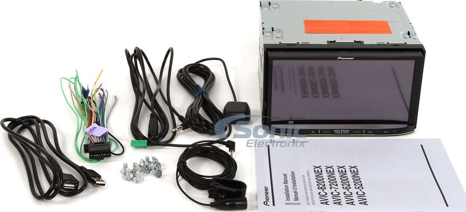

Josua
I beleive this is the unit you have mentioned with other necessary components.
IAN :wave:

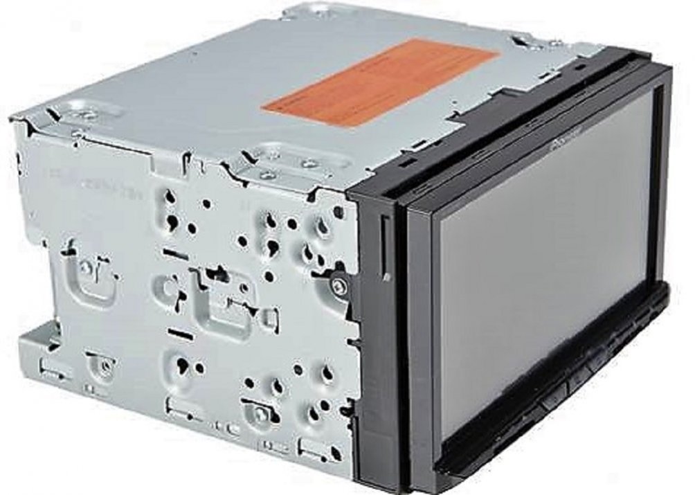

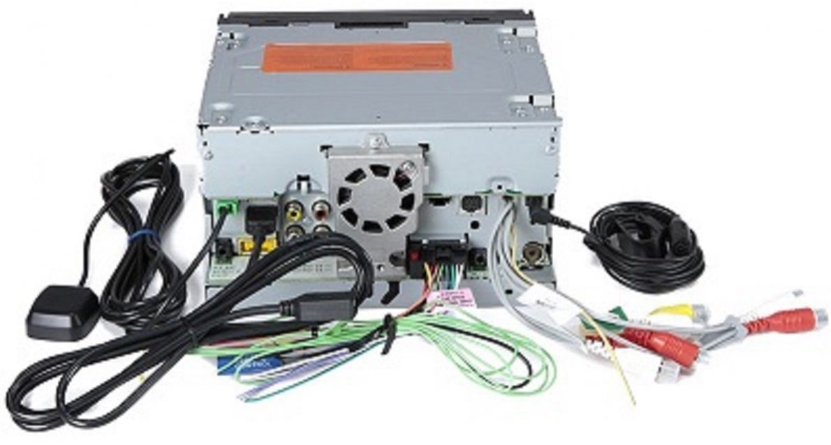

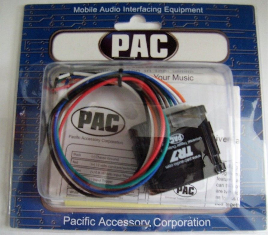

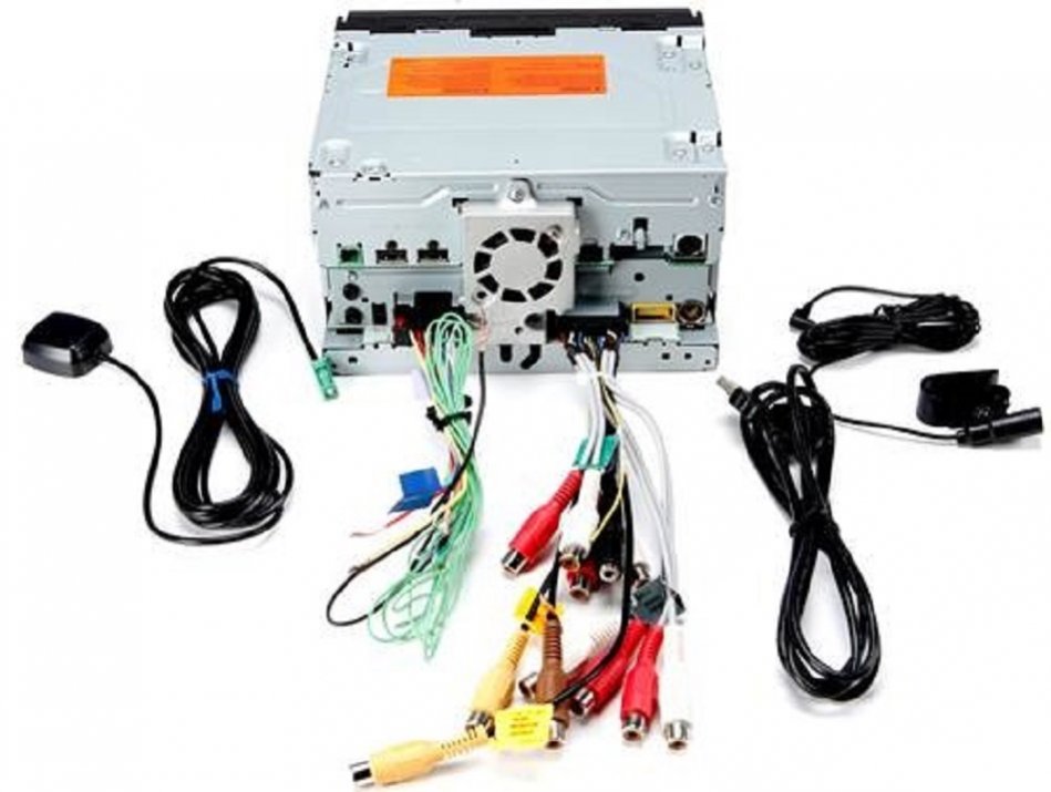

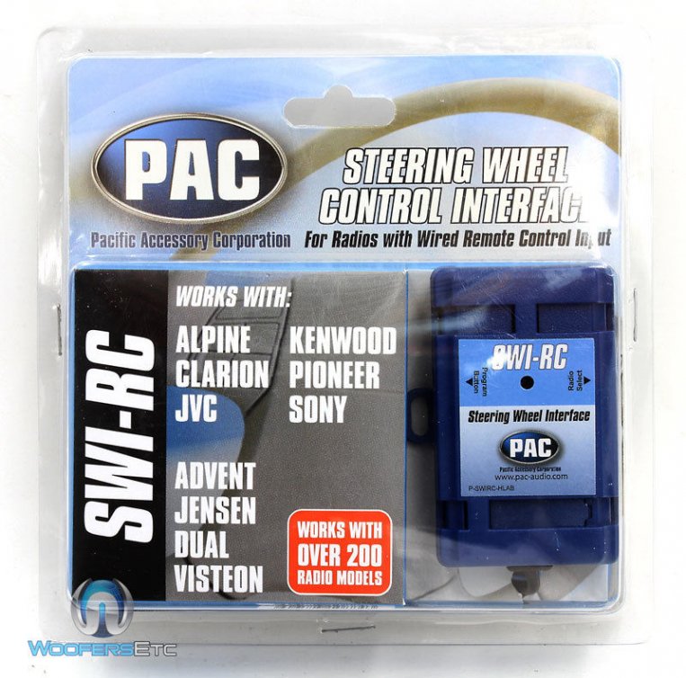

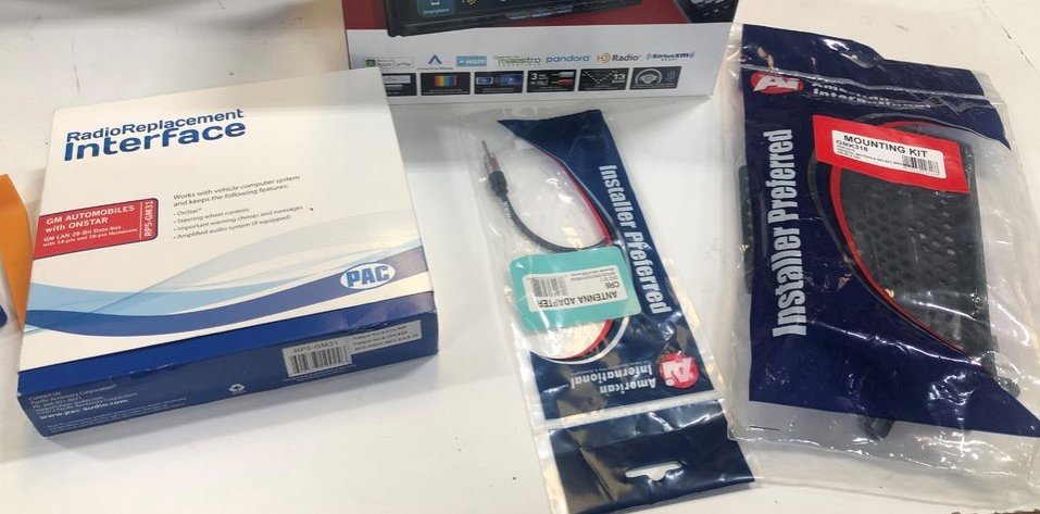

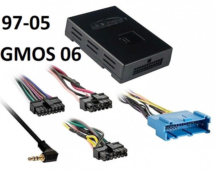

DB2
Enclosed are some photos of the pioner 4500nex sound system and its installation components.
If you make this choice, ( 1500$ +/- ) many seller$ are having different prices, be sure that the connectors are all included in the boxe.
Find also a photo that shows the installation kits that are required, for an XLR updated latest pionner sound system.
Good Luck
