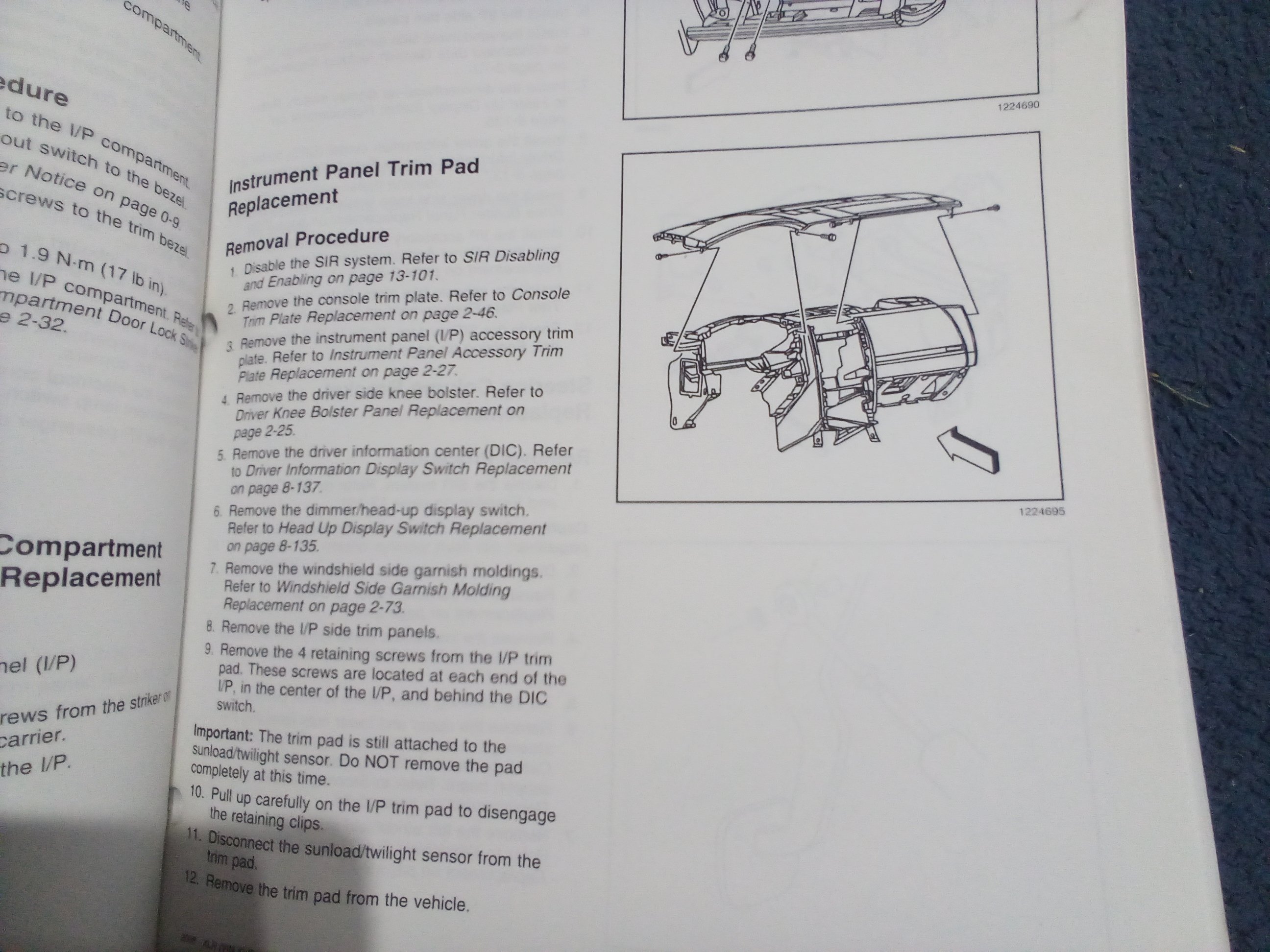

I offered to help also but you never emailed me.
Each step has its on section and requires several uploads that i find to hard to do here. Good luck. Its just nuts and bolts
No screws, but you need to move the shifter to neutral and use the trim tools to lift the top plate on the console just far enough to remove the center stack face plate.
