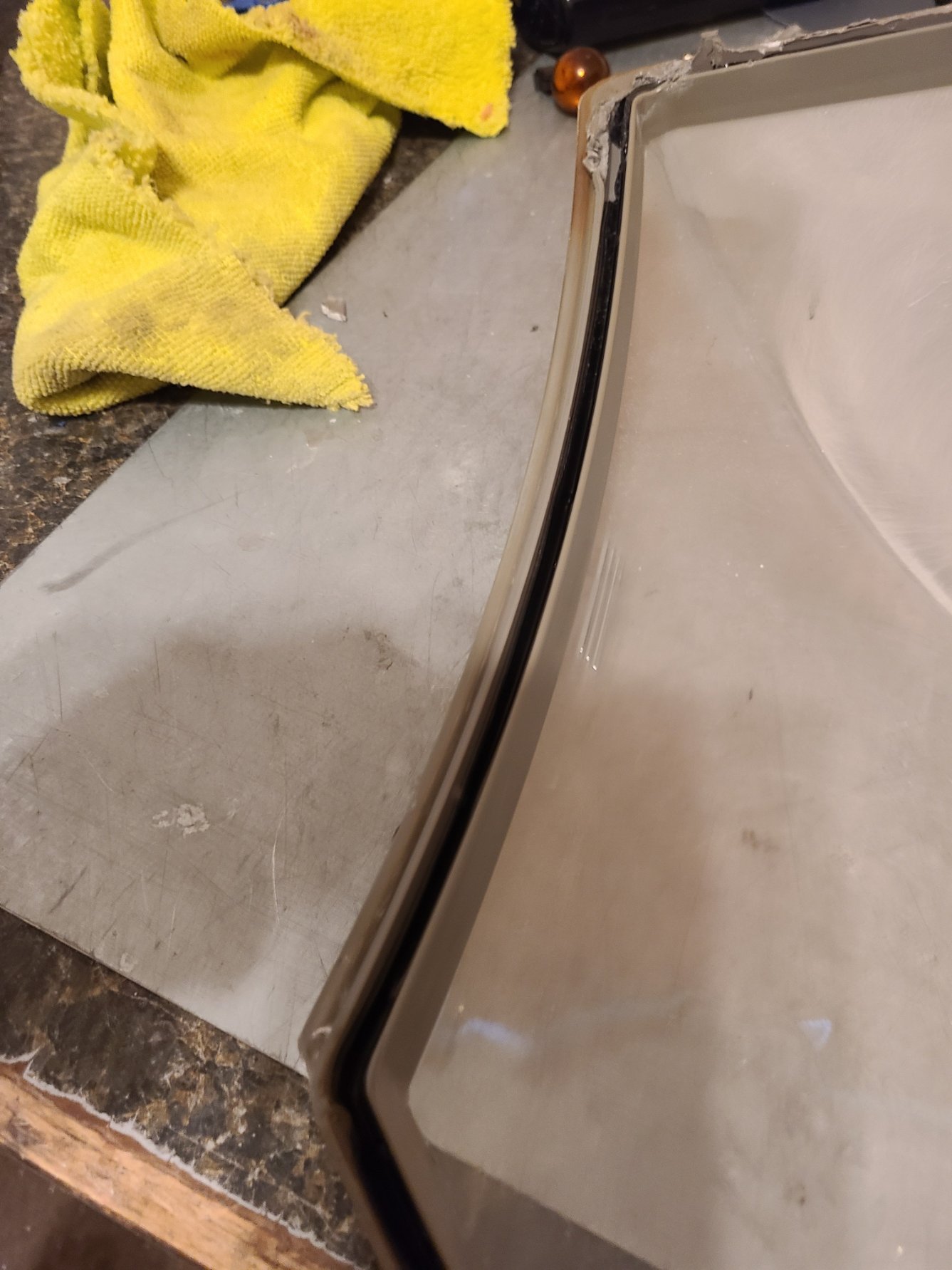

Okay I just removed the old lense I had warped with my buffer. The only way I could get it loose was the oven temp a 245 10-20 minutes. If planing to reuse the lense (say DIR lense removal) you need to under stand this. Remove rubber seal around the outer edge behind that, is a gray outer edge of the lense that is a part of the lense the butyl lies behind that gray edge. You will need to get a putty knife under that edge I started a the top left corner try not to break that out side edge that is a part of the lense. Picture # 1 shows the edge that I broke off,

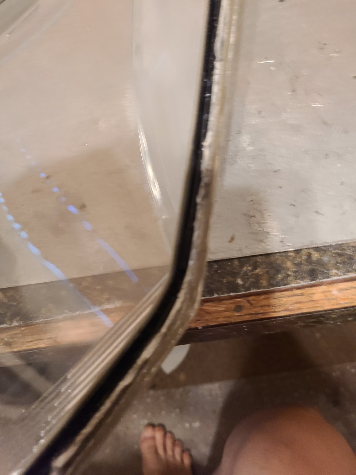

picture #2 shows the edge intact the black strip is the butyl seal. I hope this gives some information as I could have used it my self, and happy that I had a bad lense to experment with. Remember this takes some patient's my take several heating to soften the 16 year old butyl seal
