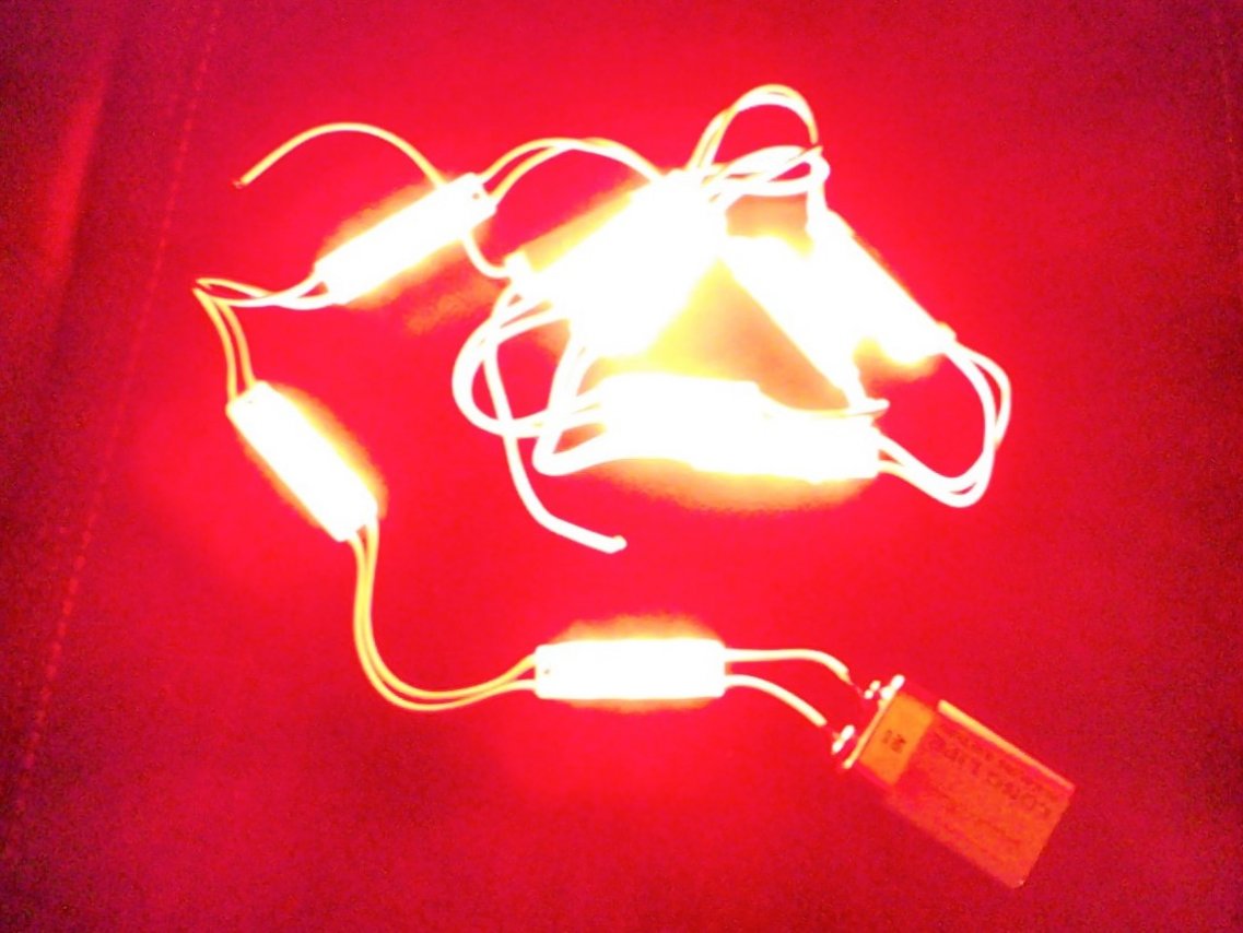

HI XLR owners.
Refering to my posting of a couple of days ago for the red 3 led modules that i have purchase for testing their hi intensity and how good you can work with them, i would like to add that the lighting is variable also and each module can be secure in place with small screws.
Also the photos send out end up to be some attachements, i will try again to send to you again these photos so you can see what i am trying to inform you.
IAN
HI XLR owners.
IAN
s-l1600[1] (13).jpgHi XLR owners.

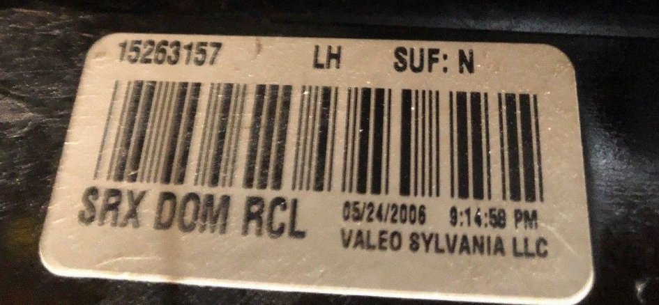

Valeo syviana in 2015 was the winner to build the lamps of the cadillac escalade, the GM representative mention that the lamps will be a sealed item and sold only as one unit, will the lens got broken the owner will have to buy a complete unit in the $700. he also said the lamp will last for the life of the car….( sic)
A ''chum'' is a ''chum'' a Gm representative that speaks for its supplier….. we all know that the XLR tail lamp do not stand the life of the car, may be the GM representative, in his mind, the life of the XLR should have been perhaps a short life like the EV1 electric cars pulled away from their owners, for been scrap.
They seems to be the same supplier who has produced the lamps of the SRX, as i found their name on a tail lamp of an SRX, it looks that they could have produced also the ones for our XLR.
I found also a tail lamp Board circuit made by VALEO but only for the BMW, nothings for the XLR kind of curious is in it.
WE are trapped, neither GM or Valeo will come and help us with the availability of the services items for lamps, we will have to do by our own initiative, and perhaps end up with some truck round lamps on our fenders to pass the government inspections or to scrap it, ( happy salvage yards ) similar of what happened to this fine GM electric car of the 80s.

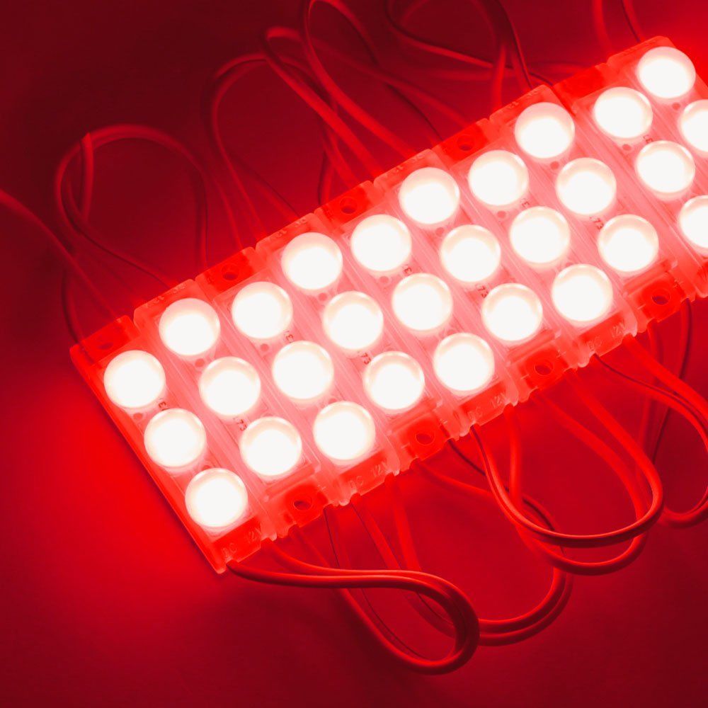

20190310_115356.jpgHi XLR owners.
Just received the new type of super led , as previous mentioned.
These sealed led are very brilliants as you can see on the photos, a second shipment is expected when received i will install them, the same as replacing a regular bulb.
Will send you photos of the changes.
IAN
