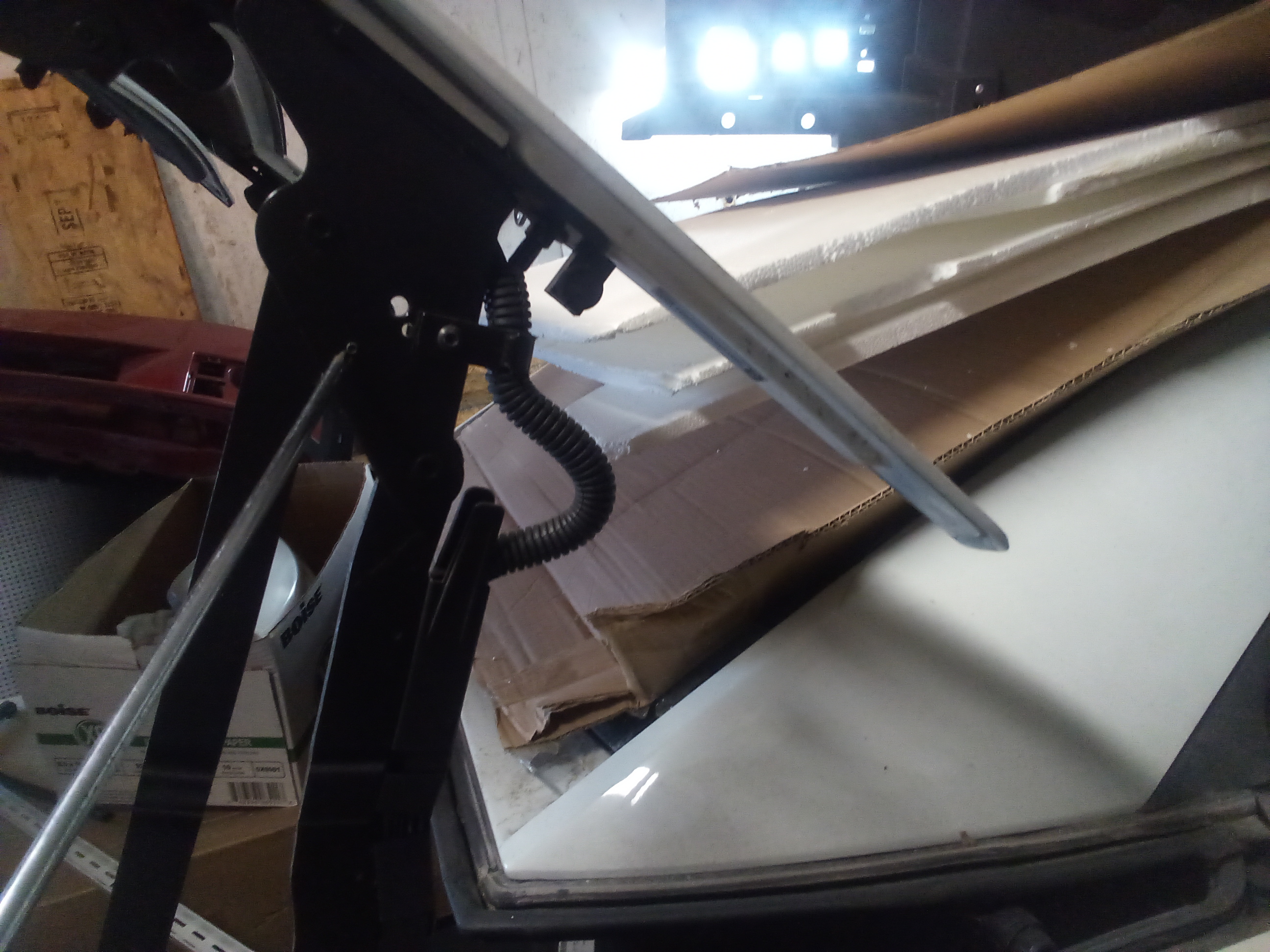

IMG_20240707_161030.jpgleft hinge from inside trunk. The left arm about 1 1/2 inch down . you can see the screw.The hinge arm rest against it. Remove it completely and the trunk can open a little more
View attachment 15338left hinge from inside trunk. The left arm about 1 1/2 inch down . you can see the screw.The hinge arm rest against it. Remove it completely and the trunk can open a little more
Got it thank you Micky. On the inside side of both left and right hinges. I was looking for a variable length adjuster, not an absolute stop as a bolt head.
Vital for those both to be in place when the hydraulics are lifting the deck lid!
Thanks again.

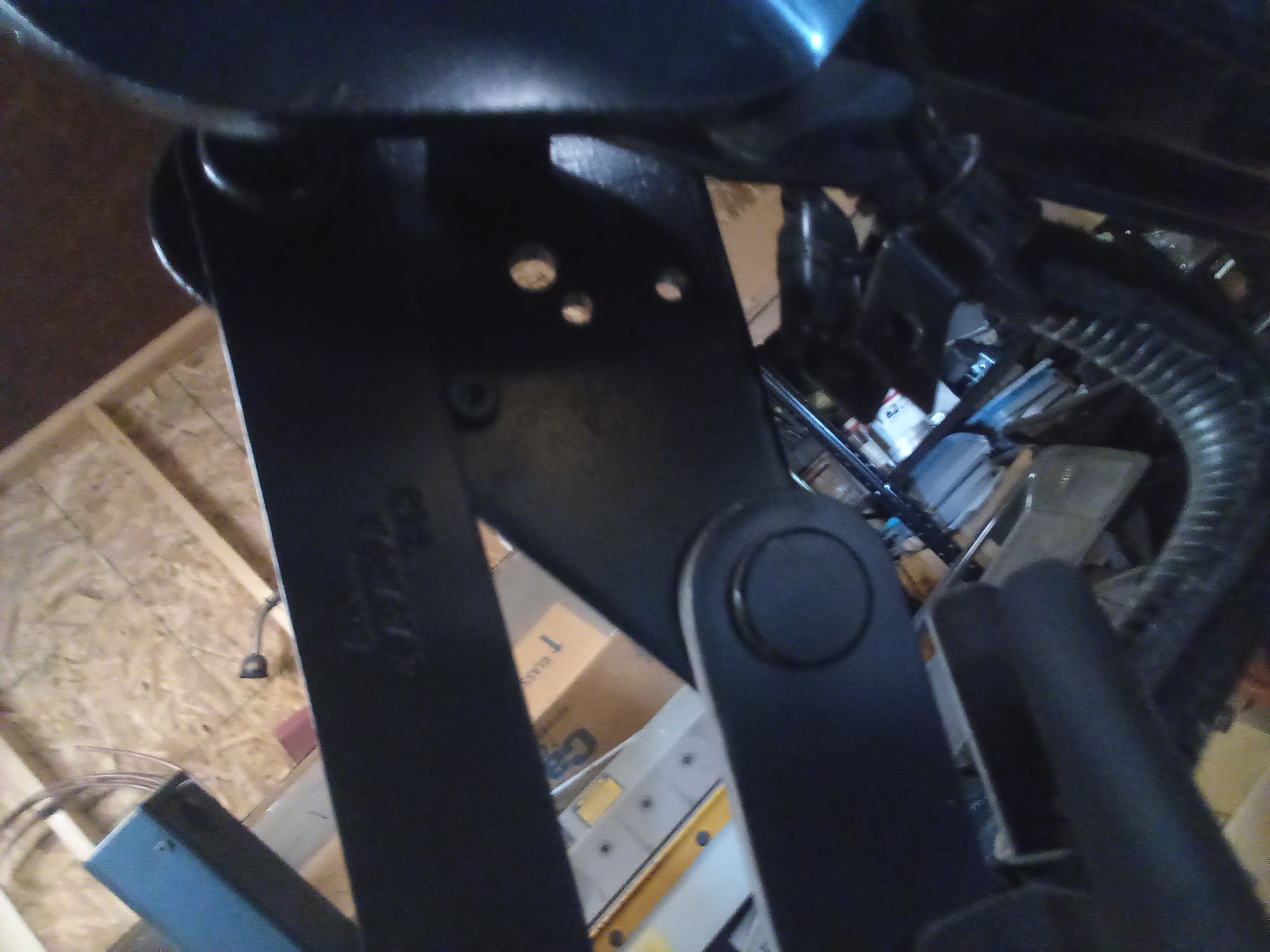

Heres s photo of the passenger side pointing out the back side of the screw. So you can see its location compared to the hole in the IMG_20240708_201045_burst_01.jpghinge
