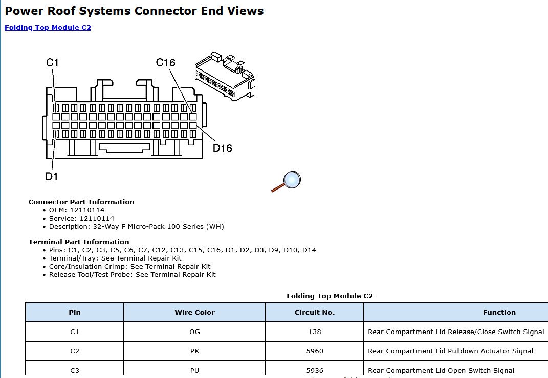

Where can I buy an XLR top module plug (white)! I don't need a harness, just a plug! Thank you in advance! Art

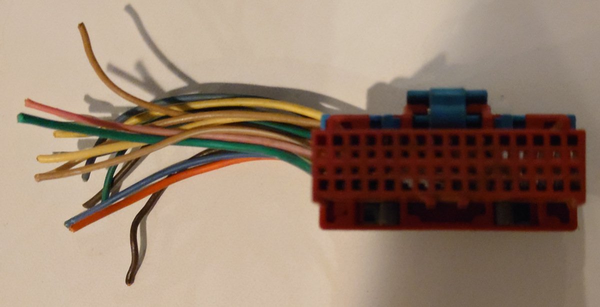

What happened? Do you need the exact one... or something you can use for parts/pieces? I have a red connector that you would need to grind off the alignment tabs that are in a different place than the white one. I can remove the wires and pins, or if you need all of them, I can include more.
Otherwise, hopefully, you can use the OEM part number (in the first picture) or description to find one for sale somewhere.

He is using red because he can not find the white without Ordering 1000 units
