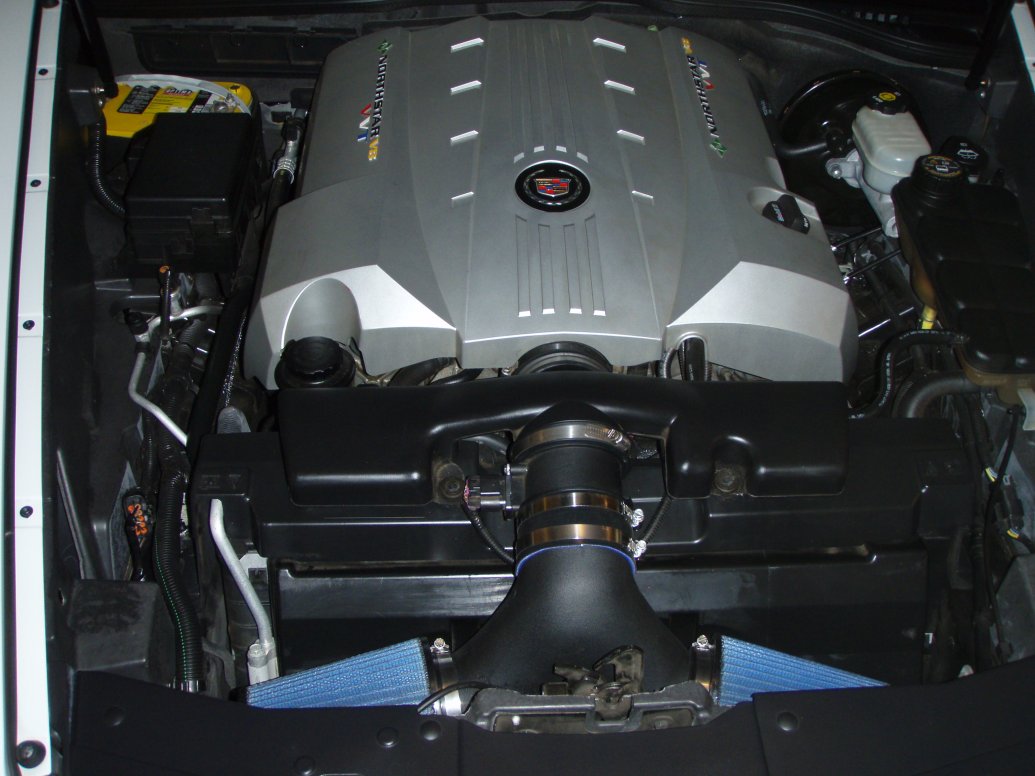

Here are a couple of shots from my modified Volant intake. I took about 4" off the intake runner to maintain the stock location of the Mass Air Sensor and OE air plenum. The car now pulls clean from standing start to redline in first gear to 2nd with no lean mis-fire between gears. 2nd to 3rd also sees no embarrassing 'pop' that I attribute to the free flowing full Corsa exhaust.
Note that this is on a 2008 XLR that customer service at Volant said would not work on.
