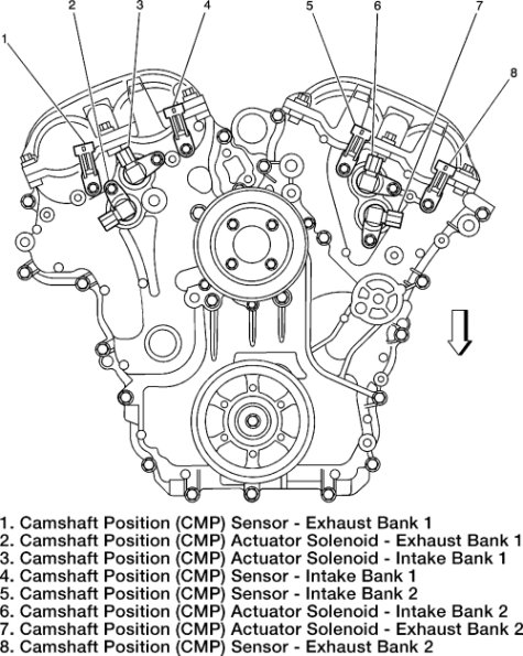

Same as title. Where is the Camshaft Position Actuator Solenoid located? Thanks[h=1][/h]
Help?
