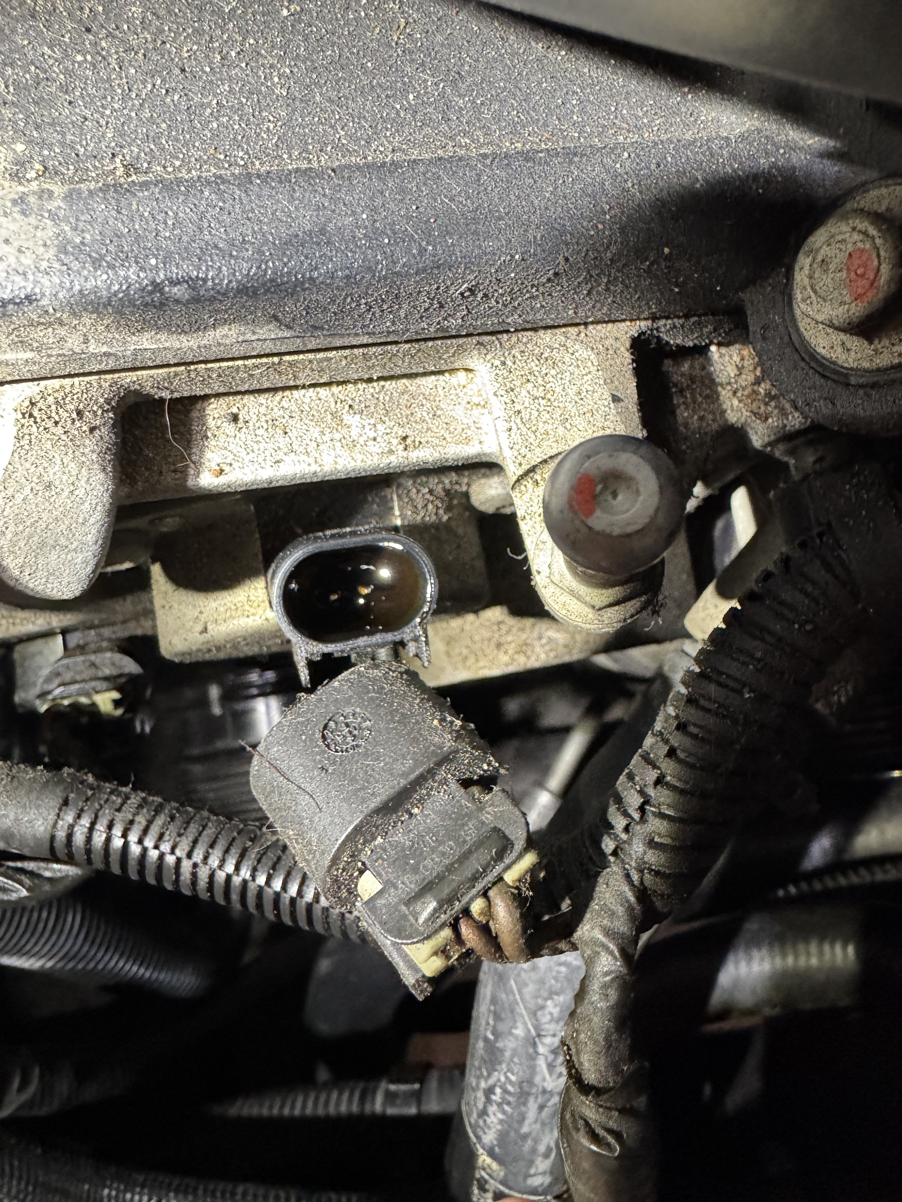

I noticed oil leaking from around the solenoid actuators, after close inspection I determined it was coming from where the wire plugs into the magnet. All four connectors were soaked in oil so I'm surprised the car ran fine with no check engine lights. Found new AC Delco replacements at rock auto. Installing the new ones were easy, I just inserted two studs, slid the new solenoid on, then ran in the first bolt as instructed in a previous post. No leaks and the car is still running great so I guess the job is complete. Admittedly I don't know much about VVT so if anyone knows if I need to do anything else, please let me know. Thanks

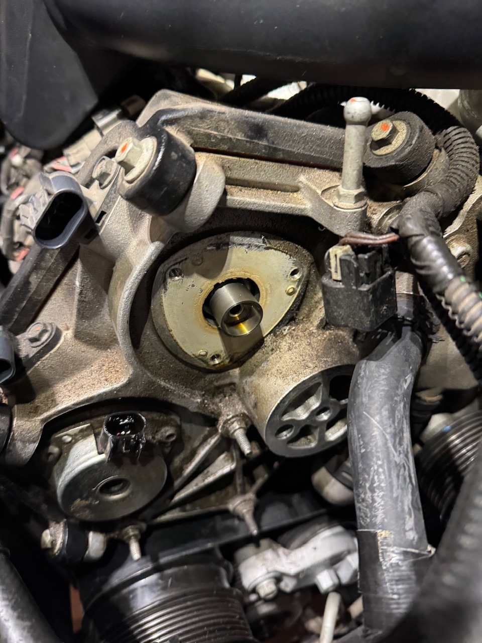

just made the same discovery on my 06 LC3. Have a set of 12567085 on the way. Is there a good link for what I need to know for replacing these? One plug plus three fasteners for each, it can’t be that easy. Any gasket or RTV I need to use? What’s the center pin locator referenced above?

Loosen the bolts but leave them in when you try to break it loose from the head. Gm used some really strong stuff. If you pry it loose without the bolts in you can break the vvt valve. It will snap right off. Now if you want to do it correctly .get you some long bolts the same size as the little screws. Just an inch or so long but long enough that its not threaded all the way . a stud is perfect but harder to find. Cut off the head . Hand screw the three headless bolt into the head . Slip the part over the bolts that are acting as alignment pins. When pushed against the head so you can hold it.remove one stud and insert one bolt. Then the next one . one at a time. That will keep the magnet centered. you can do it without the studs but you may get noise from the vvt rubbing and you can get premature wear on the magnets. They run on oil and should not touch. Its a very close installation that you can get wrong. I use high temp oil resistant sealer. Not much is needed.
Two possibly dumb questions.
1 - during removal I bumped the VVT actuator by a 1/4 turn or so. Do those care about rotation or is it just a push/pull action? As in, have I royally made matters worse?
2 - the reside left over, does that need to be removed or, provided I have an unbroken ring for which my RTV (ultra black?) to seal, is that workable?

If you are talking about the cup in the center. It spins .you can carefully pull it out and make sure it snaps back in.You also only have 1/2 the accuator removed. Put the screws back in and peel off that last cover. They you will need to clean the head very good before putting on sealant.
No worries about the rotation but I would make sure to have a clean surface before reassemble.
Thank you gentleman. Can confirm I got both halves of the magnet casing off (first one split during removal, although on my second one I got it off in one piece). Used a plastic scraper to take that white adhesive/sealant off the mating surface and took it down to bare metal, and used brake clean on the metal mating surfaces. Will do other side tomorrow, time for whiskey!

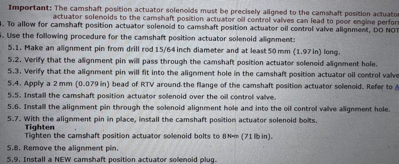

Knocked out the other two this morning. Summarizing the experience since I came across some confusing info out there. 12567085 was the PN for my 06 for the replacement magnets.
Official procedure (attached photo) is to take out the black center cap on the magnet and use a 15/64" dowel rod in there as the centering device. However, removal of those center caps destroys them and I can't even find a part number [edit: PN is 12567421 and it's discontinued & unavailable], nor a listing for them. So I didn't want to remove those caps and use the centering pin. On to Plan B, the three studs method.
I used Hillman 880660, cut the heads off, and wrapped two layers of vinyl tape around the upper two thirds of them (so it was a tight fit passing them through the bolt holes on the magnets). To remove the old magnets, I backed out each of the fasteners until I could see about 1mm of exposed thread, then used a sharpened chisel to break the seal. Once the magnet was free for that 1mm of play, removed the fasteners one at a time, replacing them with the studs. Remove old magnet, use sharpened plastic chisel to remove the adhesive/sealant down to bare metal, vacuum out the bits of debris, use extreme care not to get any in the center opening or on the VVT actuator itself. Cleaned mating surfaces of new magnet and on the engine with brake clean and lint free rag. 2mm bead of black rtv on the new magnet. Install (using the studs to align it properly). One at a time, remove studs and replace with fasteners, hand tightened. Wait one hour, torque to 8Nm.
Since my connectors were oily, I used QD electronic parts cleaner and cleaned them out as best I could, let them dry, reassembled. In my case, doing this job with the PS reservoir removed, as well as the alternator/water pump belt & tensioner removed, gave me plenty of clearance to work.
