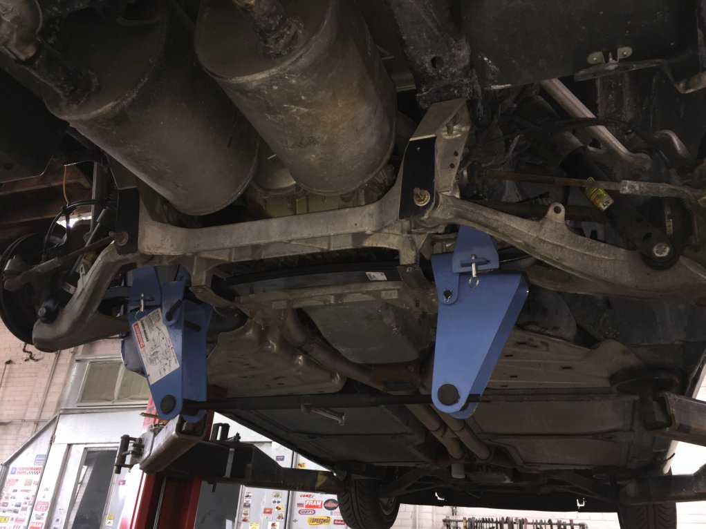

I believe this car has some kind of aftermarket exhaust system already done as well. Could anybody please send me an underside picture of the stock exhaust system? My car has an H pipe which I don't believe comes stock thats why I ask. Also the actual mufflers themselves, not sure if they are aftermarket. This could all tie into a lean/rich fuel ratio which is causing issues with the 02 sensors (if it wasn't tuned for the work).

  • here is a picture of a stock exhaust system on a 2004 XLR, you can see the H pipe crossover.
