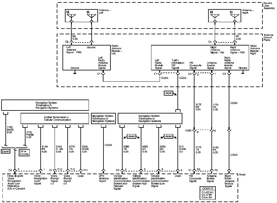

Long shot. Does anybody have the schematic for the stock antenna setup? It would be the one stuck to the trunk lid. I need a 12 volt source for a rear view camera. Assuming the antenna module has a "switched" 12 volt source.
