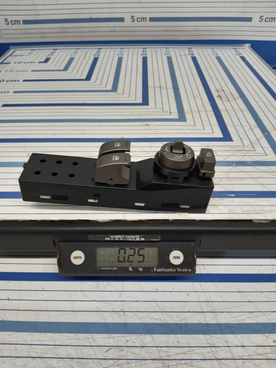

You all might want to see the window switch I am now adding to my US homologation XLR. At the top end of this bracket you will see there is an additional button. That is for all international XLRs and allows drivers to power fold the wing mirrors - very necessary in Europe. Would be useful in the US for those of you with narrow garages and people who walk by and tend to knock against the wing mirrors.

Yes, very handy that - if you can find one. Don't forget, the mirrors have to be changed as well along with additions to the wiring, relays and such. It's not a horrible task, but certainly not 'plug and play'. ;-)
Gord :thumbsup
Hi Bill - I bought some parts from SMC already. I already installed the wiring and the EU mirrors - I was just waiting for the power windows/mirrors panel which SMC did not have. I got it from my supplier in the Ukraine -:)
