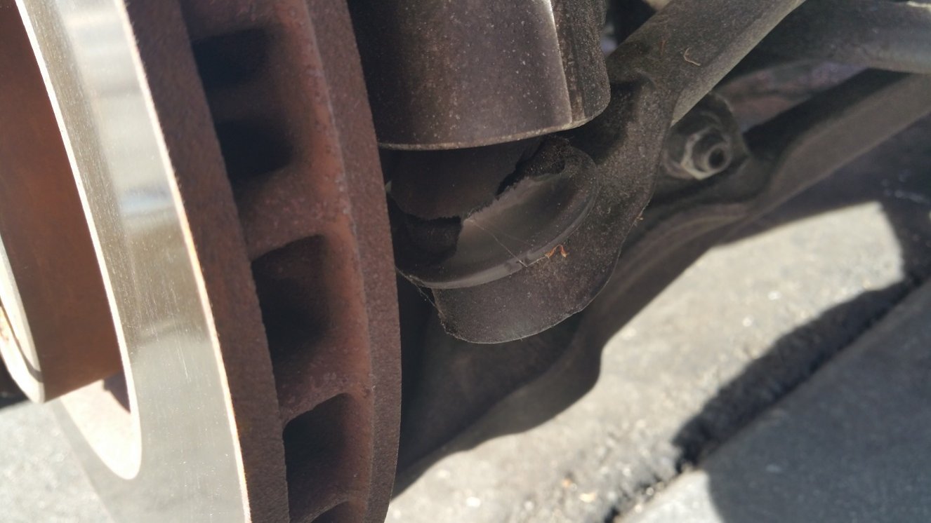

yeah currently the steering is having a issue possible stuck caliper as well rear driver side (feels like there is excessive drag.) as well as a sweaking noise ()
my grandpa let me drive him home Probably the worst drive ever. the steering is awful Even my 2003 impala steers better and it has a leaky power steering pump.. and that car is a "junker car"
the car was becoming unstable over 55mph. as the steering requiring too much correction. it felt like one of the wheels were not turning in sync. most noticeable on slight left turns on the road.. not as bad on rights in the road..
It was more work then fun. :( ... very exhausting and stress full drive .. even the 3 banger Deawoo rental car was better drive while and at lest the steering worked great
also on the ignitions were not even replaced they still had the fault and it does not take much shut the engine off. I would be super worried if it was a bench seat version and a kid taps the key or plays with it, causing the engine to shut off
it does not really take much to make it shut off.. you only have to turn it 1mm and it shuts off.
could be the tie rod

1. Easy fix for the ignition switch. Don't let kids drive the car, and don't press it at all when in motion. Ever.
2. Are all these issues new or from eighteen months ago?
3. Has any servicing been performed?
4. Is there power steering fluid in the reservoir?
If the car has multiple issues, they probably didn't happen simultaneously. Again, is the car being cared for and taken in for service? As I said, it's over a decade old and each problem needs to be addressed to ensure it doesn't cascade into another one.
When properly maintained, the XLR is a joy to drive. If problems aren't taken care of, it performs no better than any of the cars you mentioned.

yeah he has done a bit of work recent.
New ignition coils , new spark plugs as he had a misfire on the car.
New battery every year.
the current issue is the steering he never noticed it (it's not a problem at lower speeds he drives (no higher then 30MPH here in Los Angeles) as he does not use the freeway anymore.)
The car just flaps around in the wind 55MPH+
the correct term is there is too much Understeer
Last oil change was in Aug 2016 with full synthetic (he only drives 2000-2500 miles a year) as he has a Silverado 2500HD 6.0L king cab truck he drives as well
The transmission works great and shift smoothly no strong shifts (all 5 gears+R are great)
he is a well experienced driver since he was driving since he was 14 years old , and is a Retired Commercial Professional driver as well (California class B) Retired Automotive mechanic as well (He only worked on his own cars and his Large class B commercial trucks)
He does not "do his own automotive work anymore" since he is disabled and can't lift heavy stuff anymore.
once I pointed out the steering issue yesterday he noticed it today..
