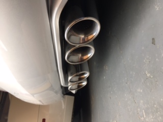

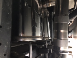

I just installed the MagnaFlow 16794 kit on my 09 XLR. Fit was very good, able to do the whole install in an afternoon on jack stands in my garage. Toughest part was getting the factory square exhaust tips off. Went with the new 4-round chrome tips with the kit. I like the sound, nice low rumble and idle and not loud at normal cruise speed, has a nice growl when you put your foot into it.
Post some pics!
MagnaFlow Exhaust on 2009
photos attached MagnaFlow kit.

Thanks! Was curious how the round tips would look in place of the square/rectangle.

Dont forget that picture is a 09. Looks a little different than ours. I also wonder if he installed the Magna flow cat back or there cat manifolds also? When I checked with Magnaflow a few years ago they suggested there system with there header type cats. They also did not check them for increased hp on the V,s. I never installed Magnaflow because at the time they were back ordered on left Cat manifolds. Also if you install there system you could not keep your heat shields. They assured me I would not need them because they had better flow and eliminated the cast iron factor of our manifolds. Just throwing that out there!! :dunno:

I used the cat-back kit. all the factory heat shields stayed in place. The O2 sensor was not relocated since it is in front of the flange. The mufflers are polished stainless steel and much smaller than the factory ones, this allowed for plenty of air space and room to adjust for fit.
