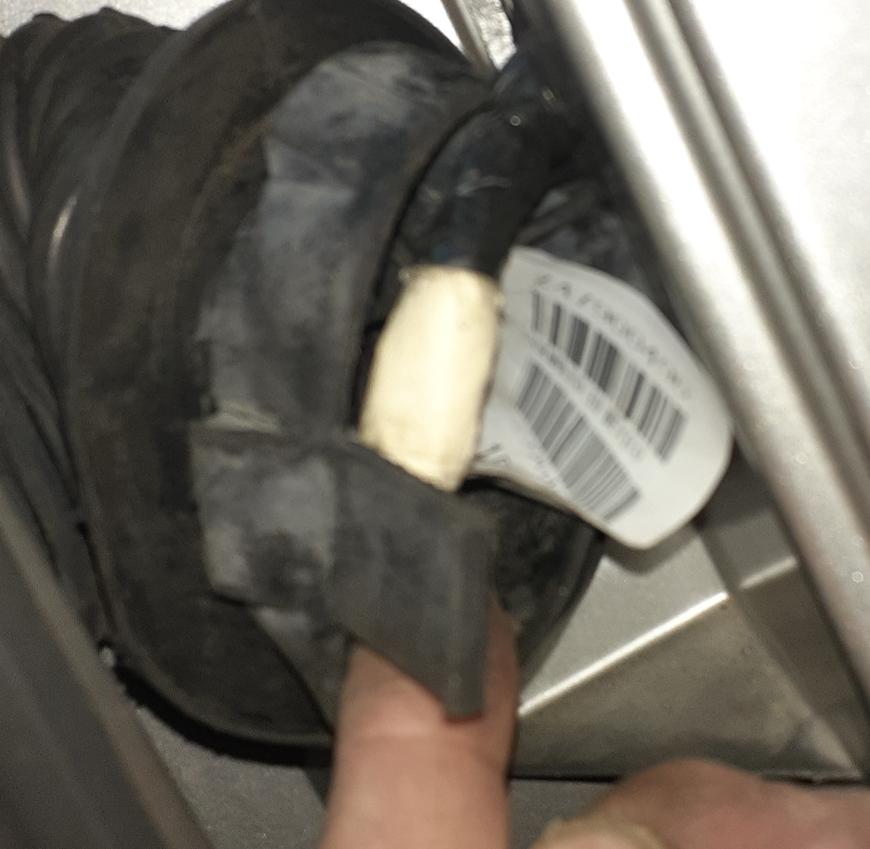

Taking my car to dealer tomorrow, I believe my passenger door being dead has to do with one of the two connectors in the door pillar area. Tried to get to it but the confined space makes removing the body side of the corregated piece too difficult for my old fingers. Hopefully the service tech tomorrow has skills to remeady this with minimal hours and parts. I'll report result later.
