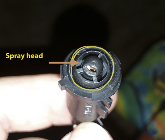

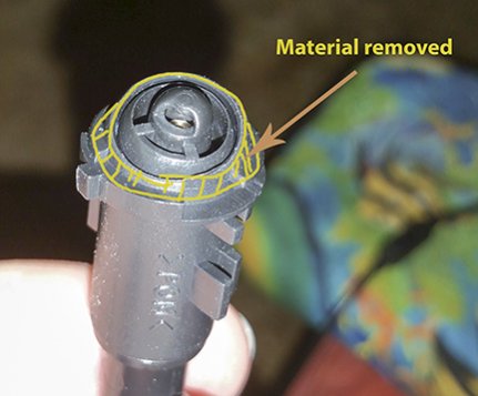

These sprayers are two pieces. One piece is an insert into the sprayer tube and contains a small brass spray head much like you see on patio misters. The sprayer on the passenger side was missing that piece. (can't figure out how it got knocked off/out) After looking at it for several minutes it looked as if this small piece was pressed into the actual sprayer tube. I had an extra sprayer so I took one of them and with my Dremel again cut down the retaining portion of the sprayer which left me with a small "pod" containing the actual spray head.
Going outside to the XLR and checking the fitment I found it was an exact fit. I used a gel type super glue on the bottom of this little pod and making sure of the alignment so the spray would hit the headlamp pressed it down into the existing spray tube and let it dry for an hour or two.
After letting the super glue dry, I turned on the windshield wipers and tested out my handiwork. Success!!. Both sprayers were really hitting the headlamps with good water velocity. I installed the passenger side spray cover like the driver's side.
