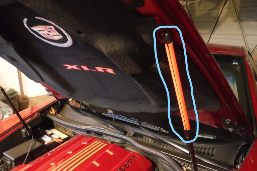

I split a length of the new plastic tubing used for plumbing houses on a table saw (1/8" blade), chamfered the ends a bit and slide it over the rod when the hood is up. It stows nicely in one of the holes on the inner fender behind the headlights. Colour choices are red or blue.

DSCF7780_LI.jpg (118.2 KB
