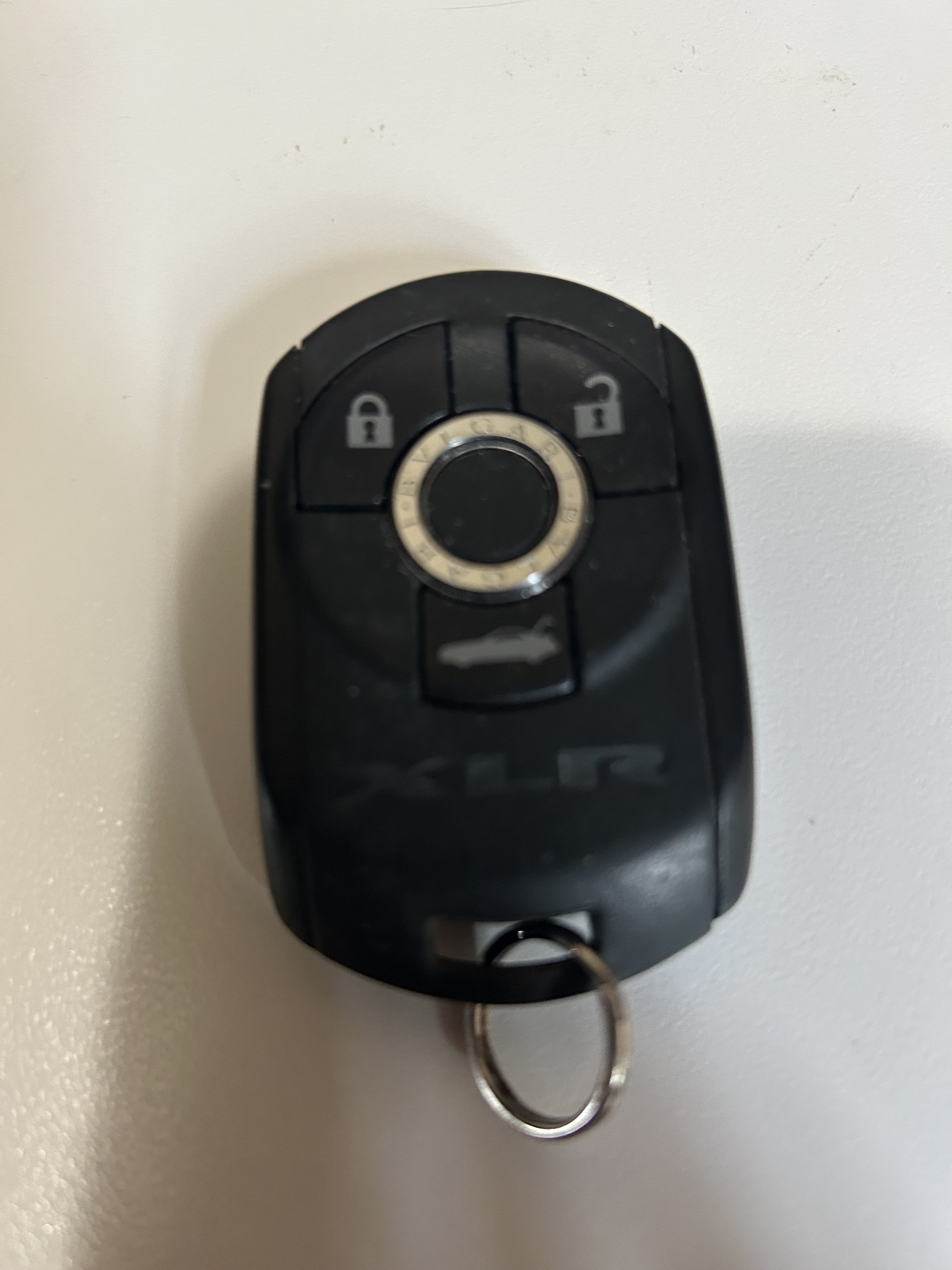

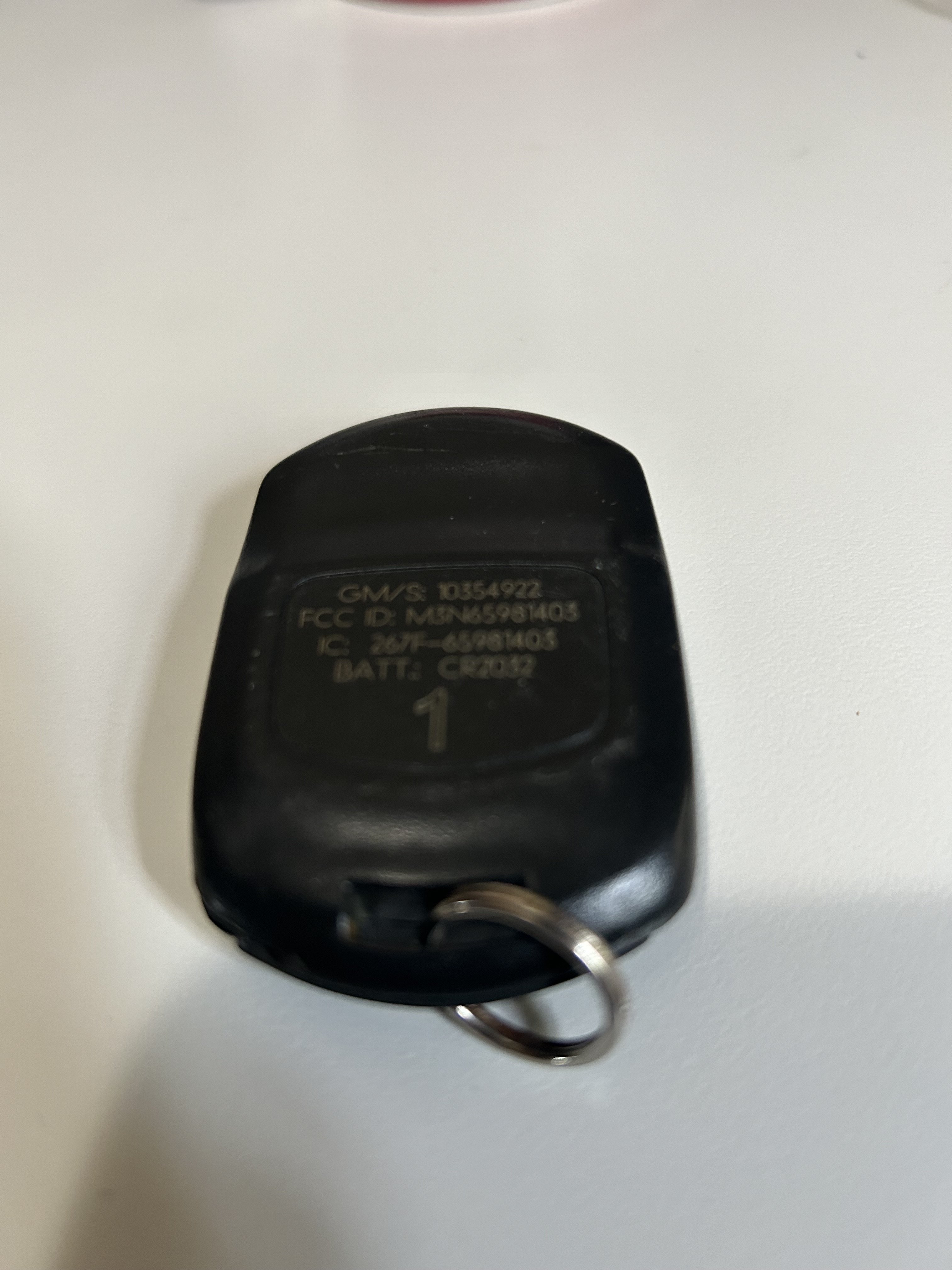

I have a fob that I purchased for my 2004 just as a back up but ended up selling the car before even programming it. Don't know if it will work for you but when I bought it it was for a 2004. I have attached photos $200.. which I paid and it's yours. #10354922
