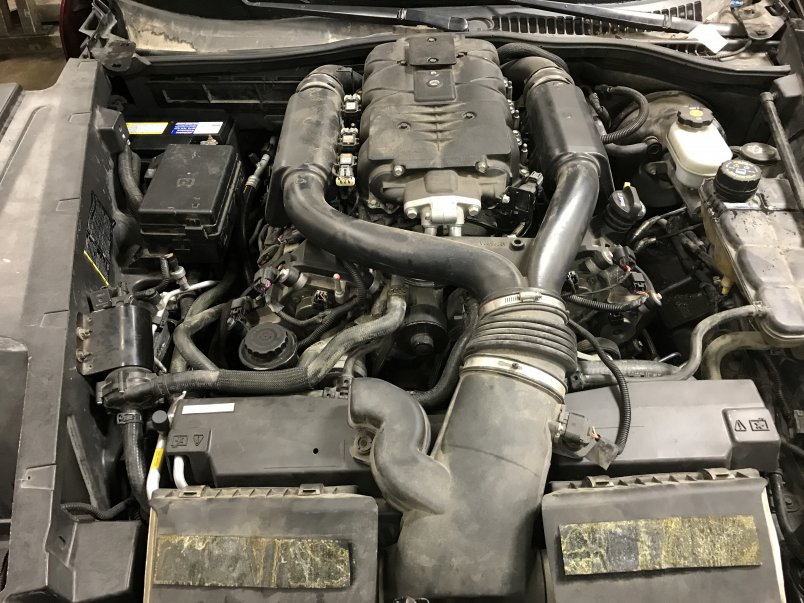

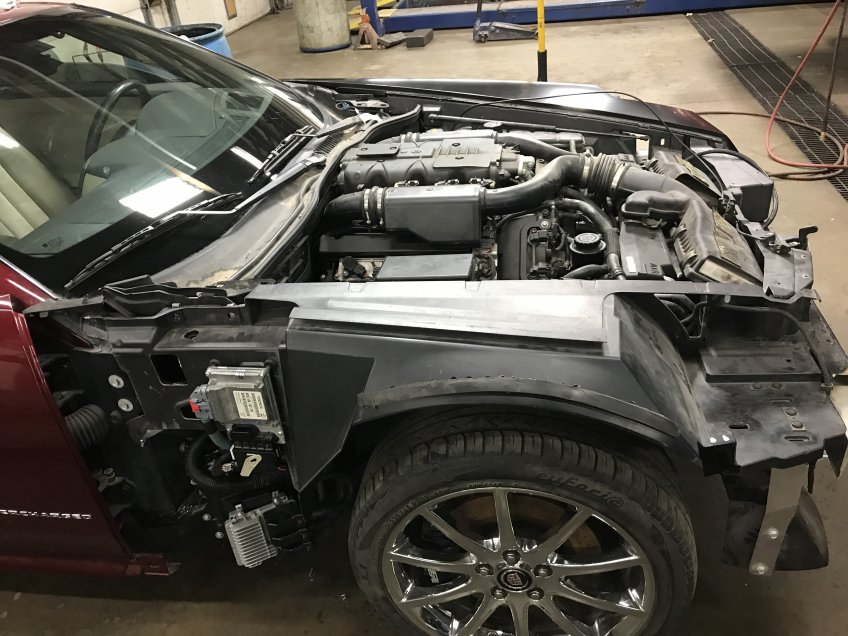

May1,2017 014.jpgMay1,2017 015.jpgMay1,2017 016.jpgAfter almost a year and several thousand dollars the V is running, the frame and wiring have been repaired and it is ready for the body shop. I had to pull the engine, replace the pan, a valve cover, the right front frame rail, repair the wiring to the PCM, Ride control Module and Headlamp control module as well as replace all of the modules that mount on the frame rail and behind the front fender. Also the transmission and engine oil coolers, right exhaust manifold and catalytic converter, battery tray, fenders inner and outer headlamps and front bumper with grille assemblies, an AC line and as a precaution the water pump and belts. I still need the PCM weather shield that no yard seems to want to respond to me for and it is not available new. Re-assemble, paint and tires should do it.
Can't believe it started and ran on 3 year old gas. They should have drained the tanks,
Might replace the engine cover it has a nick out of it on passenger side you really have to look for. Looks like you can still get new so might sell the old one if someone does not care about the minor damage. Just pray the top works after we finish programing all the computers.May1,2017 032.jpg
