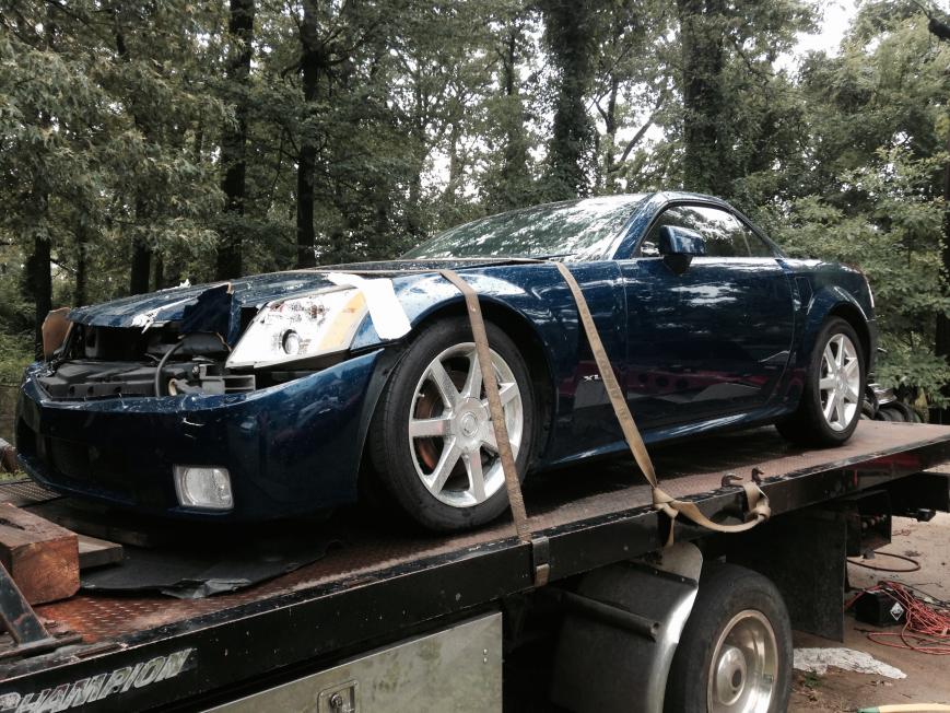

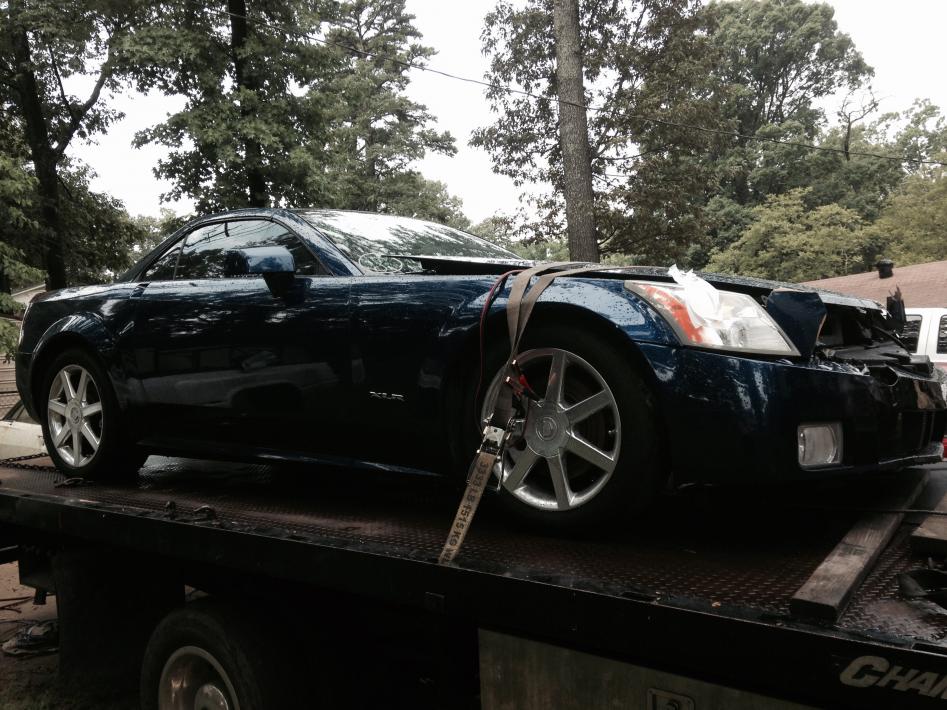

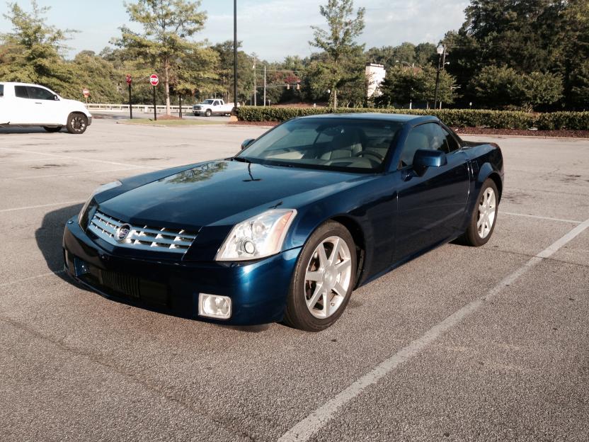

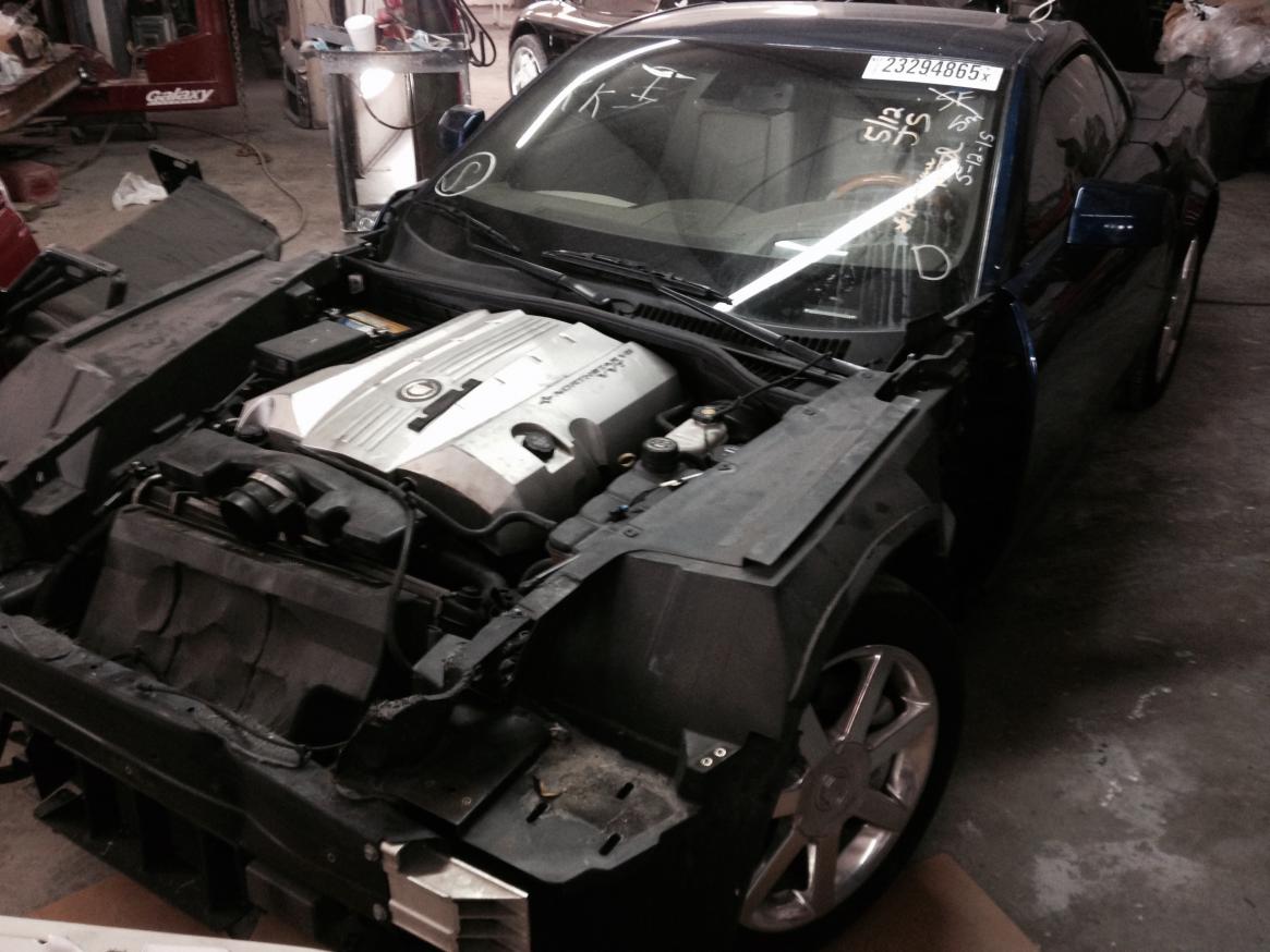

Hello folks! I am completely new to the XLR but not to either the Cadillac or Corvette families. I previously rebuilt an '08 black cherry STS which I loved and prior to that rebuilt a C5 Vette. I have now purchased an '05 Xenon Blue base XLR and working on rebuilding it. Below are some pics when I had it delivered to my shop and some I took Friday once disassembly was started. Finding parts has been a bit more difficult than anticipated, but I am seriously looking forward to enjoying this remarkable automobile.

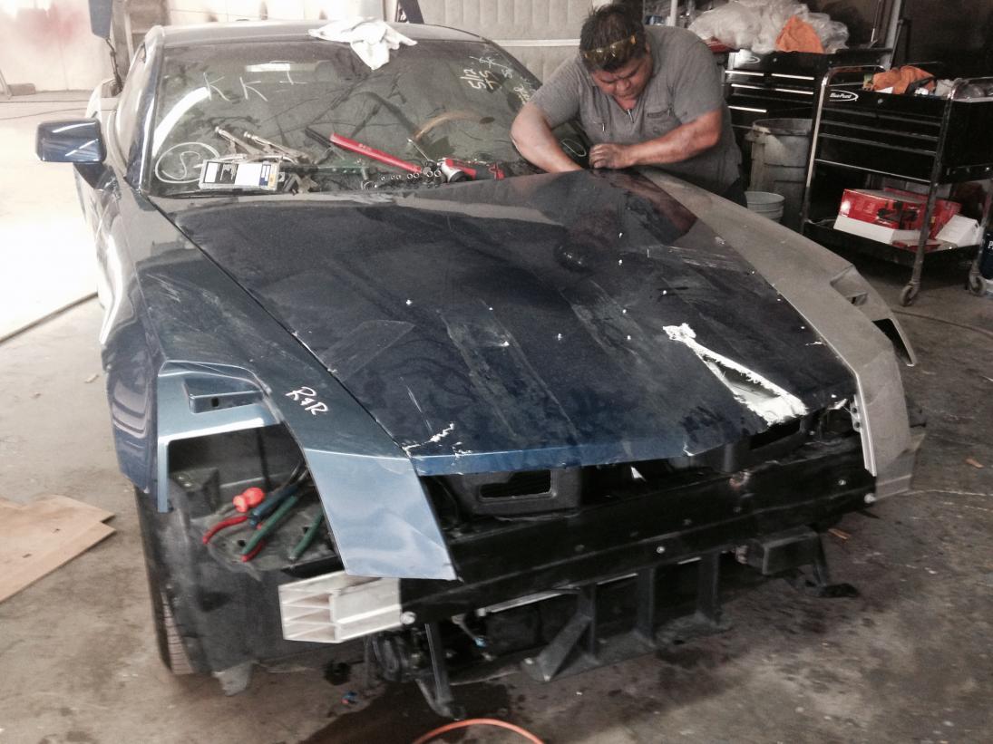

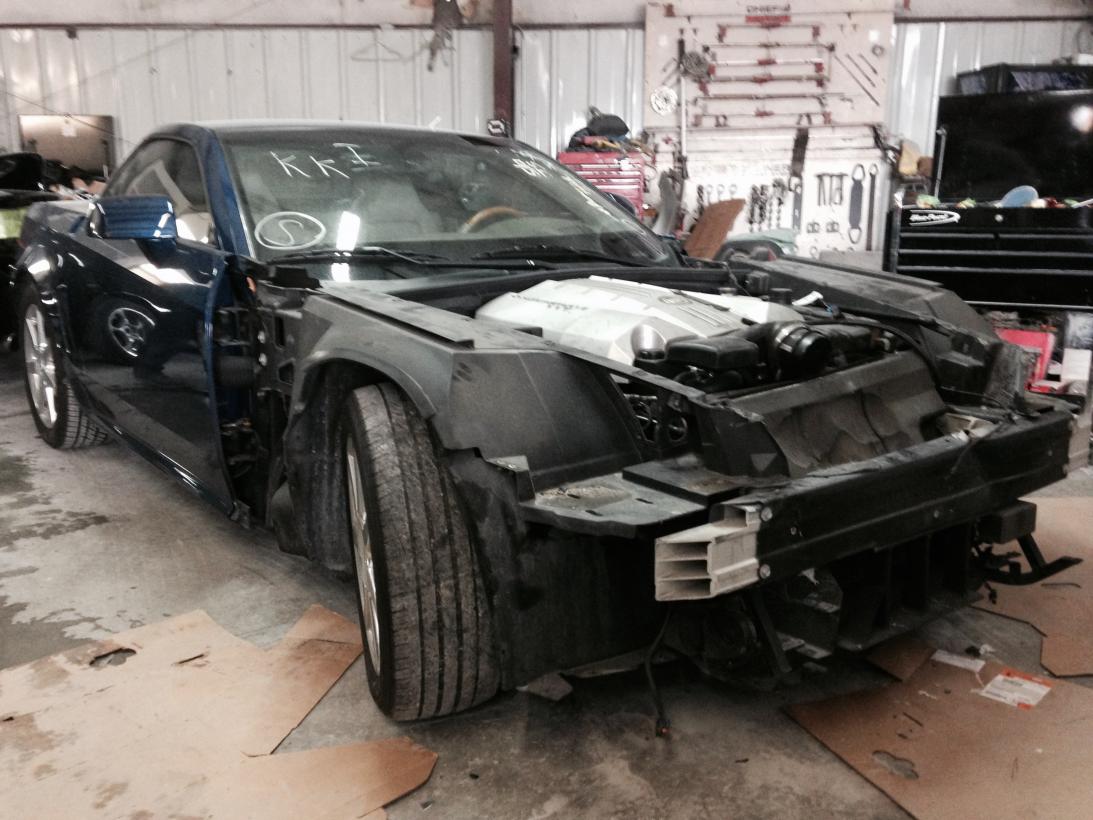

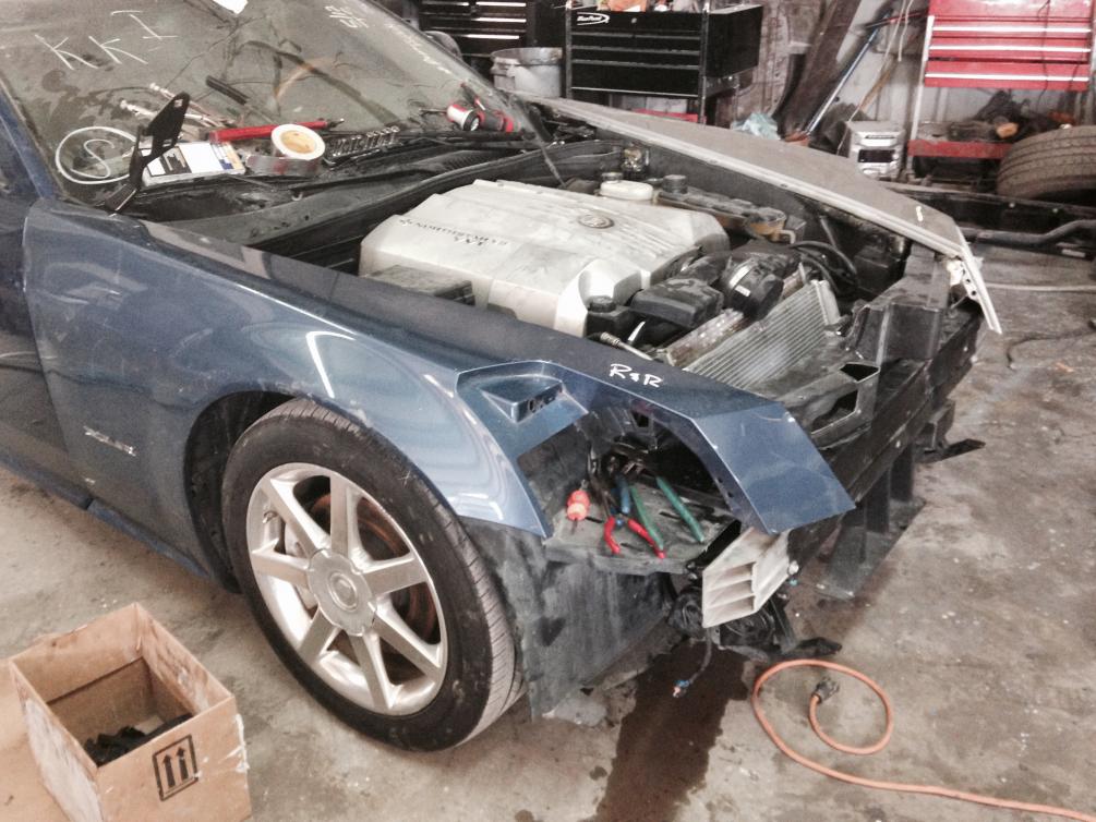

I've made a few mis-steps already and should have done more homework before starting to order parts. In my excitement to get it finished, I purchased a used '05 bumper cover and grill. Once I started reading, I could have purchased an '09 bumper cover, grill, and foglights to have updated the look. Oh well, we live and we learn. I have not been able to locate a hood, so I will be rebuilding this one until I can locate one. I have found some Roderick RW2 18x8 front and 18x9 rear wheels I am considering ordering for her. I think I would prefer the chrome Z06 wheels, but I cannot find the exact offset info I need to order the correct ones as not to experience rubbing issues. I have also ordered a Pioneer AppRadio 4 to replace the existing headunit providing updated voice navigation, true bluetooth integration and ODBii DashCommander functionality.
Hopefully this week I will be able to post some additional pics as she nears completion and will be driving her by next weekend.
Good luck with your build, damage doesn't look real bad and you've obviously done this before so it should come out fine. As far as your wheels, the offset on the stock rims is 61mm. You may have an issue changing out the head unit, the cruise control runs through the current system. Again, good luck and let us know how everything goes. Hope this info helps.
Good luck with rebuild. Hope you are going to keep the same color. Kinda partial to it. There is a member in Montana that used to own a body shop and rebuilt his XLR. He may have some insight as to locating body parts. If you decide to keep it when done we would like to see you join us in some future events.
Oh she will definitely stay this color...it is beautiful on this car and yours is gorgeous I too used to own a bodyshop and my old guys still do all my work for me. I am awaiting the bumper cover to arrive via Greyhound from CA and I will have all the pieces to get her test fitted, parts painted, and re-assembled by weekend...hopefully.

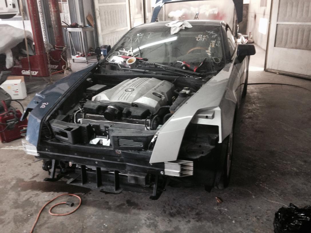

New build pics....
She is coming along. Parts should be in the paint booth tomorrow. The guys were test fitting the hood and adjusting the new hinges so everything lined up correctly. Still some work to do on finishing the top the hood, but that was supposed to be wrapped up this afternoon.

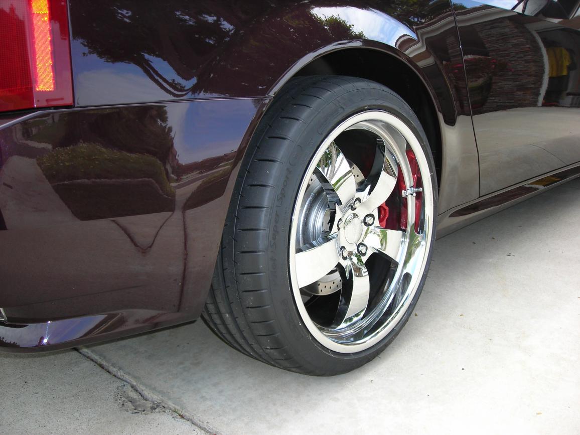

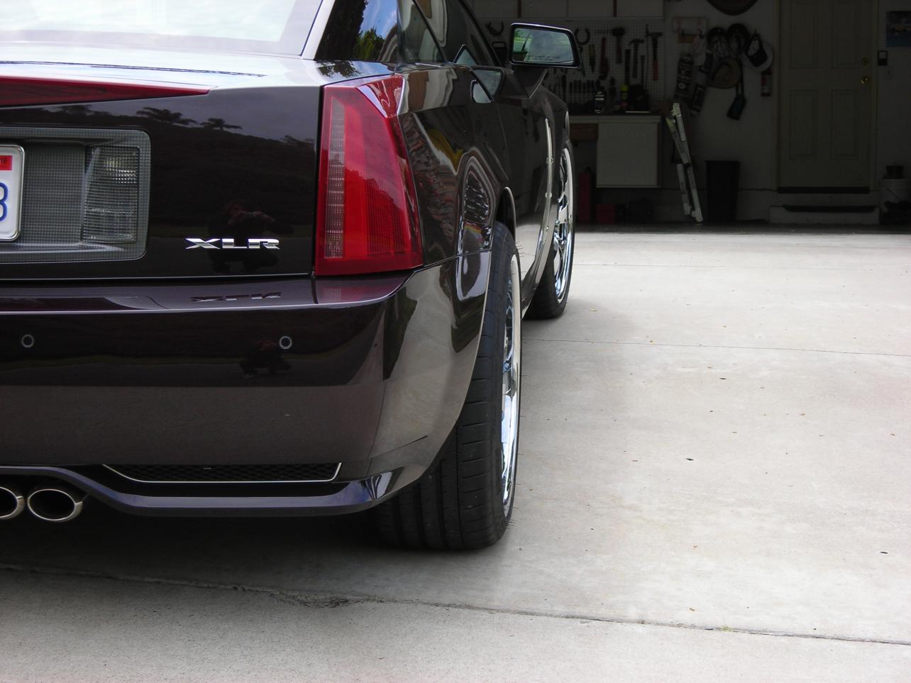

I had a hell of a time getting wheels with a lip for my XLR, short of going to a custom 3 piece design (big bucks). Our cars, like the corvettes, have "high offset" rims and you don't dare go with anything less than 50 mm - especially with a 10" wide rim (max for our cars). Anything less than that will have fender rub potential.
Based on the photos I saw for that brand, it looks more like a 35 mm offset. That does not sound like much (15 mm = 0.6"), it will stick out past the rear fender, if you go with 10" rims.
Here are some photos of 50 mm offset (20") rims with tires - American Racing brand (no longer made in this model)
2" lip on rears, for reference (10" wide) - 1" lip on fronts (8.5" wide) - both 50 mm offset.
Hope this helps with your search. :wave:

Those are nice looking wheels, similar to Cray brand, only cheaper. You should be OK with a 9" wide rim, just watch the tire width - 275's may rub, depending on the actual tire brand you select. I would call the number listed on the eBay listing, just to know what the offset is - it just says "custom" in the listing.
As far as the Z06 wheels - depending on the year, they are probably more than 10" wide. We can't do that because of the inner fender - ours are narrow to accommodate the folding top.

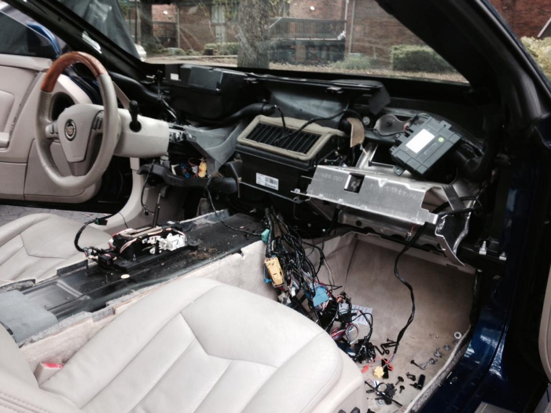

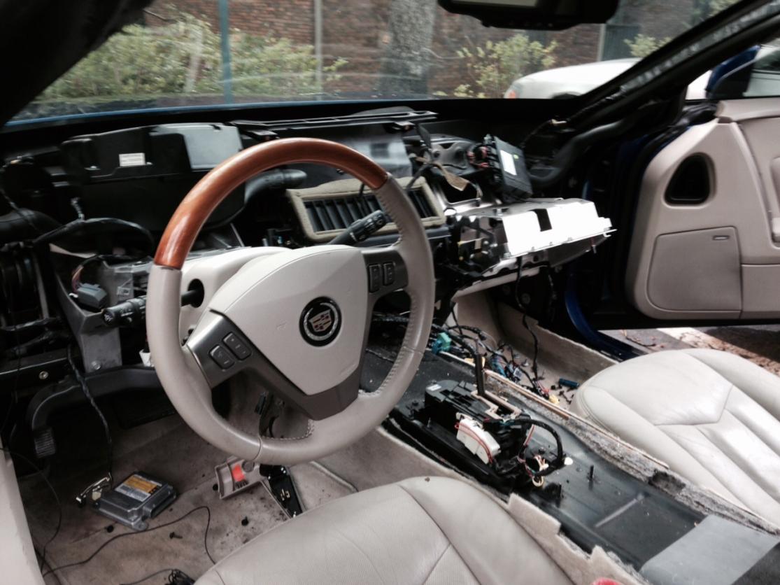

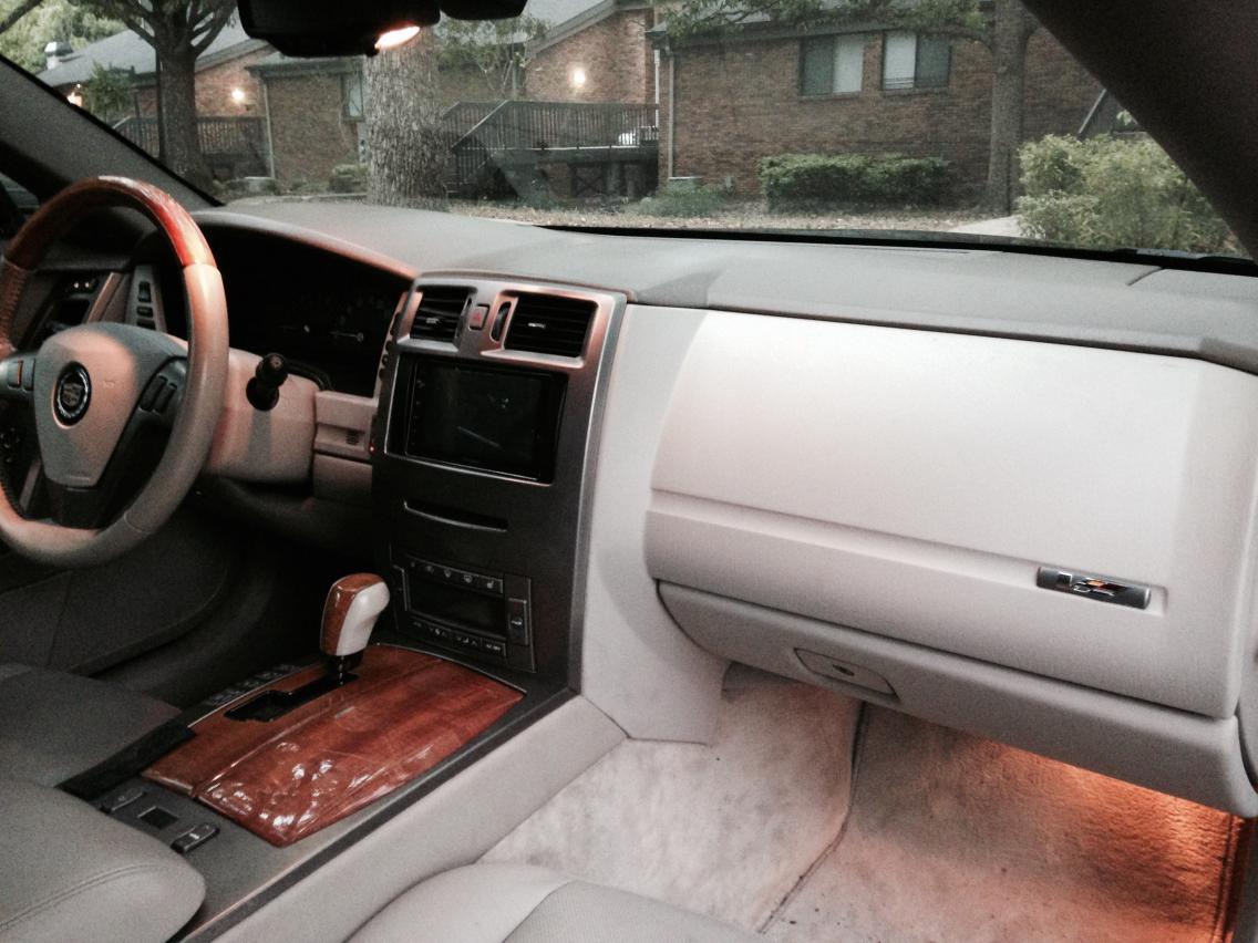

So...has anyone wondered what it would be like to replace the dash in an XLR?
I don't recommend it, but if you have any questions about how to do so...just ask me. :rolleyes:
But...totally worth it...
