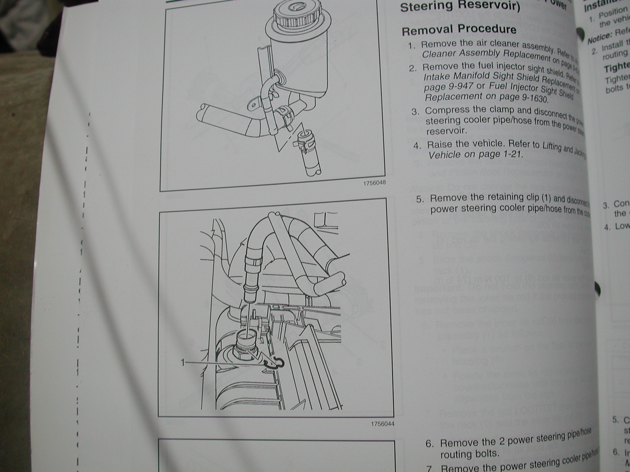

ok just to be clear. The xlr with two coolers in the radiator has one for the transmission and one for the power steering .Only the V has an engine oil cooler and it is external in front of the radiator just like the z06. Half of the china radiators listed dont know the differnce and list it as engine cooler. No big deal but just to be accurate. I dont believe it has an engine oil cooler in the raditor. At least my 08 does not . The 04 and some 05 only had a transmission cooler and thats the cheap ones people buy and find out they dont work. You can add an external power steering cooler to an 04 for about 100$. Yours may be unique as I am not looking at it but people have been confused about this before .Many listings say trans and oil cooler so as long as it lists two coolers you are alright . but if you need a hose you need to know what it is. Follow where your hoses go and see where they go. Factory manual shows power steering cooler on the drivers side in photo.
for what? To tell them your XLR does not have an engine oil cooler in the radiator But a transmission and power steering cooler. Its no big deal. Just follow the lines on your car and you will see that one side goes to the power steering canister and the others go to the transmission in the rear of the car .Call it oil or fluid its not an engine oil cooler in the radiator. Their listing is for the corvette and some year out of the ones listed may have used the cooler as an engine oil cooler The XLR does not. I have changed a dozen of these radiators and you have to top off the power steering when you are doen or it can burn out the pump. As I said you may have a very special one of a kind xlr with an engine oil cooler I doubt it. Look at the photo above .line 5 remove power steering cooler line from radiator.
