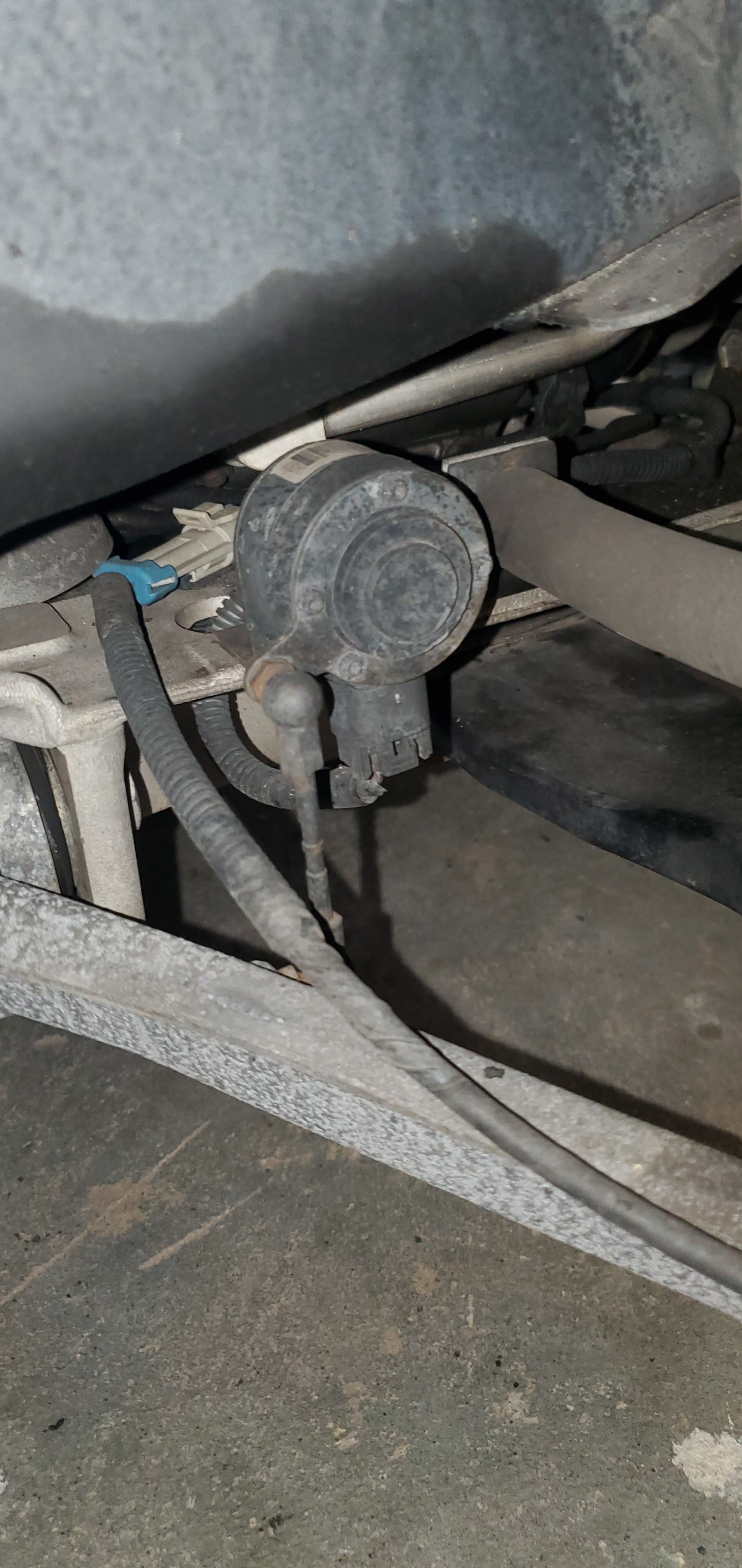

When i dothem i completely remove the ride height modules. It ckeans up the clutter and loses 2 pounds. Haha. You do need the sims on the shock wires and the ride height plug. The rear plugs plug in but do not lock together. It requires a zrp tie around the two plugs to hold them firmly connected.i say that the problem. You do still need a good suspension module and the 06-09 rarely fail but do. The bikstein b8 are for lowered cars and have less travel and tge actual damper part is different and works in a different ride height location.. Though this does not affect the module it will not be a comfortable ride unless you have the car lowered 1-2 inches which will bottom out the adjuster on the keaf springs. B6 are a better choice for just replaceing the mag shocks but ive changed out a couple xets to replace with the z06 upgrade and customers like the firmer but not jaw breaking ride. If you are lowered and running nonrun flat tires , im not sure youwill like the b8. Maybe if you autocross

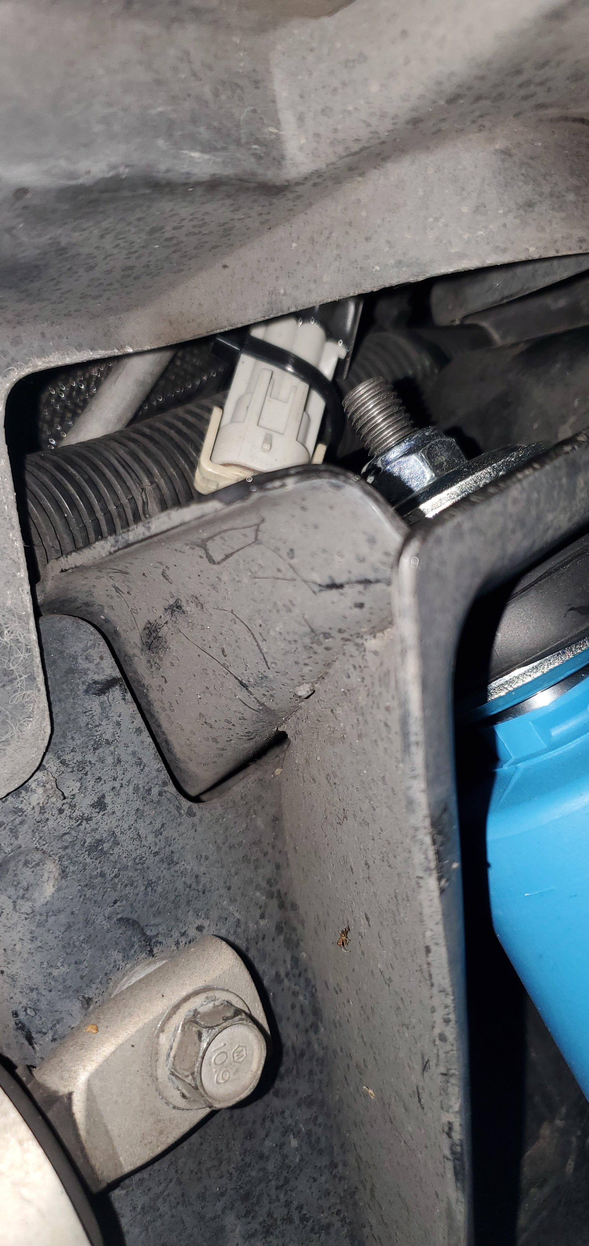

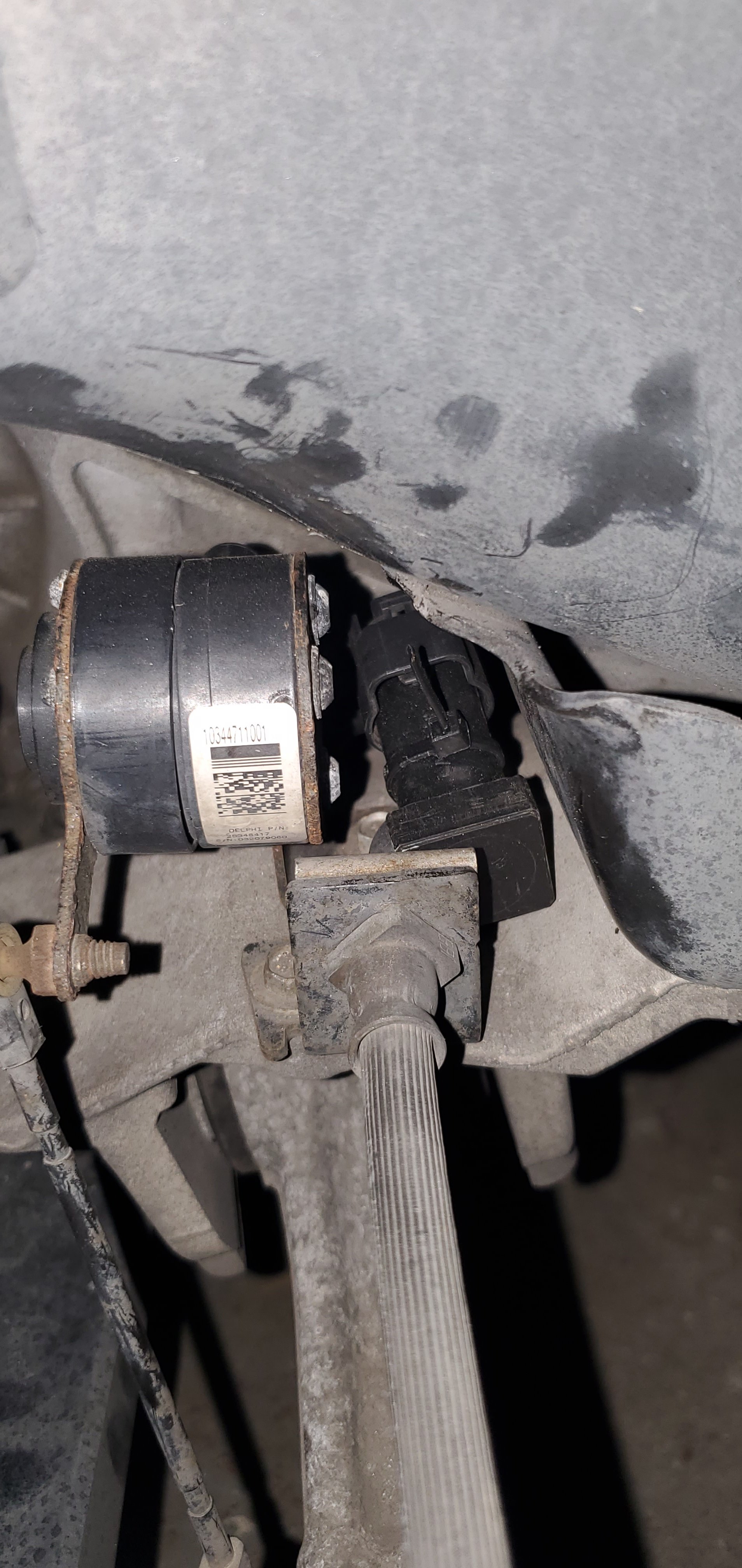

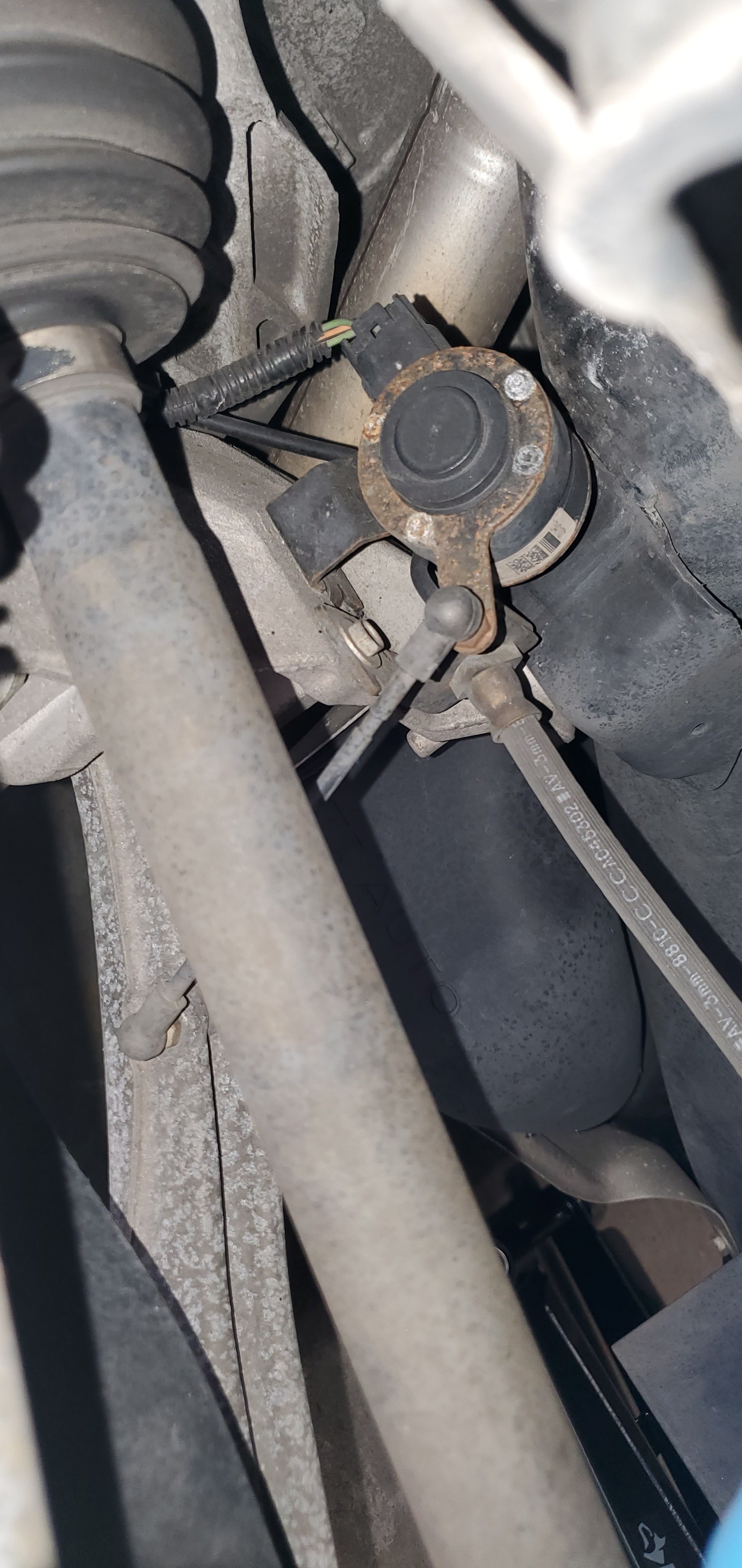

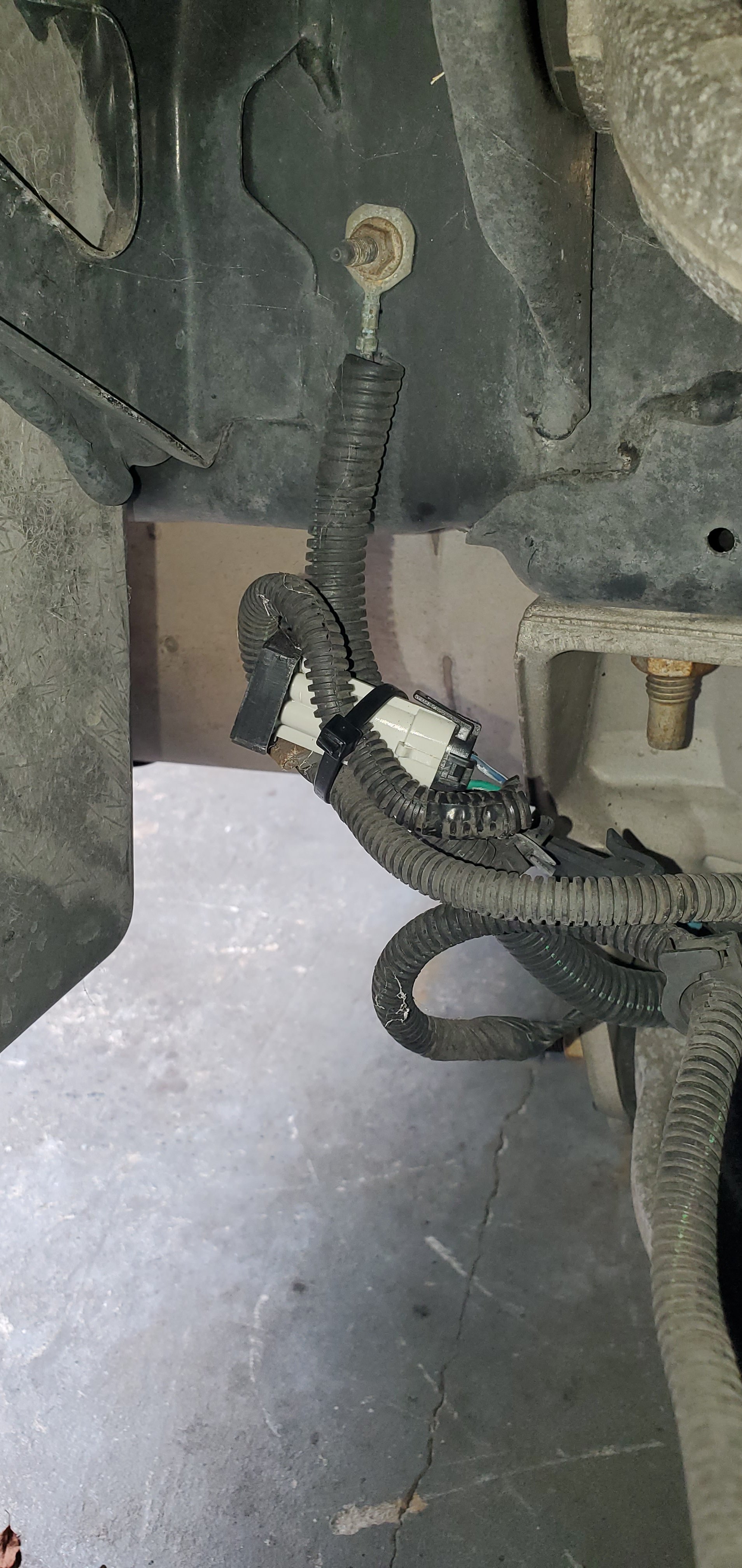

First two pics show the white simulators that go to the wire from the top of the shock. Rear wheel location is kinda hanging, front is tucked in above the new strut. Next two pics are of the ride height sensors "without" the black simulators. Pics are from last week. Black sims installed today... But no change in messages yet.

mickeytee, you are always saying the rear sims need to be ziptied. do you mean two white and two black, rear drivers and rear passenger sims, or one in each wheel well? each wheel has a shock sim (white) and a ride height sim (black) casper instructions talk about the gray(white) shock sims needing to be zip tied. are you calling those the rears? that would mean one at each wheel, the shock sim.

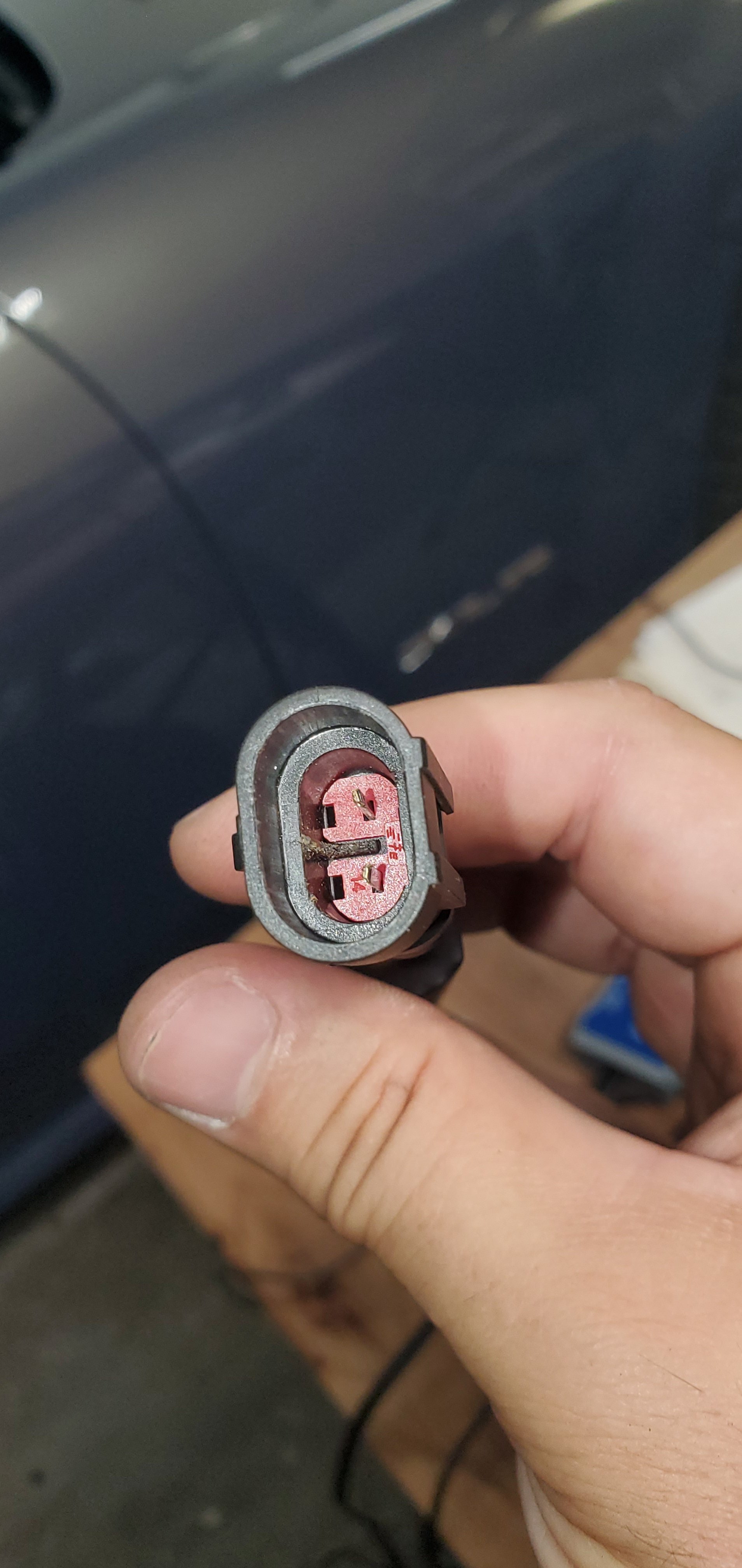

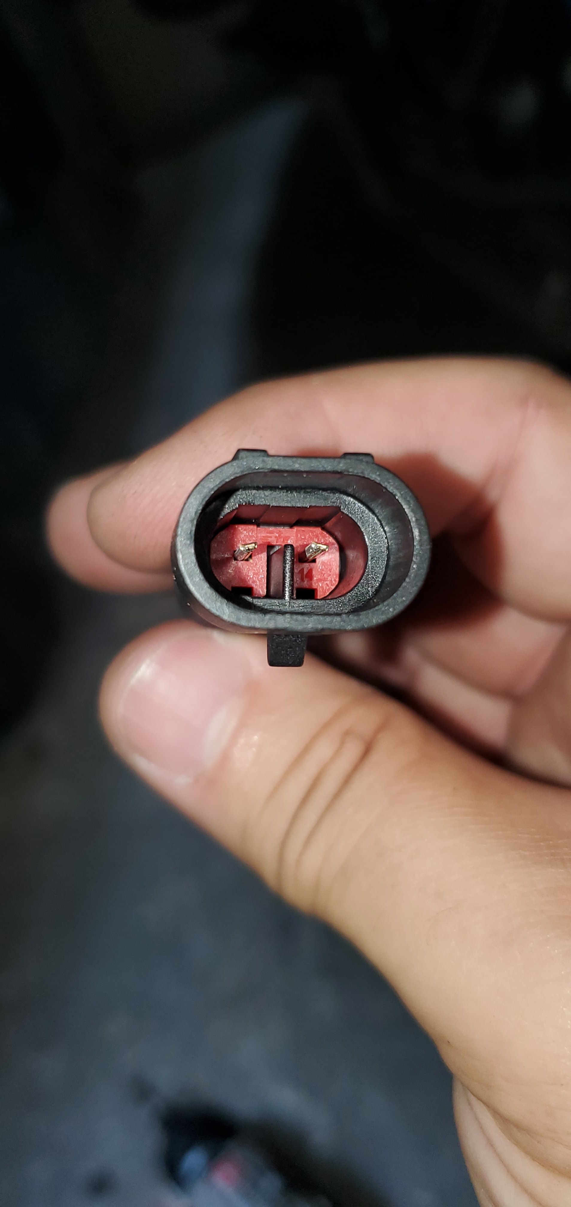

Update, after getting a Chinese tech 2 to scan codes and check the suspension system, found that 3 of the 4 Casper resistors for the struts were fried. That happened when they only installed those 4, and not the ride height sensor resistors. (Original shop did that) We saw with the tech2 while driving, zero change in the 3 locations for voltage % reading for the struts, while one was modulating from 0 to 30%. The dead strut readings were the ones throwing the codes. The 4 ride height sensors were reading a steady 2.24 v, and no codes. Caspers was great and mailed me a new set of 4 gray resistors.
Moral of the story is install all 8 at the same time!! I used electrical tape to secure every resistor to its plug, the 4 gray plugs(for the struts) definitely need it as they don't snap in, the 4 black plugs snap in, but I did it anyway.
I redid the zip ties at all 8 locations to make sure they were safely tucked away from moving suspension parts. I can see how the strut resistors might need a bigger voltage capacity... If they burn out again, I'll order a different style on eBay and splice them in myself. The strut resistor has to absorb the voltage that the module is sending that would have adjusted the mag ride viscosity. I'm sure that wasn't a low voltage. The ride height resistors are just sending a signal to the module, so are very unlikely to fail.
Interesting. Ive got maybe 30 sets installed and never had a failure. i do install all 8 We used to just solder in the resister direct but liked the plug ins as one day you might want to go back to mag ride should the price drop. Id say your problem is in the grounds .next ime you are there remove the ground on the frame on all four corners and remove and clean them.

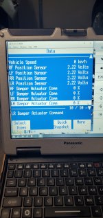

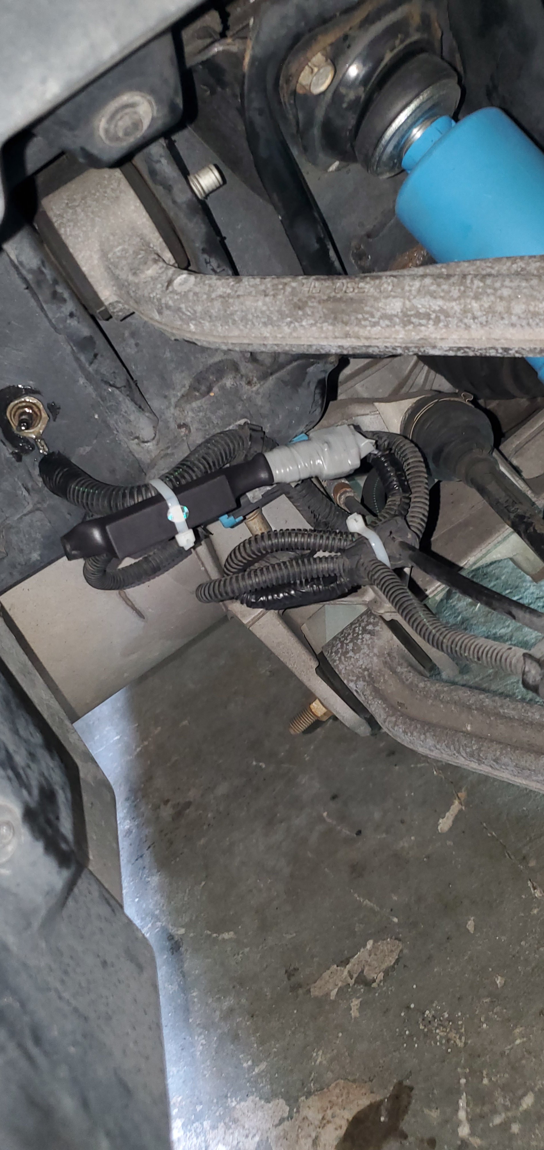

Latest update. Casper's strut resistors kept failing. I assume they can't take the load being sent by the still active suspension module. Looking around and asking around, came to the conclusion I need 50 to 100watt resistors, ideally 1 to 3 ohms but ohms not that important, only that lower ohms generate less heat. Found this kit on Amazon and ordered them. Easy install. You can see the resistors are much bigger, the size of your pinky, the Casper's were tiny like the size of a grain of rice embedded in epoxy and couldn't dissipate heat. Fronts went on perfectly, had to make Minor modification of the plug so it would fit on the rear pigtail. See the pics. This kit got rid of my service suspension and 80mph limit warnings. Finally after 3 months of fighting with this. Oh yeah I left my ride height resistors on from Casper's, they were fine. I burned up 6 total strut resistors. Lol
Pic of the new big resistor installed, plug how it fit on the fronts, and how I had to clip out the plastic for the rears, pic of my old Casper's on the ride height sensor, and a fun pic of my tech2 clone readings.
