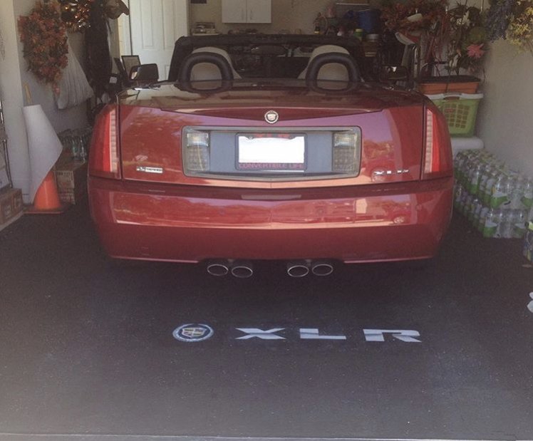

32F25DE0-B6F3-4818-BB1F-707AC5A784AB.jpgIdk if you saw this but when my mom and I went away on a 115 day cruise around the world I spent some extra money and put this floor down. So before leaving I went down to my dealership and had then top up the fluids and tire pressure. Then I went and filled the gas tank up. Put fuel stabilizer in the tank parked the car in the garage and left the drivers window down. Then opened the hood attached battery tender and shut the hood but not all the way. Only shut it so I can still open it with the latch. When I returned in April unhooked battery tender and she started right up. Drove the car for a good 30 min or so and then parked her back in the garage.
