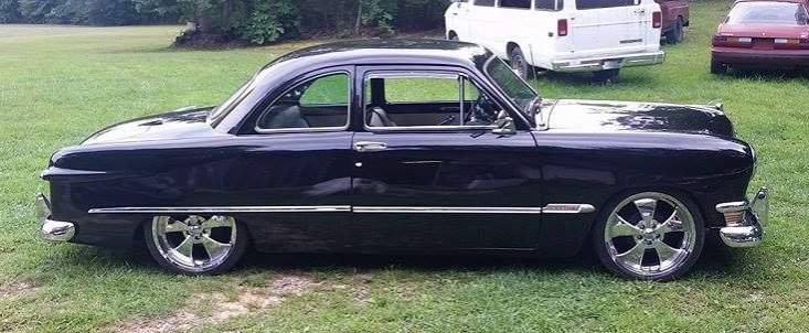

50on20s.jpg this is my ride tonight due to the caddy being unhelpful in fixing itself... if anything goes wrong electrically on this one I can trace all 3 wires..
'49 or '50?
View attachment 5745 this is my ride tonight due to the caddy being unhelpful in fixing itself... if anything goes wrong electrically on this one I can trace all 3 wires..
AWESOME LOOKING RIDE! Glad you have a sense of humor AND a back-up!! JUST REMEMBER - RED IS GROUND ON THE BATTERY!!!! (if it still has the flathead):thumbsup
oh yeah - consider some lake pipes on it!!
Love it......... also my style of an awesome ride!

Phil105 Wow that Ford club coupe is fabulous so beautiful [emoji106][emoji7][emoji106]

LOLOL thanks for all the comments and Help.. and the Biggest issue I have is i am a GM man... The Club Coupe is SBC powered.. and I got my girlfriend out of her Ford (shes from a Ford family) into the XLR.. and it has so much tested my faith in GM with this whole ordeal.. I hope I can get some time under the hood of her today and see what I can make happen..
