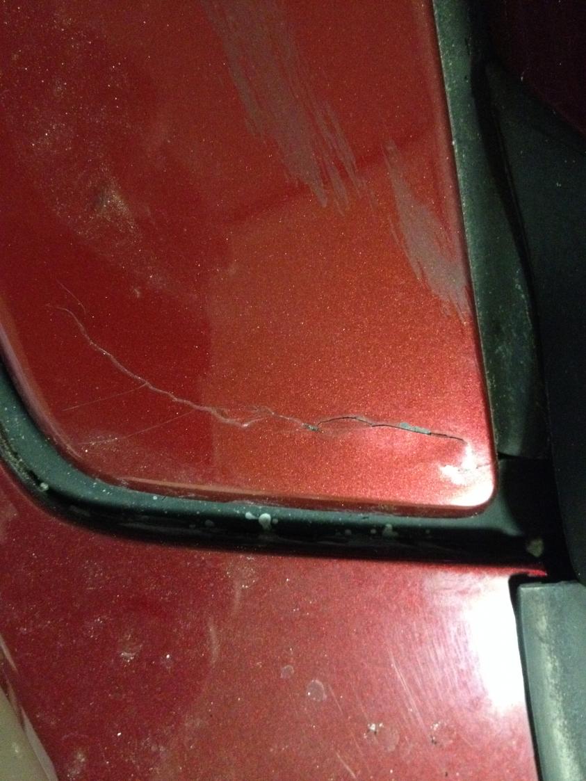

Just took another look at that picture, passenger side at the very front of the trunk lid. Seems very unusual place for that to happen.

The split in the paint is at the passenger side trunk lid just below the quarter window where the trunk lid lays on the body. It may have been an obstruction that over flexed that point and caused the split. It will be repaired Monday.

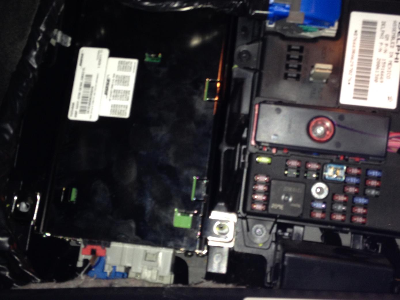

Help with the amplifier
Thanks Tim.
When I finally have all the issues taken care I will give a full run down with details.
The local dealer said the amplifier is bad and the estimate he gave me at the time was very high - So I thought. The dealer price on that amp is very high at $785. Has anyone replaced one on an 07?
Where is it?
Any help is appreciated. I could not find anything in the forum or on YouTube that was helpful.
We have sound!
The replacement amplifier showed up today and I just had to install it so I could put my mind at ease.
That Bose amplifier was the problem, I had no sound from any speaker and a faint clicking noise coming from the door speakers.

The dealer agreed to only repair the cracked trunk lid at $810.00 saying they missed that, and after I informed them I wanted to exercise the money back guarantee for their misrepresentation. They told me that they would take the car back but the dealer’s fees were not refundable. The dealer fee as indicated on the listing says $199.00 but when they write up the buyers contract they adjust the selling price to reflect a $595.00 dealer fee, a $20.00 electronic filing fee (nothing was filed electronically) and $1.50 battery fee (YES, a battery fee for the dead battery they sent me) So at this point I would lose the $616.50 plus the cost to transport the car both ways.

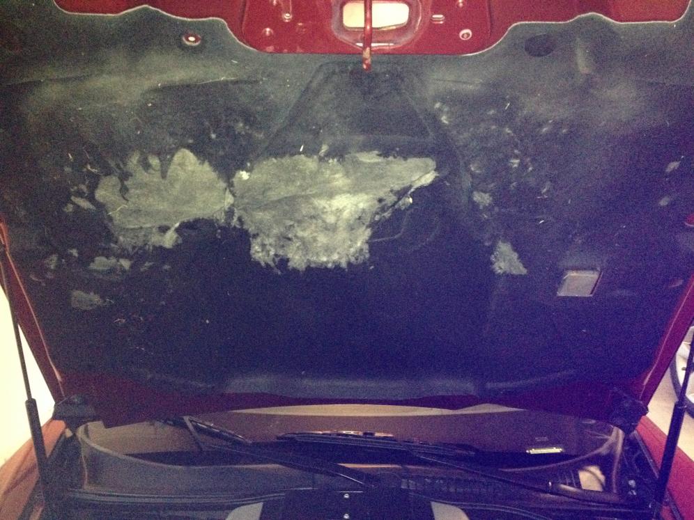

Hood insulation was in bad shape (see picture below) – I replaced the hood insulation and the missing retainers.

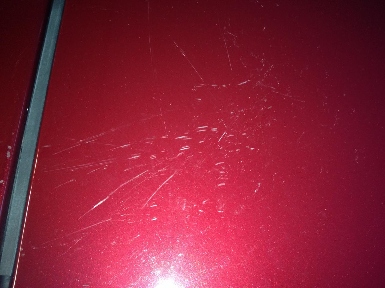

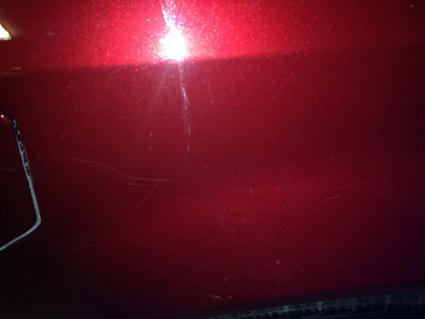

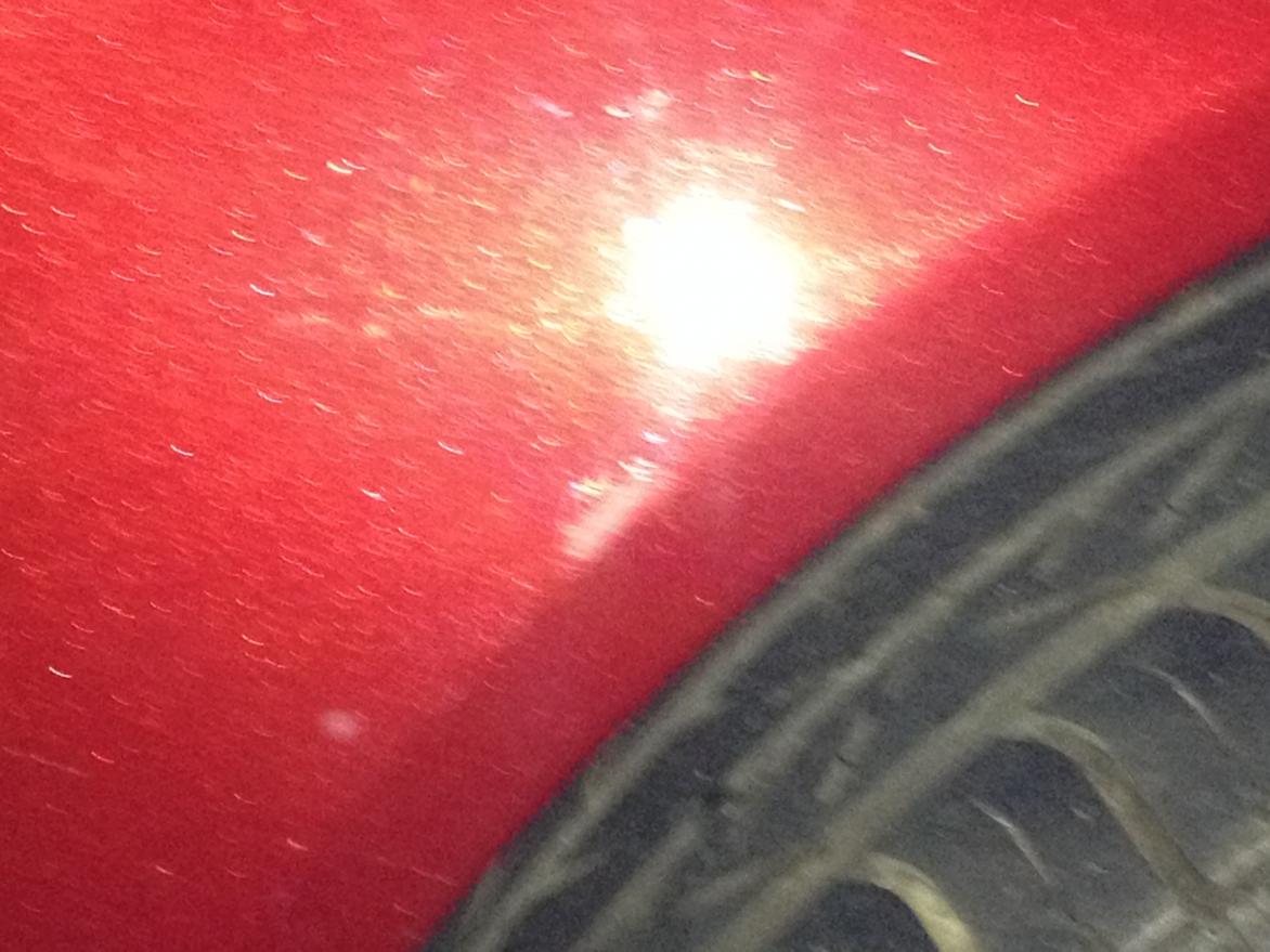

Four deep scratches required paint
Two rub marks required paint also – I paid the body shop to fix these when they repaired the trunk.

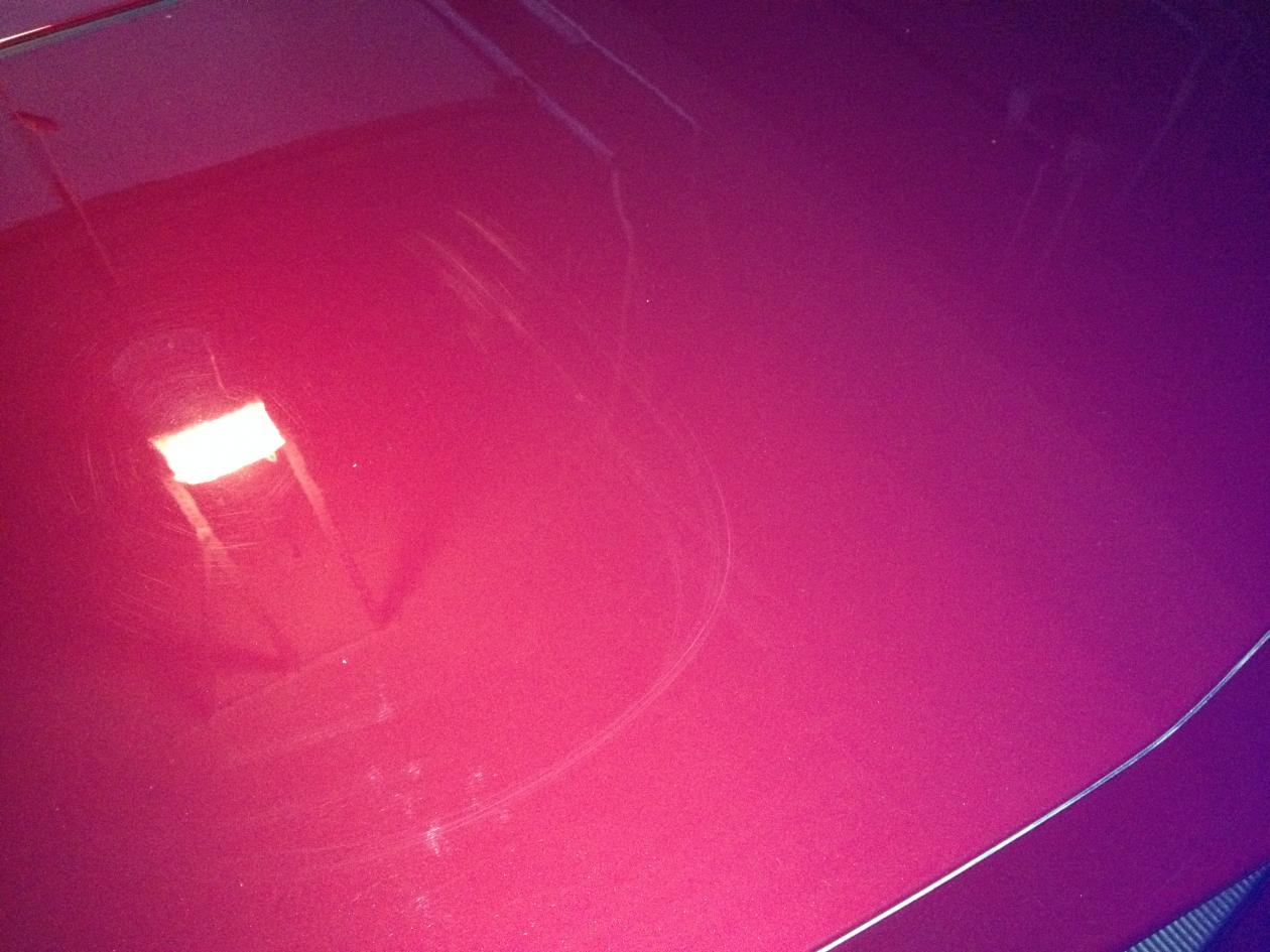

Multiple swirls were also buffed out by the body shop. – Yes I paid for these too.

Just a few pics of the problems with my perfect 10
