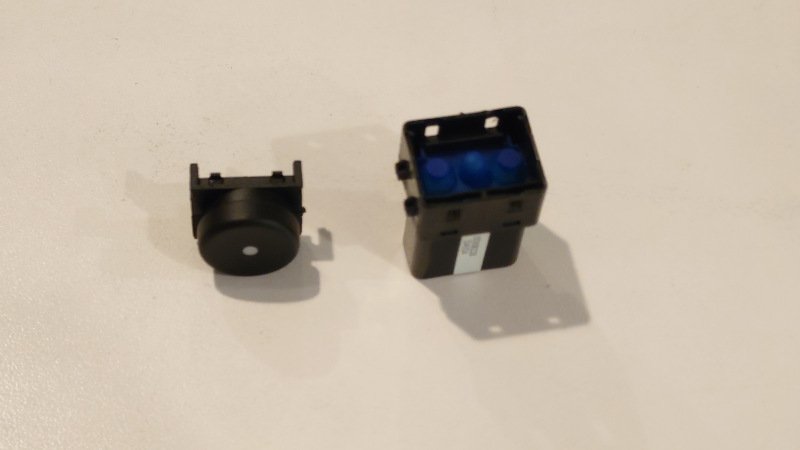

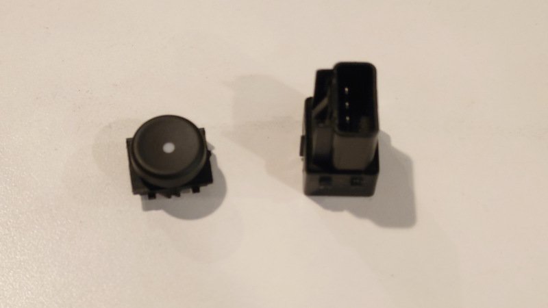

To my dismay... it was indeed the inside door release button! I'm a bit dumbfounded by the design here. It seems like the car has two separate circuits that go through the switch: one to lower the window an inch, and a second circuit to release the door latch! So, it may very well be... one circuit inside the switch can go bad and leave the other circuit intact. My switch would lower the window, but not release the door.
As in this post, you can buy the inside door release switch for the corvette, and easily replace the button with the XLR button: https://a.co/d/0cQ906WU
Also, I forgot to order the door panel retainer pins / clips. You will very likely break at least one: https://a.co/d/02FjHzmE
