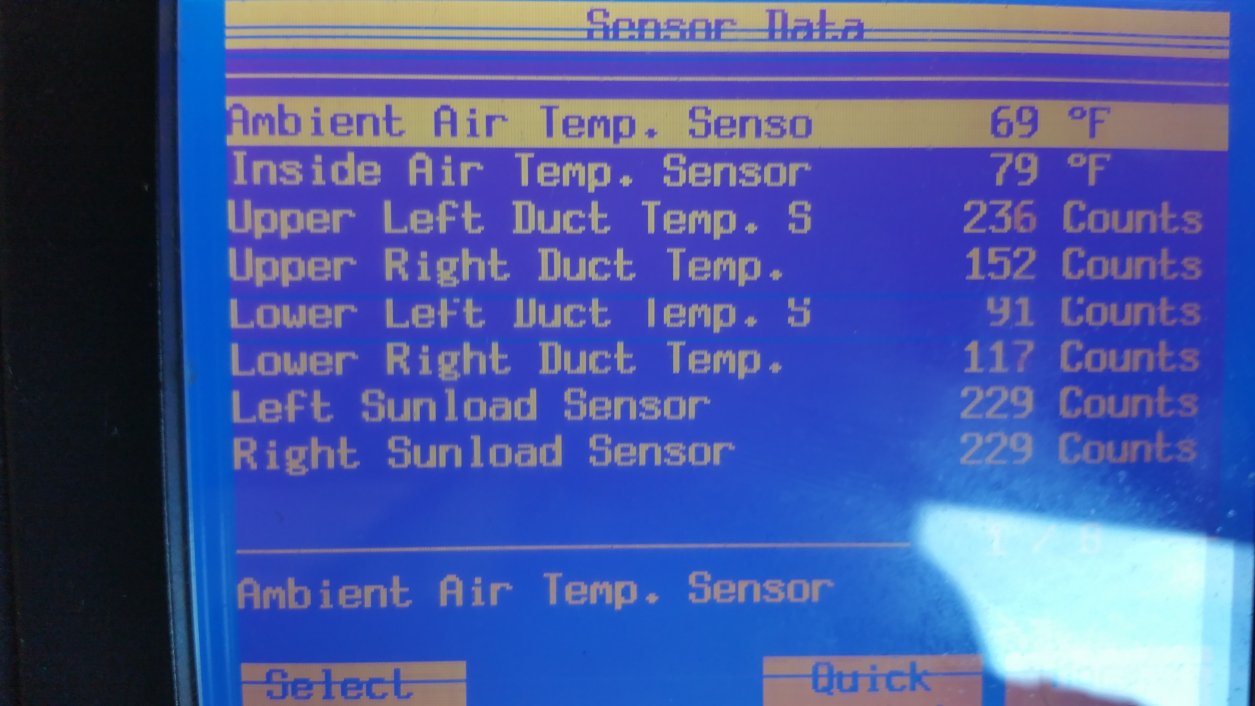

I took the car to a dealer and they told me the AC needs recharging. I asked if they tested the sensors and they said they tested it? With much skepticism I allowed them to recharge the system. It seemed to work that day but the next time we drove it, back to hot driver and cold passenger.
I was able to take to a friend that is a Jaguar mechanic but has a TECH 2 for his SUV.
Test Results;
Ambient Air Temp. Sensor 69 F
Inside Air Temp. Sensor 79 F
Upper Left Duct Temp. S 236 Counts
Upper Right Duct Temp. 152 Counts
Lower Left Duck Temp. S 91 Counts
Lower Right Duct Temp. 117 Counts
Left Sunload Sensor 229 Counts
Right Sunload Sensor 229 Counts
We were not sure how to interpret the data but my guess is Lower Left sensor needs replacing?
Can you make sense out of this data?
