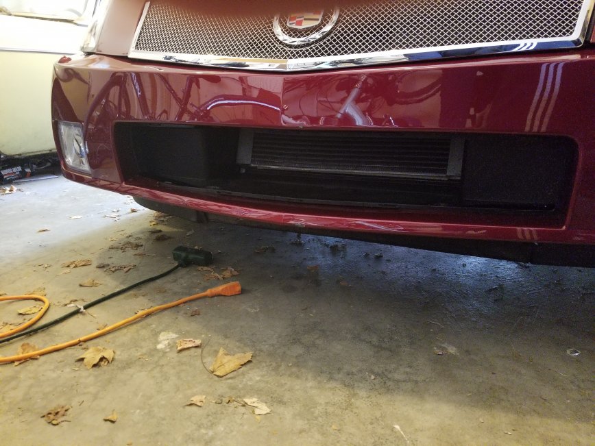

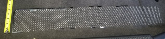

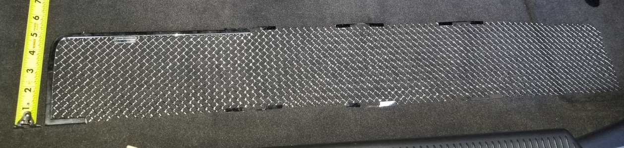

My '06 XLR-V had a mishap at some point that knocked out the lower grille. The mesh portion was in the trunk when I bought it (seller was very upfront about it), but it looks like the plastic chrome border has only a small portion left (pics below).
My original plan was to get a replacement OEM XLR-V mesh lower grille, but those appear to be pretty much non-existent. Before going to an aftermarket lower grille I want to give salvaging the original mesh at try.
My plan is to make a replacement chrome border with Cowles flexible chrome trim, which should pass from a distance. My issue is what to use to fasten the grille back on the bumper.

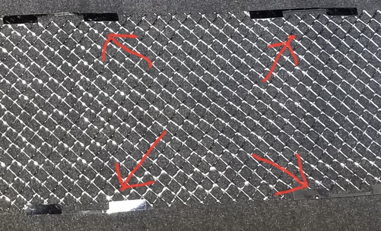

It looks like there are corresponding flat, rectangular slots on the grille (red arrows in pic) and bumper for some type of clip to snap into, but I can't for the life of me find the right part. Some of the other clips/fasteners I've seen look like they might work (or a really small zip tie if I get desperate), but if someone knows what the OEM clip is, I'd like to stick with that if I can.

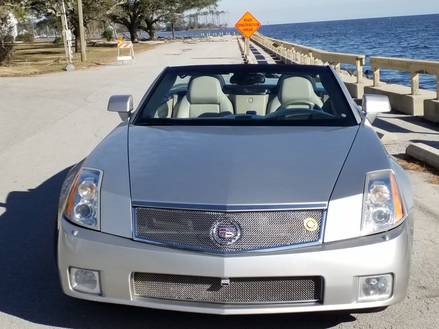

I had my EXCELLENT body shop body owner remove and repaint my front bumper face, so while it was there he installed it. It's actually 2 pieces; the main grill and the small lower one, and it makes the car POP!!! It really adds to the overall looks!!!I'm very glad that I did it, that factory grill is so lack luster; What were they thinking when they came up with that piece of junk on a $100,000.0 car???? CRAZY!!!
