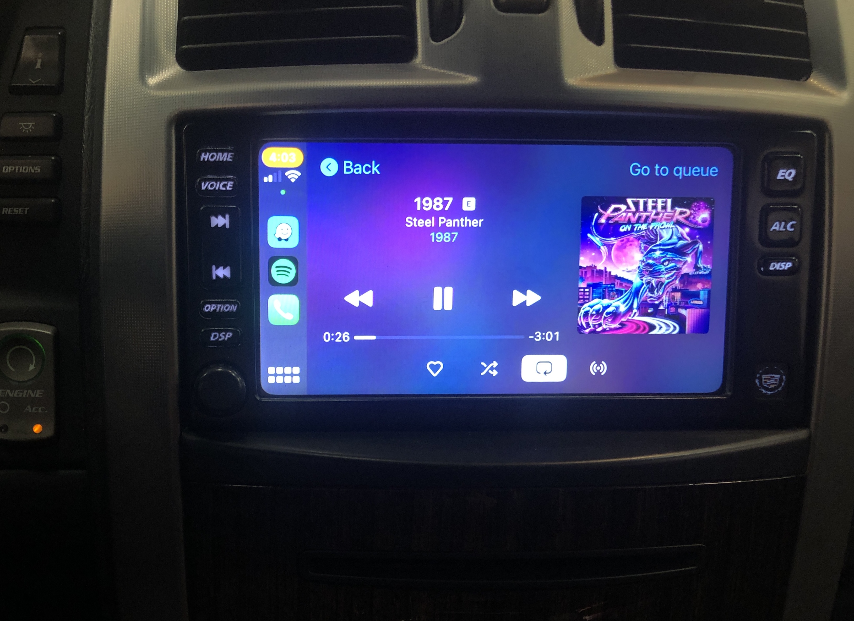

something like this?
(and no, it isn't available)

Yes something like that what head unit is that (kenwood,)
It is a Sony XAV-AX7000. I machined the new faceplate and buttons and built circuits to tie into its stock buttons plus IR functions and interact with the Bose amp. It took about three years off and on, but it is totally a one-off. I know it was off-topic, but when you said why can’t someone make something that fits, I couldn’t resist! The display in the lower right shows the outside temperature when the engine is running.
I admire your skill!
