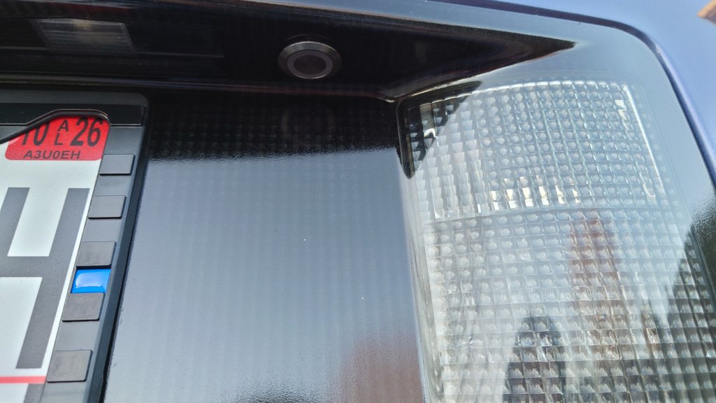

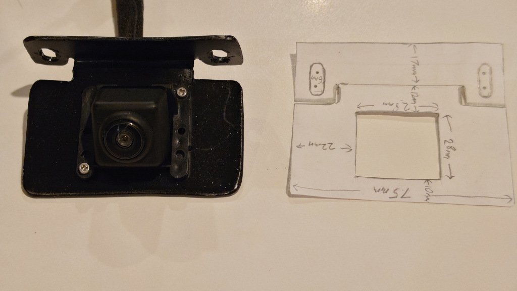

I'm nearly done with my backup camera install, and thought I'd post some pics. It took a bit to figure out where to mount a camera to look like factory and be in the center.
I decided to put it where the existing trunk open switch is and move the open switch to the right. This is better for me, since I'm right handed and tend to feel for it on the right side anyway.
The camera is a used C7 camera... 2016, I think. It was the right price, good angle, and the correct size (after I removed the decorative cover).

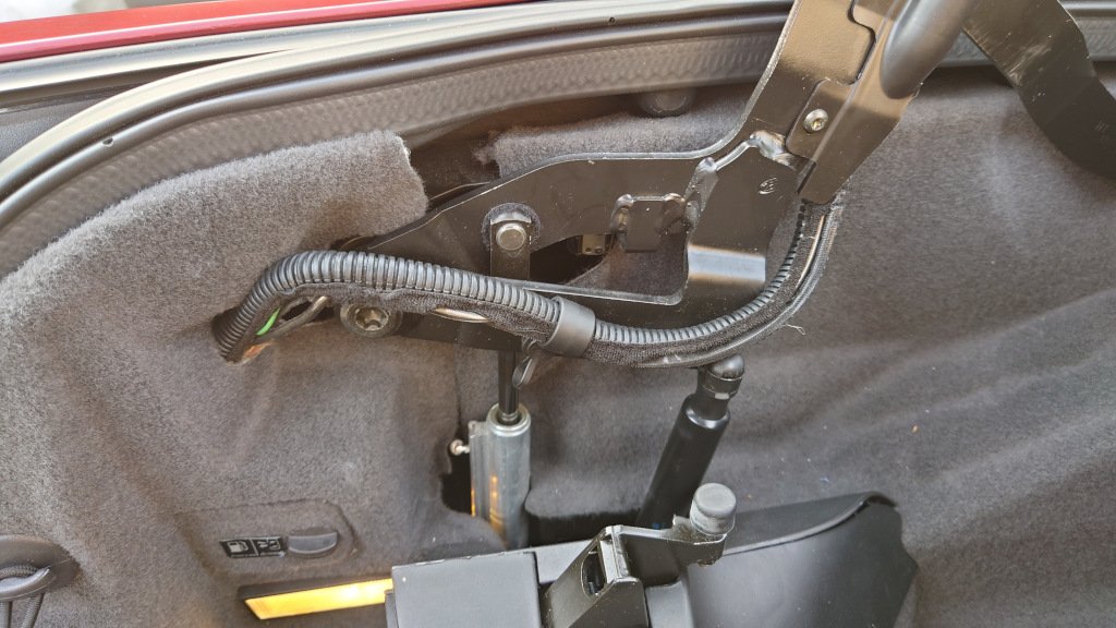

I ran the RCA-style video cable down the left side and tucked it into the existing wiring harness there. The camera is powered from the reverse lights (since they are right there... no need to have more wires).
I still need to paint the screws and tweak the angle of the mount a bit. It gives a good view. I'll have to take a picture of it working later.

If anyone is thinking about doing this yourself...
You'll need to buy new push pins for the trunk lid fabric and be careful when you remove it. The key fob antenna wires are glued to the fabric... you'll need to unplug them as you take the fabric panel off.
Be careful when you remove the plastic trim panels beside the seat. The rear vertical panel has clips that are glued on. You will probably need a strong epoxy to put at least one of them back on.
The door sill panel was the trickiest. You'll want to take your time and get plastic pry bars under it to work both sides of each clip. Otherwise, you could cause stress marks that will show.
The kick panel was easy and the under dash trim panel (with foot well light). The trunk carpet was easy too. Note the cargo net clips screw in/out.

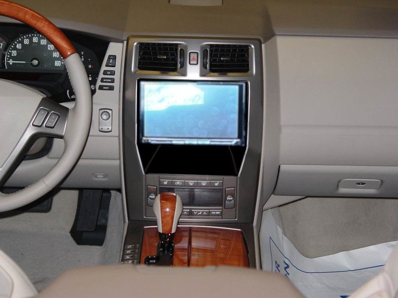

Nice job on this Camera.
What Stereo did you use, and how hard was that to get mounted?
Have any pictures of that?
Thanks,
CY
I'm not finished with the trim panel around the radio. I would have bought the Max Din, but I had an Alpine Z928HD from my old truck. It is an 8" screen with all of the bells and whistles.
Since I use an iPod and haven't used a CD in like 20 years... I put a single DIN pocket below the radio to hold my iPod and cell phone. I printed the pocket in PLA with Carbon Fiber using my 3D printer. Also, instead of using the Metra radio mount, which puts the radio way too low, I re-used the XLR radio mount to keep the radio at the original radio height.
Whenever my leather arrives, or I find another way to finish the trim panel, I'll post a better picture. Below is a digital mock-up picture.

Looks nice.
Did you cut the original trim pc for the angle toward the climate controls?
Just like most new stereo units, I don't see any knobs.
It is at least nice to have a volume knob.
Put a Jensen and Kenwood in some of my other vehicles, and they both had volume knobs.
Im working on one to mount the radio up higher inplace of the vents and move the vents down under the radio. Seems evety new car i drive is set up that way and i like the screen higher so i dont look down as much. Give me your opinion.. What kind of trunk button did you use?
Yes! Putting the navigation screen at the top is like most cars... at least, most cars that I like anyway. I'm curious how you would re-route the vents below the radio?
Yes, I cut the radio bezel to taper down below the radio to the climate controls. I was able to round the metal like it is around the radio. It isn't perfect, so I'm thinking about how to make it better.
