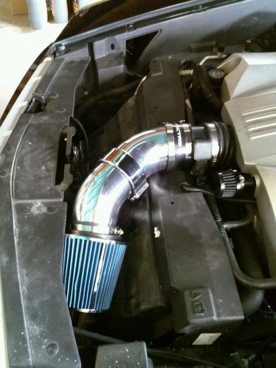

I built the cold air intake myself using 3 in Spectre parts. I checked everything for leaks and everything looks ok. I cleaned the MAF sensor and did find a small leaf in it. I am taking it to the dealer tomorrow to have it checked out using a tech2 and as soon as I find out how to have the ECM re flashed I plan to have that done next. I have only had my XLR for about 3 1/2 months so far and other than a few minor issues that need to be taken card of, my XLR has become one of my all time favorite cars.:cool:
Thanks for all your help.
That looks like a pretty small filter to replace the stock units.. Don't the after market units have a y and 2 filters?

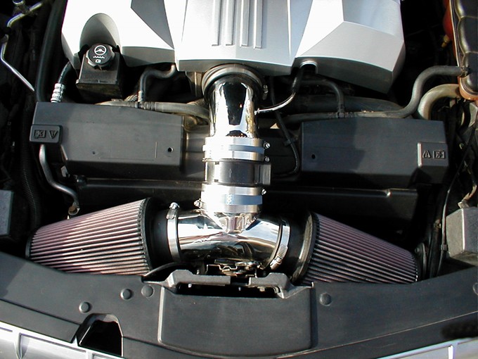

You could be reducing what the intake/MAF is expecting, causing the CEL to illuminate. The Volant air intake upgrade looks like this:
CCC :wave:
