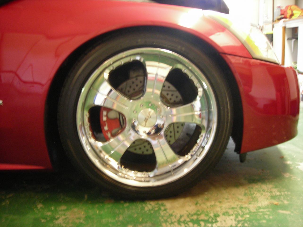

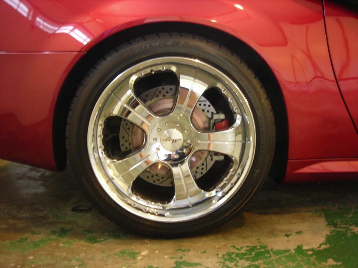

I have Maya 3 piece 20's on my car and, depending on the tires, it can be a problem. The 245-40 fronts barely clear, especially during a turn (thank god). The 275-35 rears rub the factory fenders, mostly outer, but some inner (so it's not just the offset). I had to lift the rear 1.2" in order to avoid 90% of the rubs I would get during compressions or speed bumps (especially with full fuel and passenger).
Here are some photos of the wheels, tires and clearances, for future reference to anyone who might consider going to a larger wheel/tire setup:
Fronts
Rear
