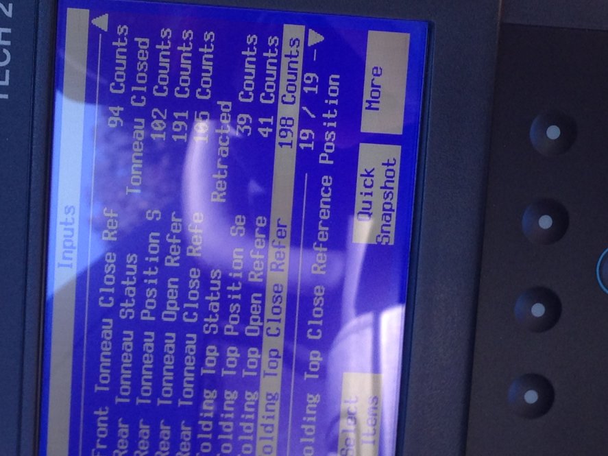

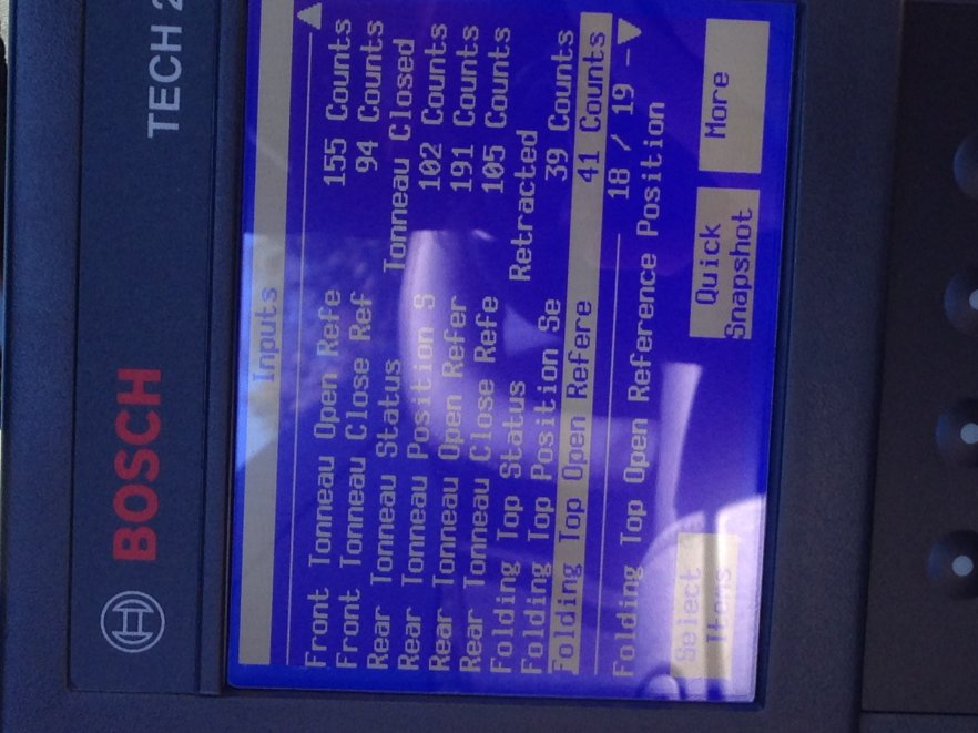

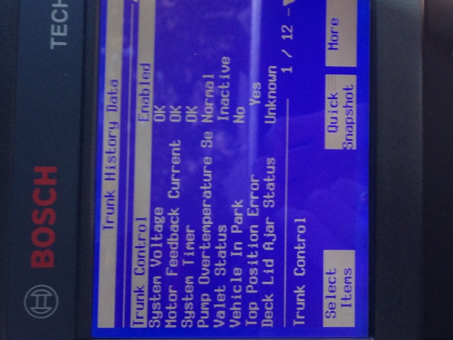

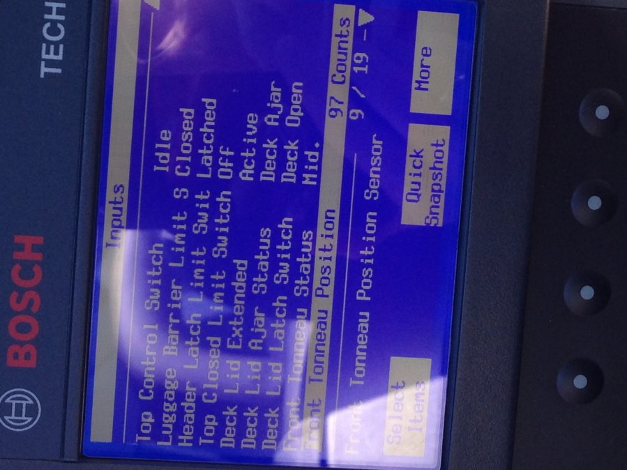

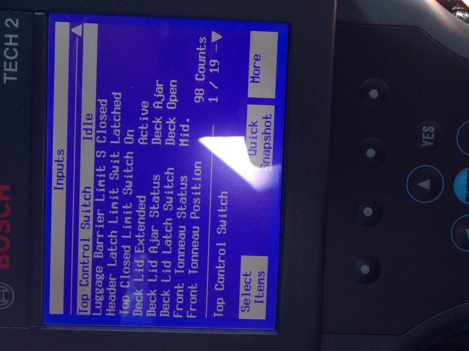

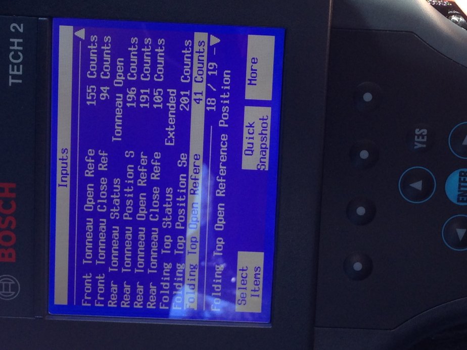

Rexter, you have the Tech II clone. Where on the scanner did you find the lists for the counts for the folding top? All I have seen is "learned". No manual makes it tough to find things. I have a list from Alldata that shows what the counts should be.
We took pictures after we got things fixed so we’d have a record of the correct counts. Hopefully they’ll load in order and you can see by the screen where we were in the program (as official photographer I wasn’t part of using the Tech 2 so I don’t personally know how we got there).
Also, sorry they loaded sideways. There’s one more picture of counts but I don’t think that’ll be very useful to you. I can only load 6 pictures.
