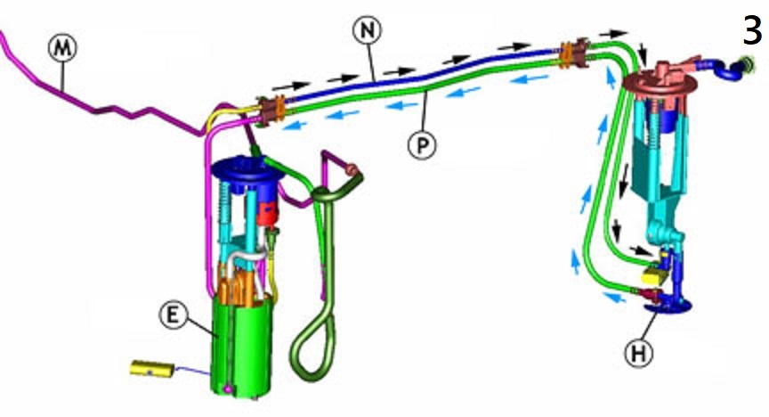

Fuel tanks
xlrist01
Actualy the passenger tank has also a siphon jet pump in order to balance the gas in both tanks
The main fuel pump for the motor is at the driver side.
When the driver gas tank is full, the level of the passenger tank is a bit less.
Enclosed is a drawing how the siphon pump works, the arrows are showing the fuel circulation in both tanks.
IAN :thumbsup

So the question is then, should we still lower the gas tank then at least half way or more to get gas additives mixed though both tanks? Or does this jet pump circulate fast enough to mix it up in both tanks?
Thanks
Caddy Dan using Tapatalk

Fuel tanks
05 GRAND DADDY.
There is a regulator in each tank to stabilise the gas level of both tanks, i presumed that the car buider have figured out the sise of the siphon pump for the need of the system.
Re the guide line of the product.... it would be wise to read the recommendations on how to used it, many similars products could have different guide lines.
Clug injectors meams clug of the fuel pump, its filter and the regulators in the tanks and could not supply the needs to the motor, the idle of it could be affected and running rought.
